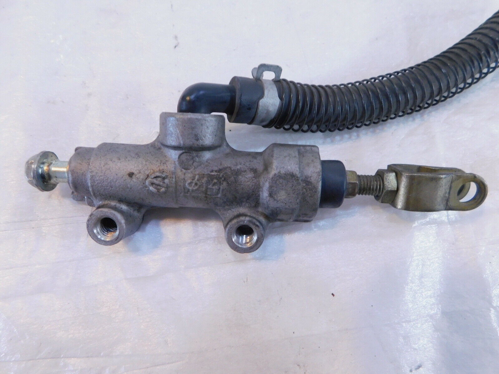

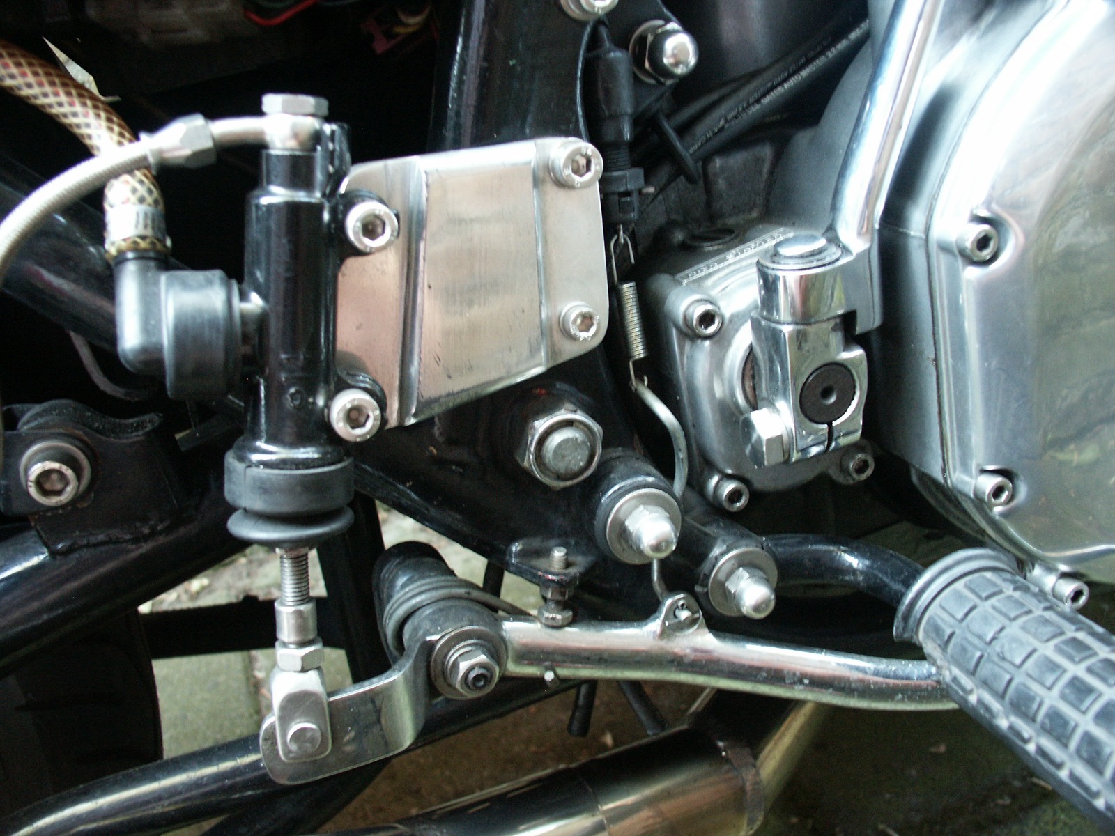

From the bold spacing the 94-97 ZX9-R MC should fit (you need the special mounting bolts also).
I had to fab a adapter plate (rear drum break model) and use a clear tube as a break fluid reservoir.

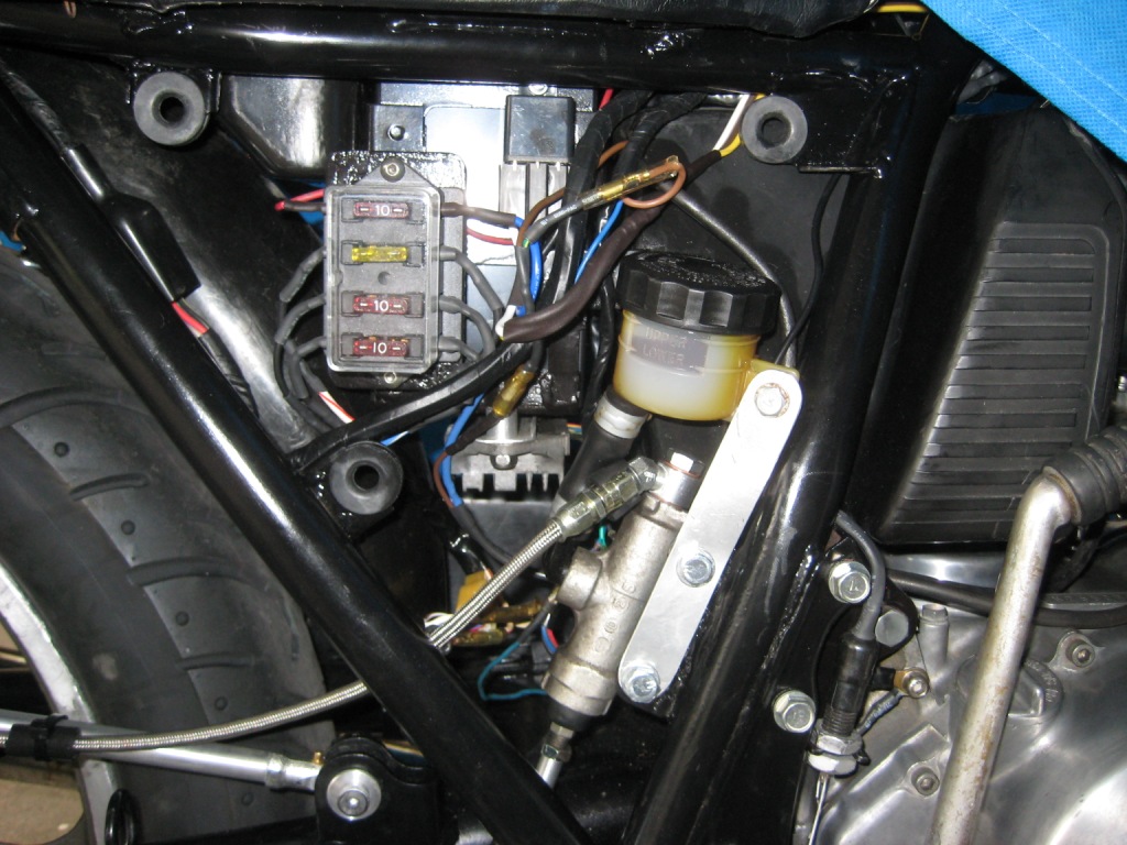

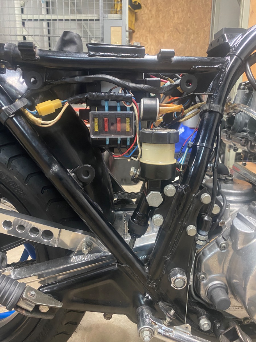

On my 650 I am using a Vulcan 1600 rear master. You need to make sure the casting is marked 14MM. It fits the stock frame tab C-C for the bolts, even takes the same bolts.
The cup is separate so you can move it anywhere you need to, it fits under the side cover with no issues. I ended up moving the cup bracket behind the tab, the bracket is 1/16" 6061.
If your buying a used Kawasaki master off Ebay make sure its "wet", sometimes you don't even need to rebuild them. At least with 2000's Kawasaki you can still seal kits.
The only issue with this is it does not look stock to people that know what there looking at. The side cover goes down to the top mount bolt so you can see everything below that. If your bike is completely stock or a restoration this might not work for you.

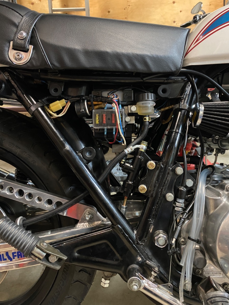

Do you have any pictures of how you made the push rod work? I got a new master and it has a 1/4” threaded push rod, which I need to somehow adapt onto the old larger thread rod size. Thanks!

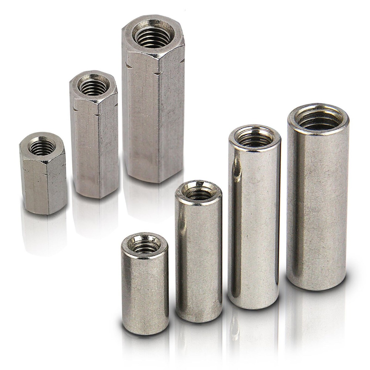

You can couple the stock push rod end via a M8 threaded socket onto the Nissen push rod.

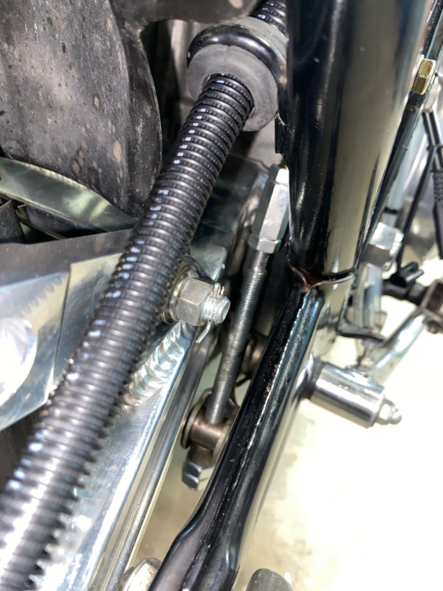

Just for future reference, I was able to make a new style master work! Had to make a push rod out of 10mm threaded rod, turned it down to 8mm to adapt to the master push rod. Thanks guys for the direction!

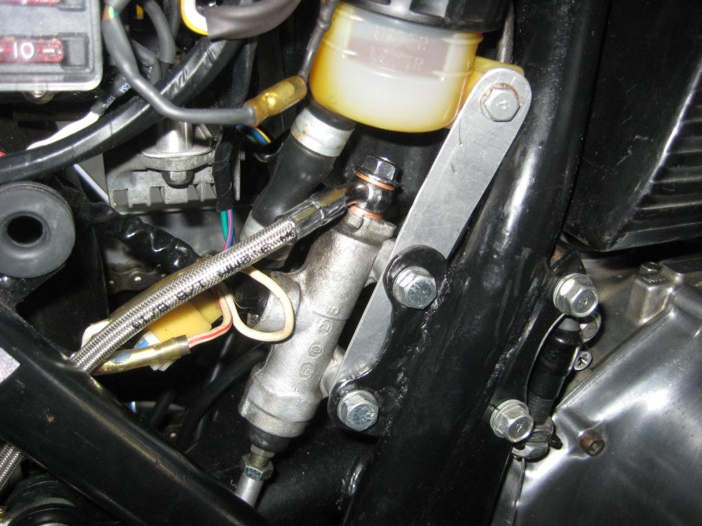

I don't have any better pics but in the one I posted you can see a solid 6061 rod where the M8 stud is threaded in, its just a extension to push on. Pretty easy to pull off as you found out either with a machined piece or fasteners.
