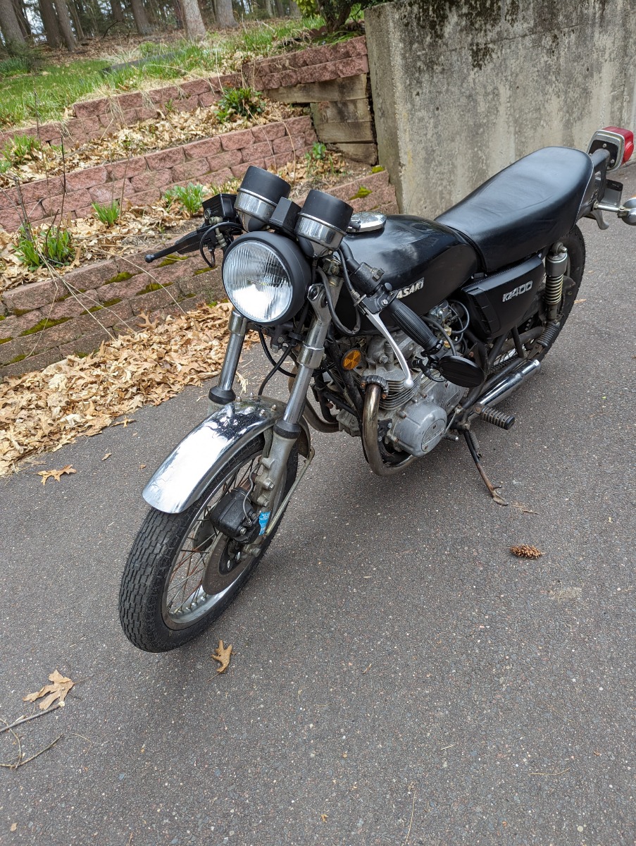

I've only had it a couple of months and have maybe 200 miles on it but other than the throttle having a little 'space' before it'll give you gas, which makes parking lot maneuvers a little harder than they should be, it's run as well as I'd expect. Got it as a running/rougher bike which is fine cause it's my first and I wanted someone like that to learn on anyway.

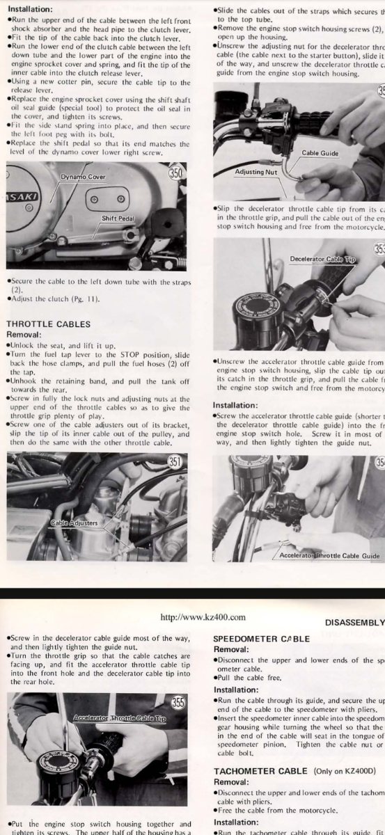

Thanks and ya I downloaded the one posted earlier in the thread but didn't see anything that detailed but will check again.

Doesn't show the part where the ends of the throttle cables clip in unfortunately, and obviously won't address having one missing for some reason but any idea which of the two I should be using with the single cable I've got?

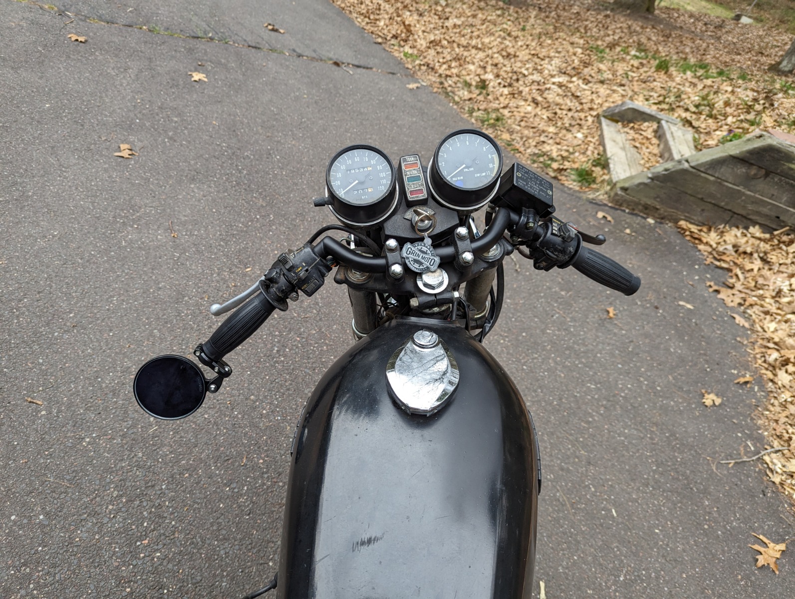

Ok, measured 6.25" from the end of the bar, added some tape and pushed the pin into it once it was in place to make a mark, got it punched, drilled a pilot hole and then a matching 3/16" hole like the stock bars had. All mounted up and had the throttle going crazy after kicking the start a million times. Turns out it was just giving it all the gas. Took it back apart, moved the throttle end piece to the second slot and it's working as it did, will say it doesn't pull back to 'off' throttle as quickly but hopefully that'll fix itself.
Really happy with how the bars look, though I think they're off center by a tiny bit, will have to see if I can sort that out.

Lots of slop in the throttle before the engine revs up and slowly returns to idle are signs of problems. A throttle cable on the verge of failure could cause both. There could be other causes, but considering the rest of the bike, I’ll bet on this one.
The closing cable is not strictly necessary if everything else works perfectly, but the the possibility of having the throttle stuck wide open in traffic seems like enough reason to spend a few dollars on new cables.

Ya it's going on the list, already had to replace the tach cable as it felt off and then fell apart. The remaining throttle cable does look a little spicy at the connection point so I was going to just see about lubing it but probably better of just replacing it.
