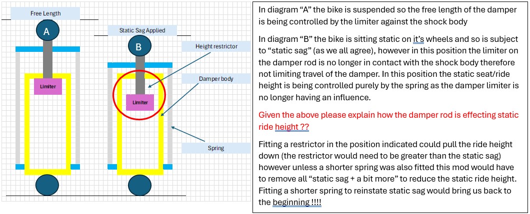

24 Mar 2024 13:08 - 24 Mar 2024 13:26Adjusters on top of the spring alter pre-load, adjuster below the spring alter "ride height" unless you wind it up so far it removes static sag, then it will start to increase pre-loadDamper rod dictates seat height. Thats why when you lower suspension its done internally, not with the spring. Those "spring adjusters" only change the preload, not the height or the spring rate.
OP could have just bought a set of those lowering brackets for the lower shock mount.
Last edit: 24 Mar 2024 13:26 by Wookie58.
- Posts: 6941
- Thanks: 4358
Re: Rear shocks
24 Mar 2024 13:15Happy to debate the original point which was "what controls ride height" but not interested in getting into a "pissing contest" about who has the most experience !Spring preload will change the static sag. Changing the spring will alter the rider sag. Doesnt matter what preload you have, the shock will compress the same with the same spring. That is why you shorten shocks internally.
I've been modding both vintage bike and modern MX suspension for over 10 years.
Maybe I haven't made myself clear regarding this topic, hopefully the below diagram and the Maxton link I provided will clarify (Maxton talk about lifting the bike until the shock "tops out" which is when the damper limiter comes into effect) I am happy to be educated if you can give a rational explanation to the question in red text

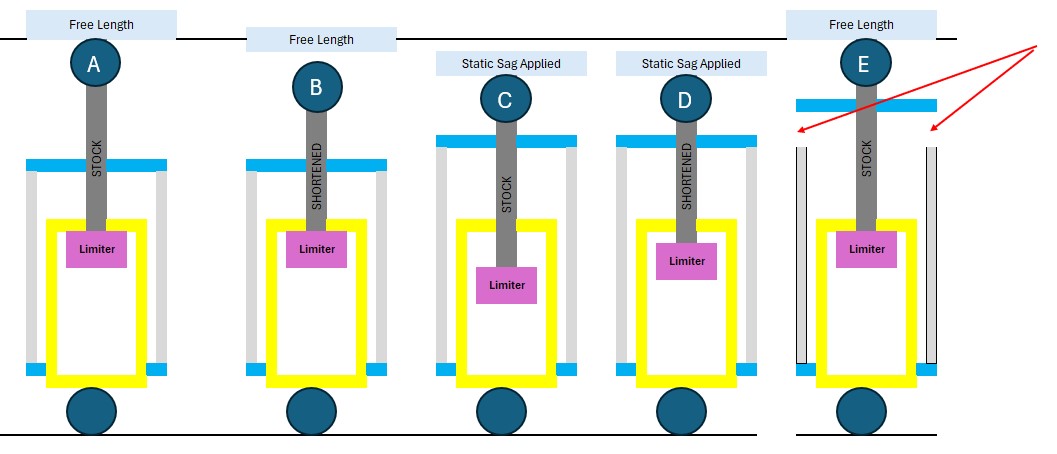

25 Mar 2024 12:19 - 25 Mar 2024 12:22OK so you need to bear with me on this as I get a bit OCD around understanding things !! I get what you are saying so I guess the first thing isTake a 12" shock, with the preload set so static sag is 2".
Shorten the damper rod so the shock is now 10" full extension. Adjust the preload as before the shock will have the same 2" static sag.
Both shocks, same weight applied, same spring rate. Preload adjusted for the new damper length.
Do you agree once static sag is set that the limiter on the damper rod is no longer effecting the rest position (height) but that it is the stored energy in the spring that is determining this ?
therefore if you wound off the pre-load adjuster to the same position on the shock body of the standard damper the rest positing determined by the stored energy would be the same but the static sag would be excessive ?
That being the case surely the purpose of shortening the damper rod is so that at full extension with the pre-load adjuster in this raised position that the spring doesn't become dislodged as it would no longer be in contact with the adjuster ?
It kind of all comes back to "the spring determines the rest position"
