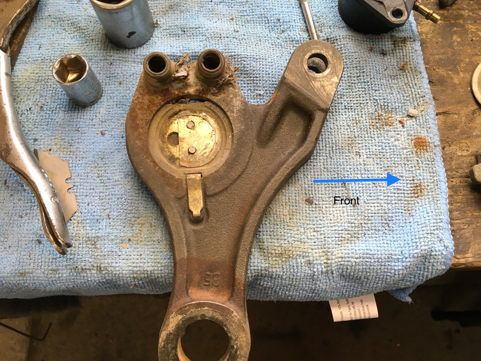

It’s basically a front rotor mounted in the rear. The inner pad is captured into the caliper via a screw through a disc into the steel backer of the pad. The outer pad floats inside the caliper bracket. Before removing the rear wheel reach through the spokes and break the Philips screw loose. Remove the wheel. Remove the Philips screw and disc completely. Push the caliper in (toward chain) it will slide on the caliper bolts and you will have room to remove the inner pad. Then the outer pad should have room to be slide away from the piston, out of the caliper bracket and become free of the bracket. If the caliper won’t slide on the slider bolts then it will need to be disassembled and serviced.

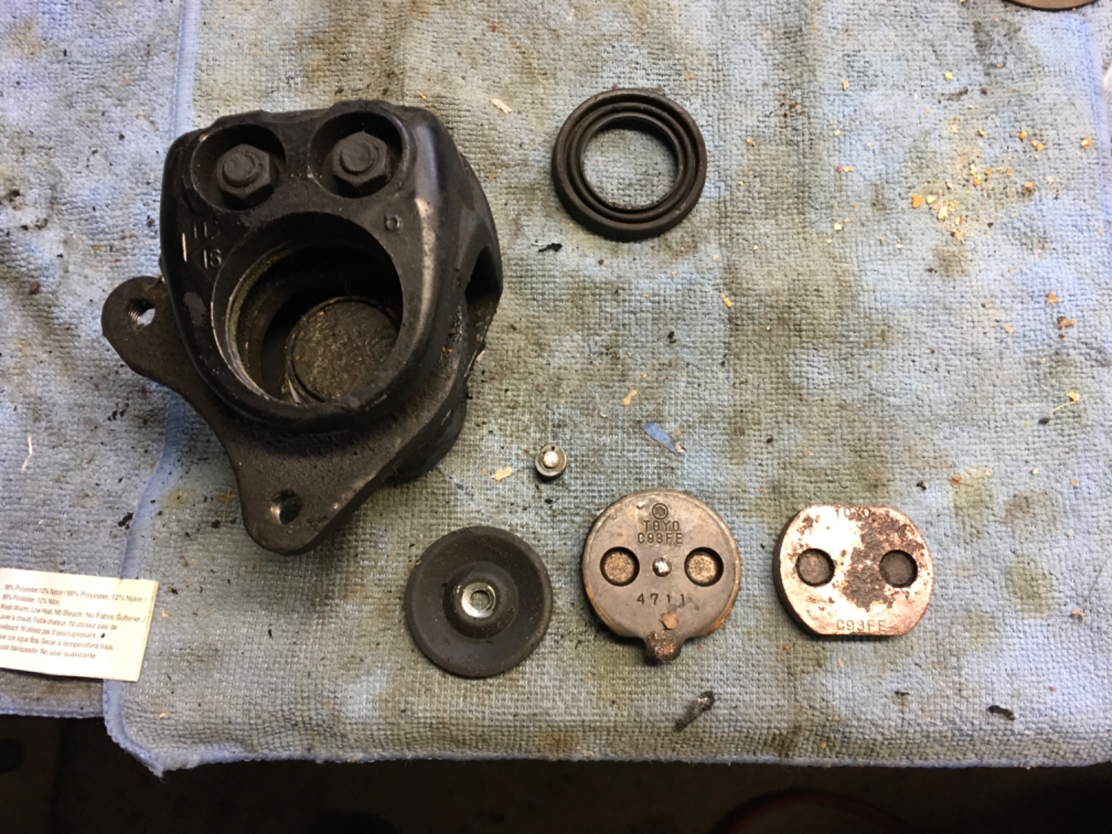

12 Feb 2024 16:03 - 12 Feb 2024 16:04
Here is the inner pad. The tab indexes into a slot in the caliper. First photo shows the disc and screw (broken) that retained the inner pad. Second photo shows pad installed into restored caliper front (rear 77-78 LTD is similar)
