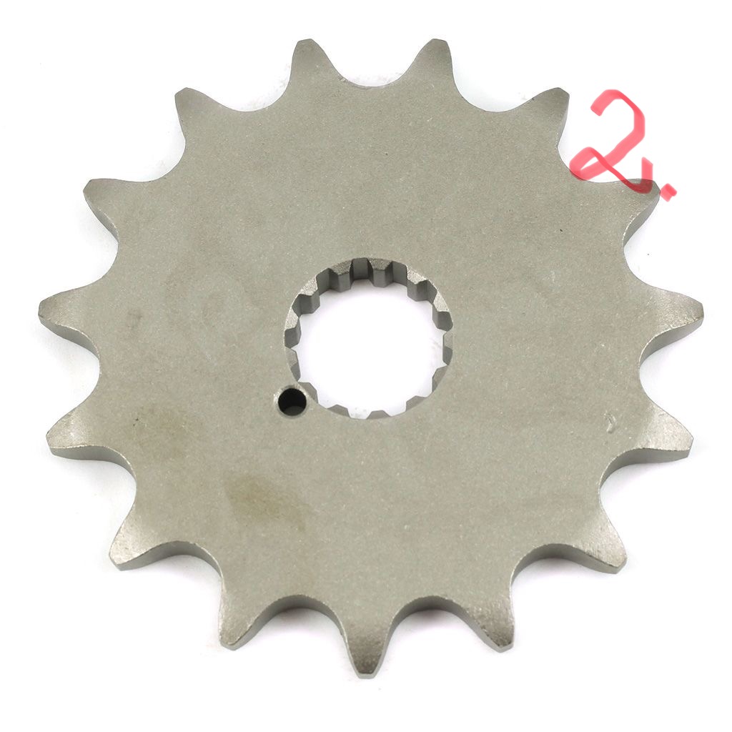

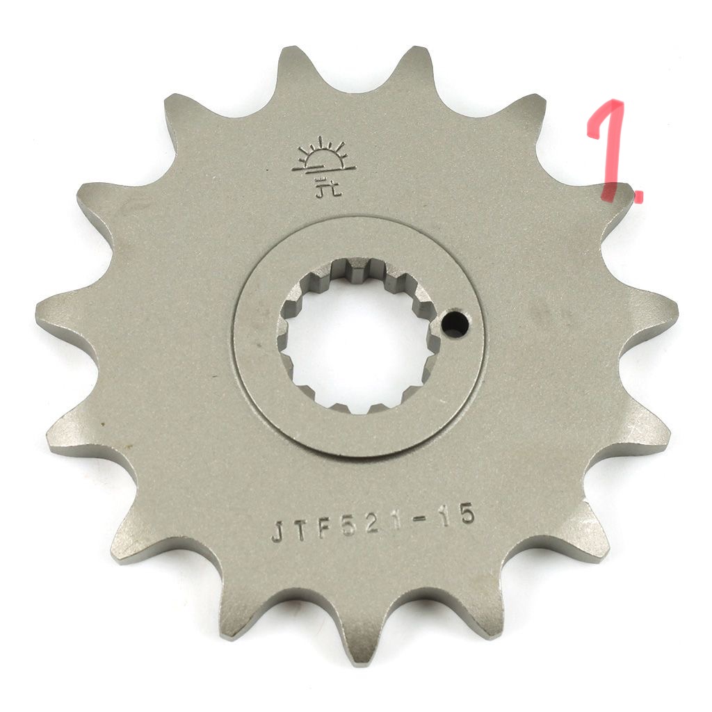

With new sprocket and o-ring chain, which way should the front sprocket be mounted?? Picture 1 or 2 should go towards the engine...

The shoulder ( pic 1 ) goes on the inside to space the wider o ring chain away from the engine cases.

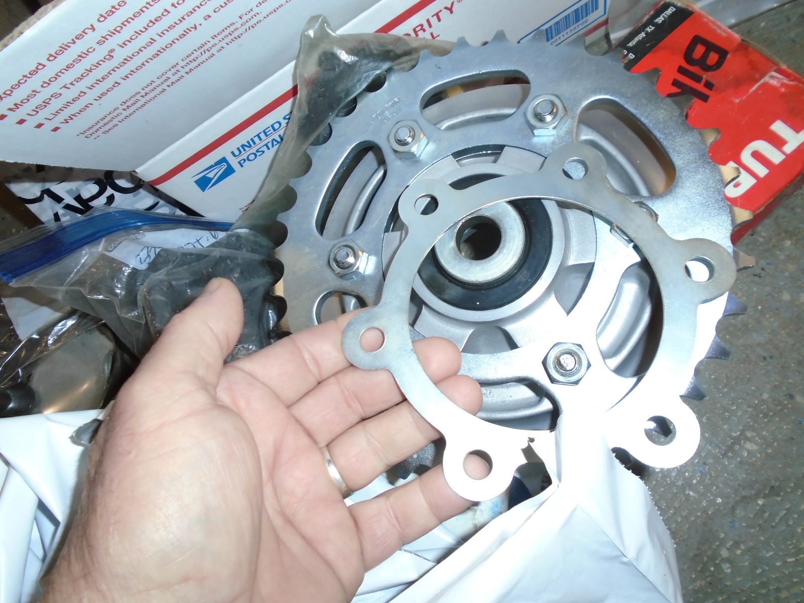

Maybe it'll help? Pic of that 1.5mm rear sprocket spacer sf4t7 mentioned.

Thanks asphalt900, pic of mine wouldn't do any good it's already installed
