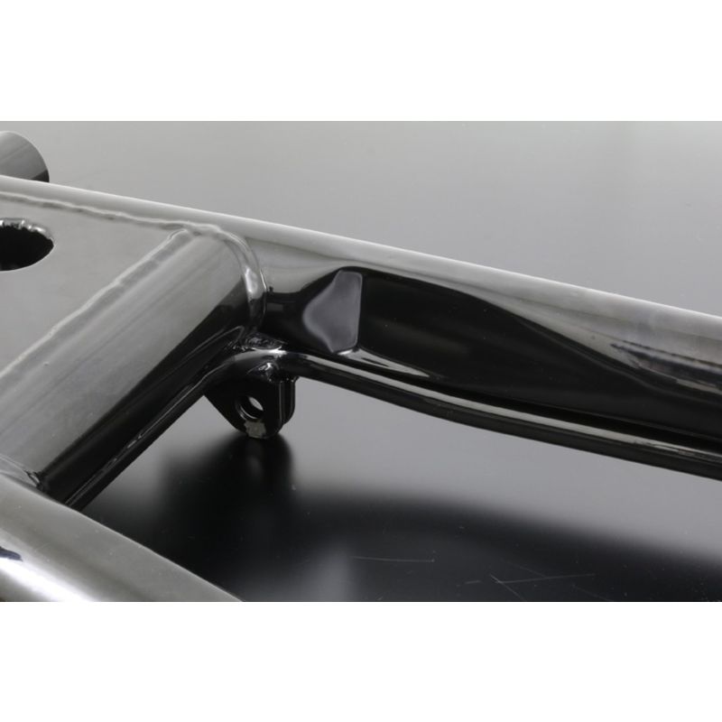

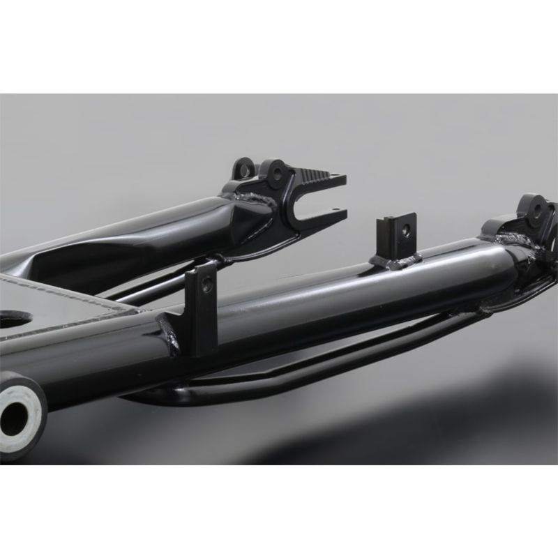

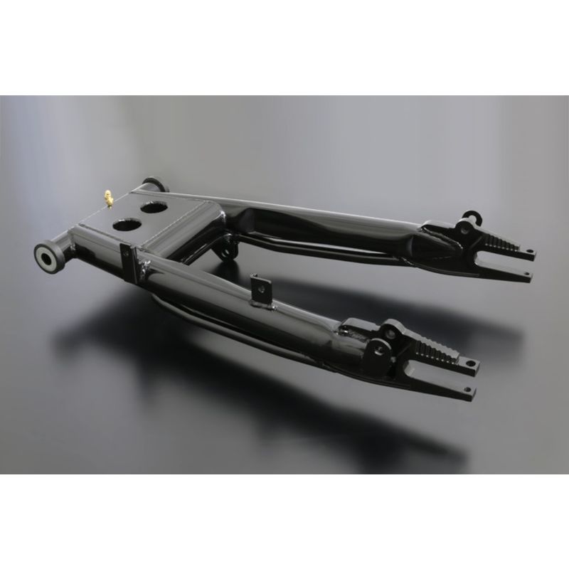

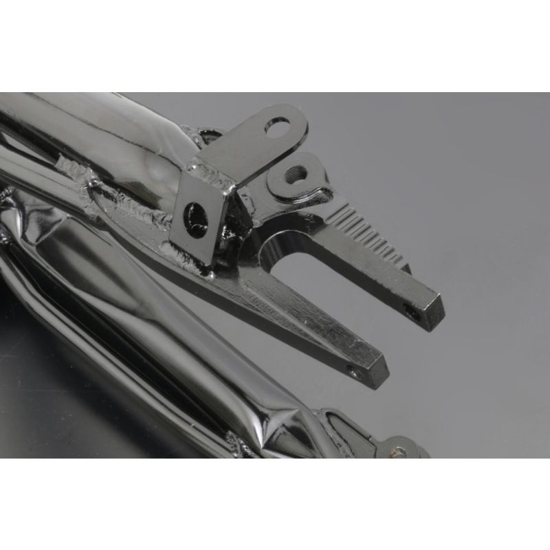

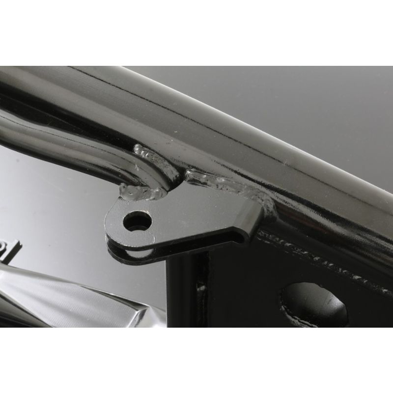

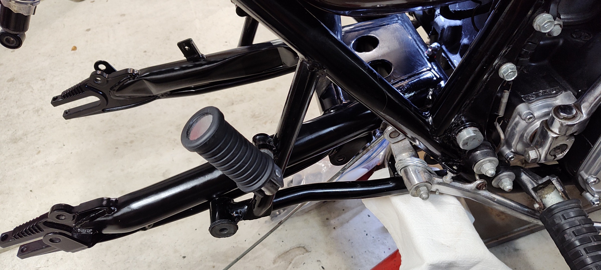

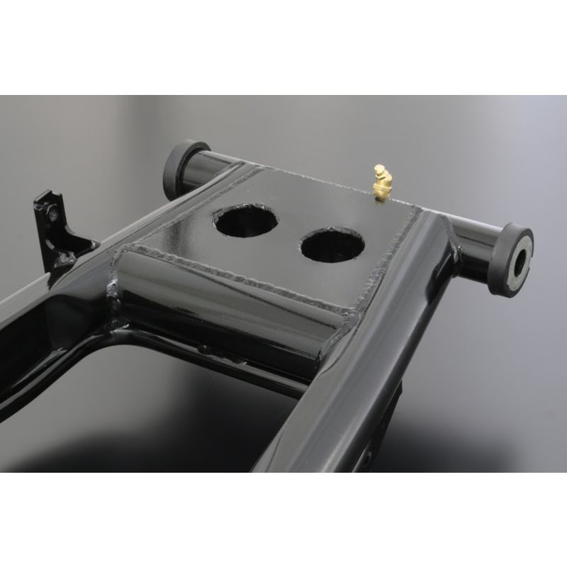

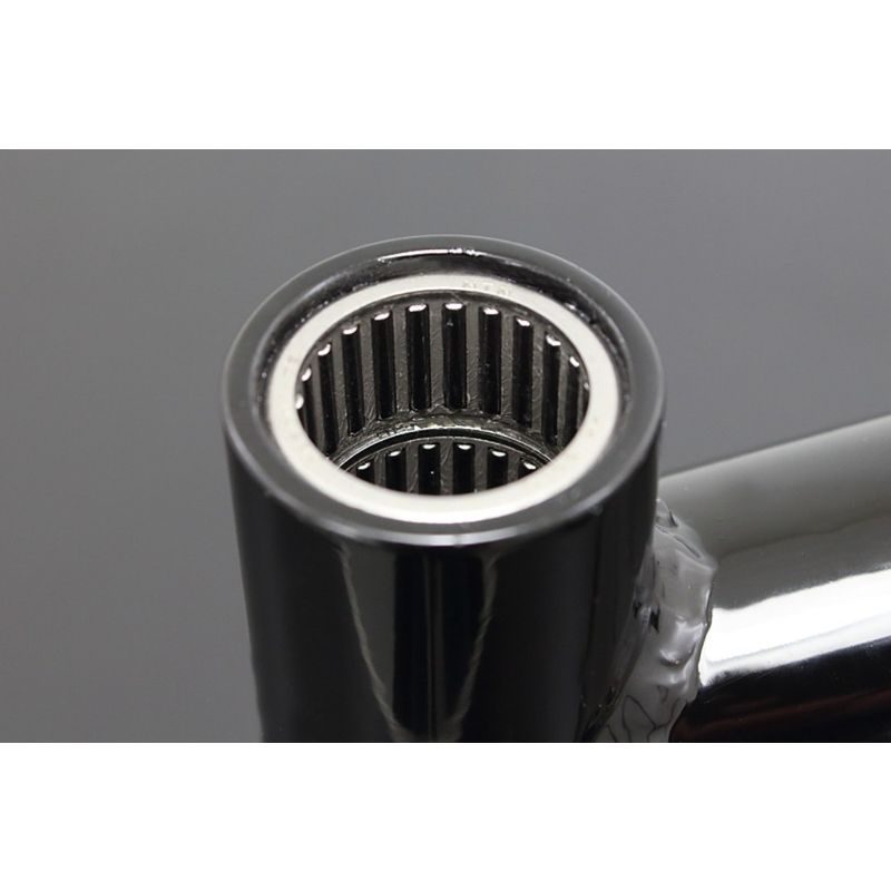

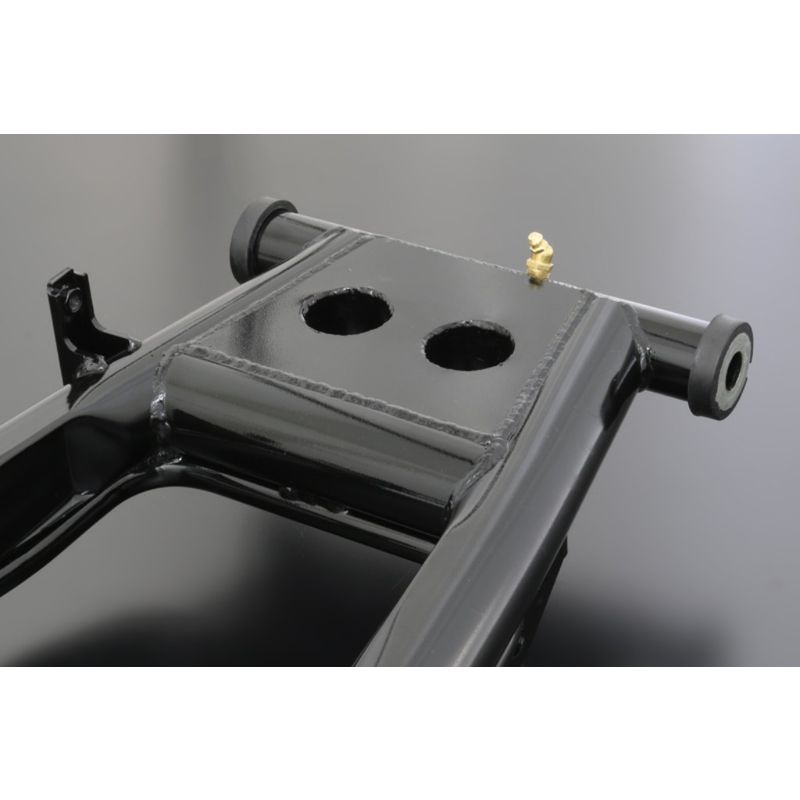

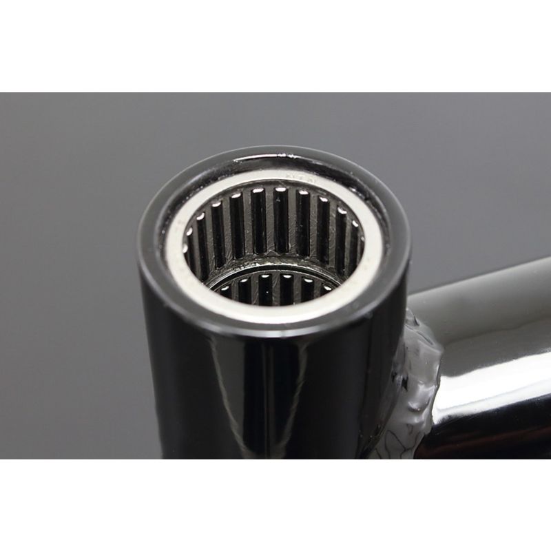

If you decide to go with a wider rim and tire, this is what I did. Sometime in the past my friend installed a wider aluminum rim and installed a 140 tire. In order to make it work, they installed a 96 link chain to pull the tire back far enough to clear the inside of the swingarm (it had about a half a mm clearance on each side). So I found a replacement that appears original at first glance but is greatly reinforced. Now I can go up to a 160 tire if I want to. Also, the brake torque bar doesn't need to be modified to fit. Good luck!
japan.webike.net/products/23905135.html
