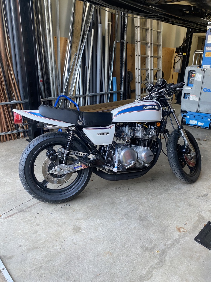

Hi Guys, I have a KZ650 which I have aftermarket wheels and a 110/80-18 front tire. Is there another KZ model which front fender would fit on this width? I like the style of the KZ1000LTD front fender, but can't find the actual width. If anyone knows the width or something that would fit that tire that would be great! Thanks.

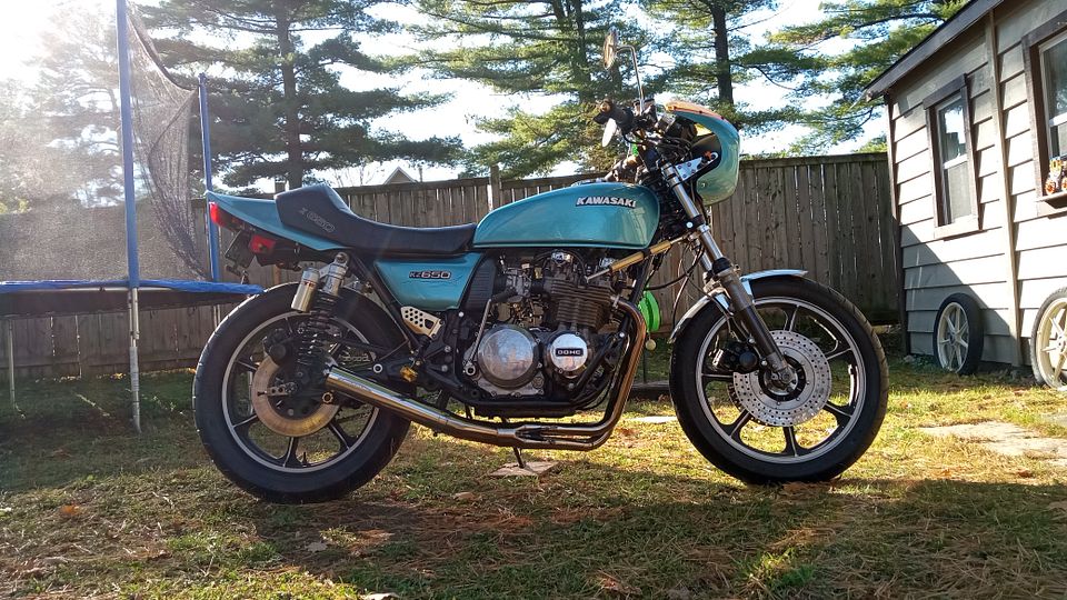

I'm using one of these front fenders on my 650 with an 18" Z1R front wheel:
The edges/sides don't roll down much like stock fenders. More of a flat fender.
