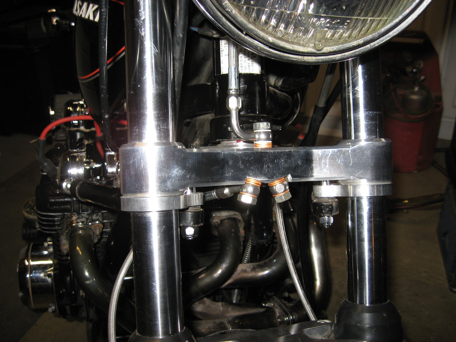

Copper washers are the way. to go.
You can even stack them like I had to so the rigid brake fittings cleared my custom triple trees.
They don't leak at all , before that gets asked..
