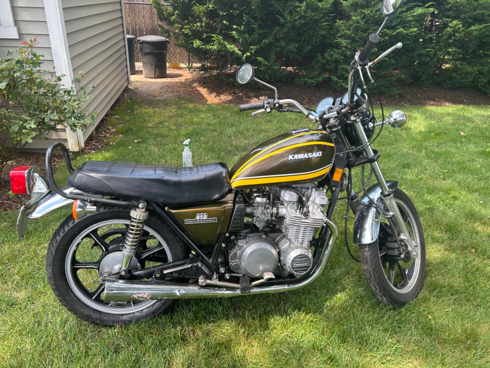

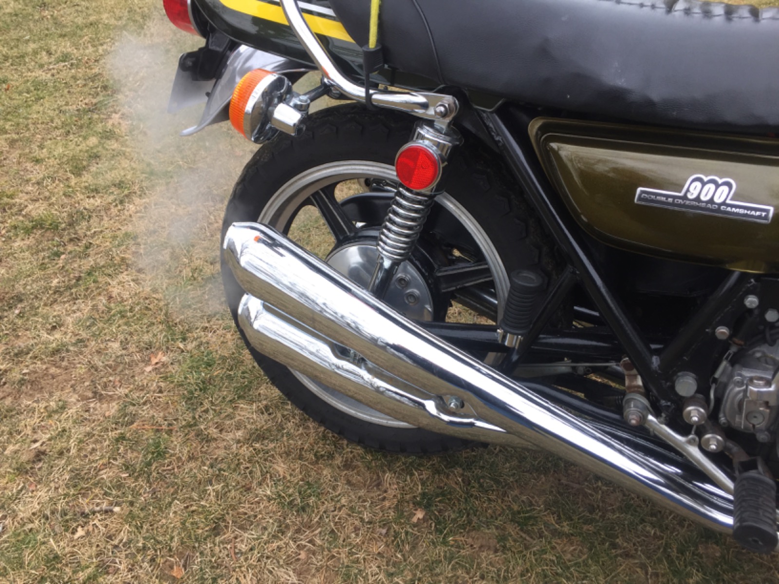

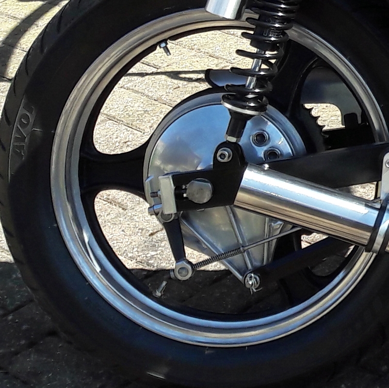

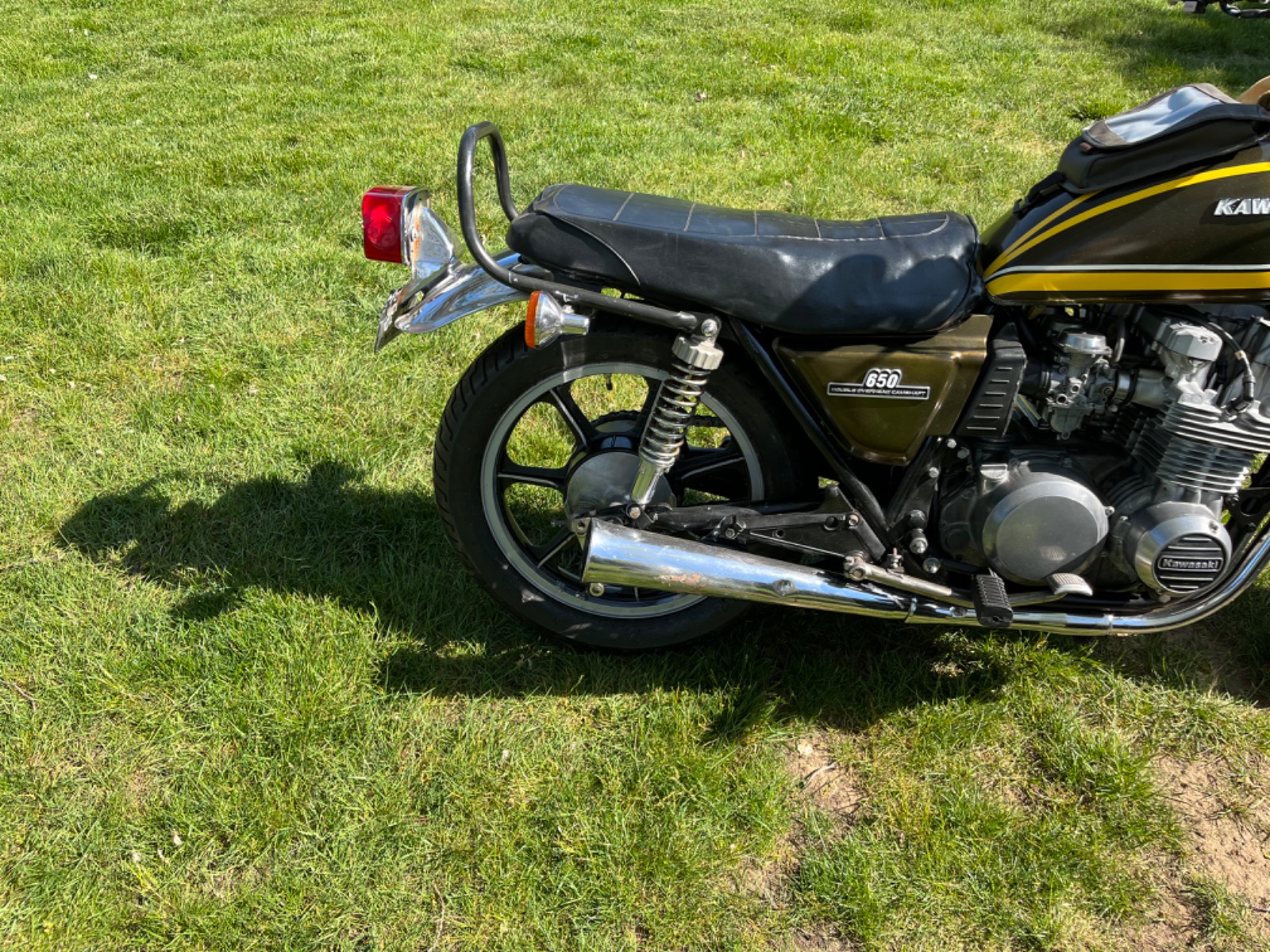

Re: Mag wheel for a Z1
13 Nov 2023 14:20
#891672
Hi, First pic 74 z1 w/ Lester cast wheels, bought in 76/77, drum brake, second and 3rd, 81 650 with Enkei cast wheels, sourced fro ebay, rear had a 16, but found a 18, looked for about 2 years, from 650 F model, sold in 80 to 83, and I think only in Europe, Lesters are around but very pricey now, hard to find in US, located in Germany (global moto)605 wheel has smaller brake and axle
