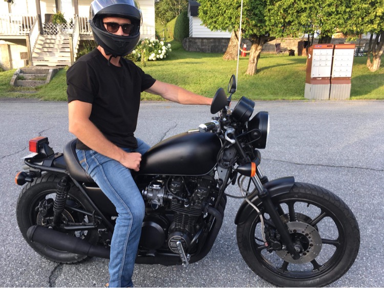

Hello, my project is almost finish.. I have a leaking front fork seal .. ordered a seal kit. Now Im looking to having a better “suspension resistance “ that I had last summer.. do I need To replace the springs?! More oil?! Thanks for your help!!
Kz750e 1980
