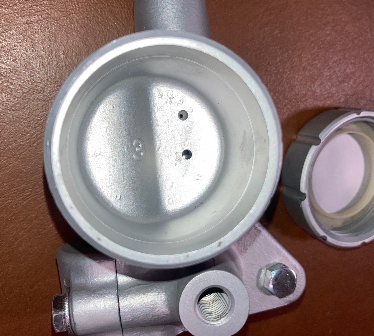

Hi All, Recently I've been selling a small amount of real nice parts on eBay & FB Market.
I had a 75 Z1B front caliper with master cylinder, That sat since the mid 1980's?? I listed for $250 on ebay, and $200 off with private PP sale.
Some people laughed on FB, whatever? I wonder how many of you and others have bought brake item's, calipers & master cylinders to find out it's trash, pitted, no good.
So I de-listed these items!
Glad I did! Now I am going to restore them both with quality parts.

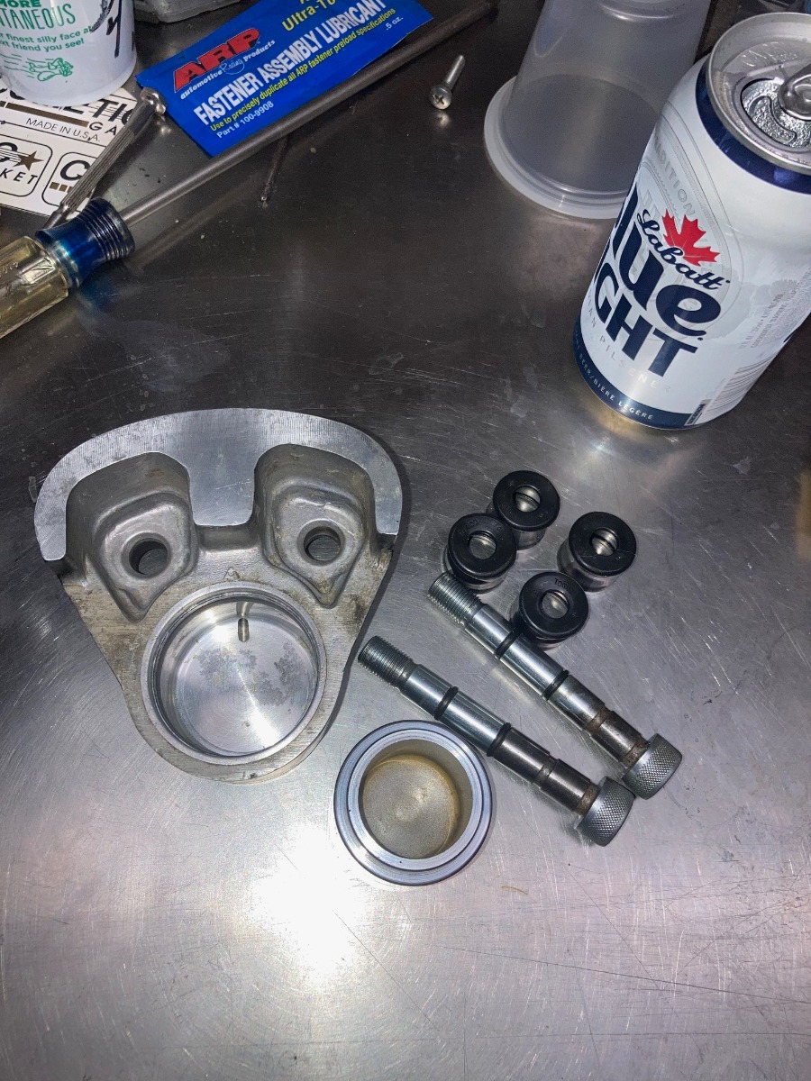

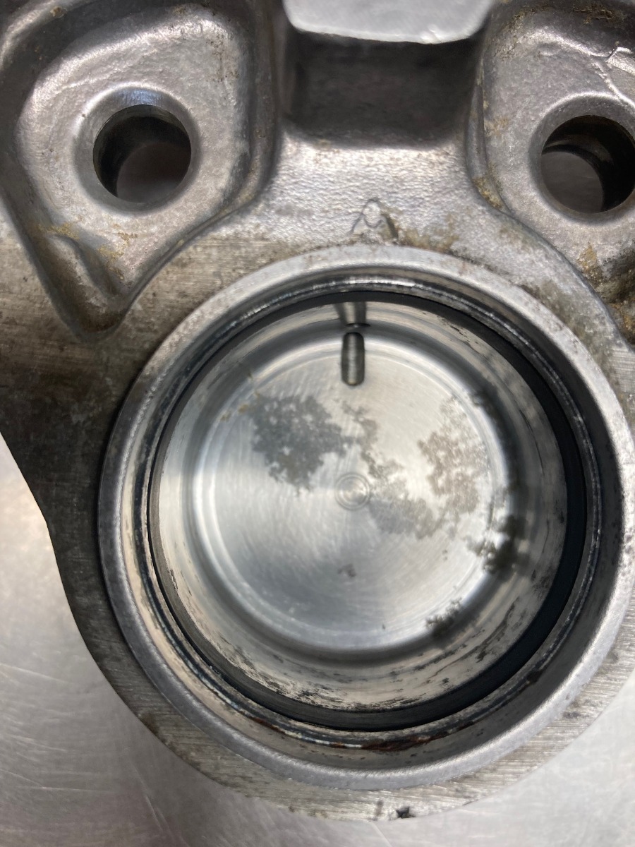

This caliper was so nice and clean! The piston popped right out effortlessly!

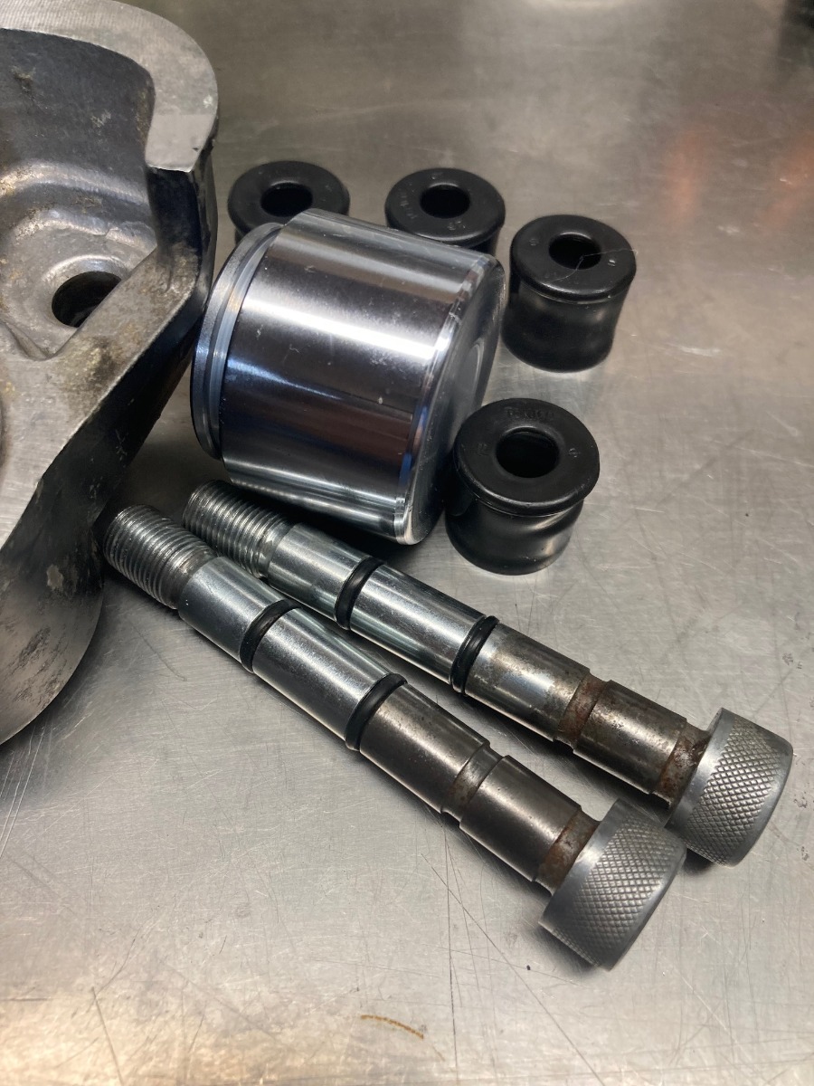

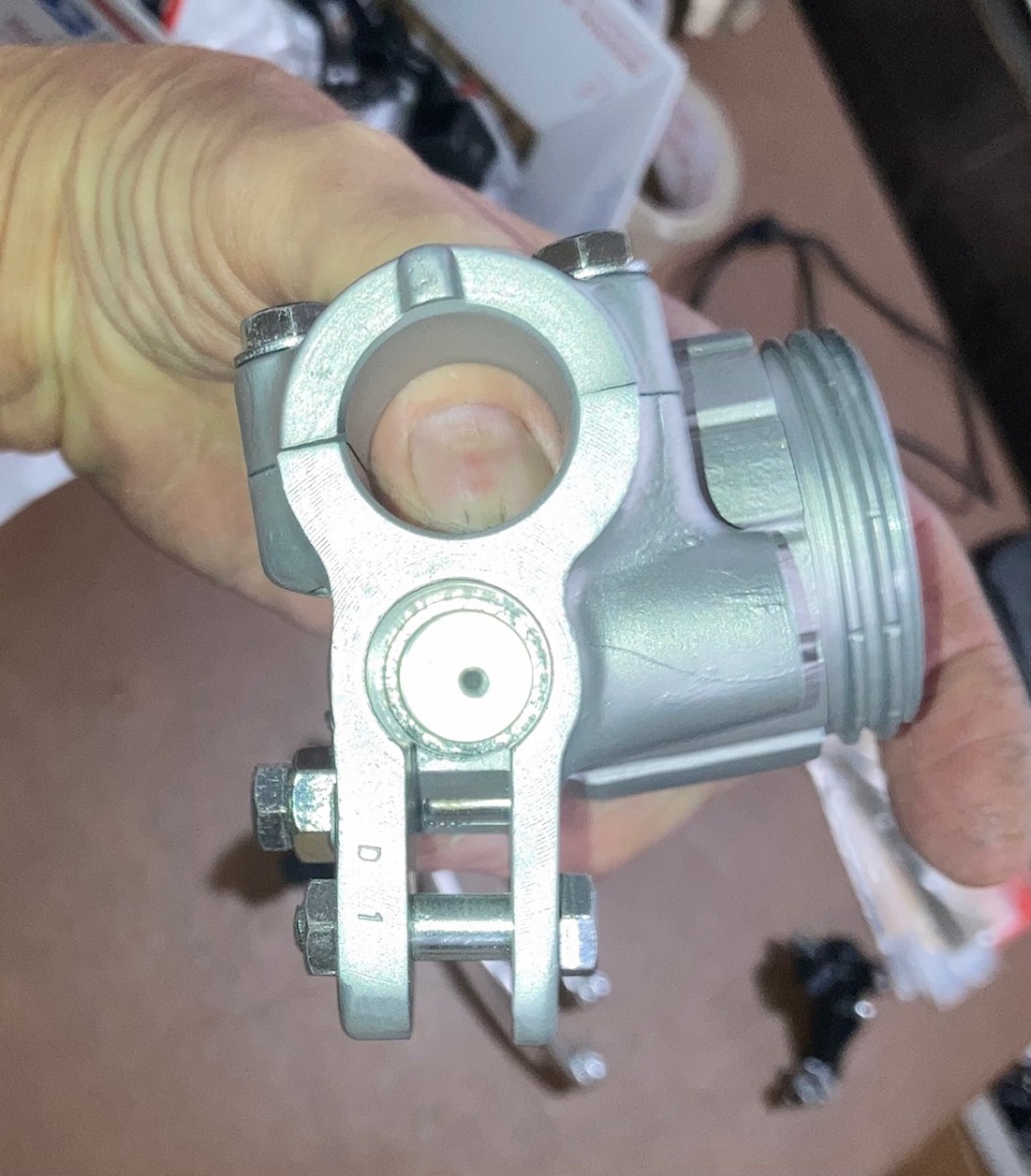

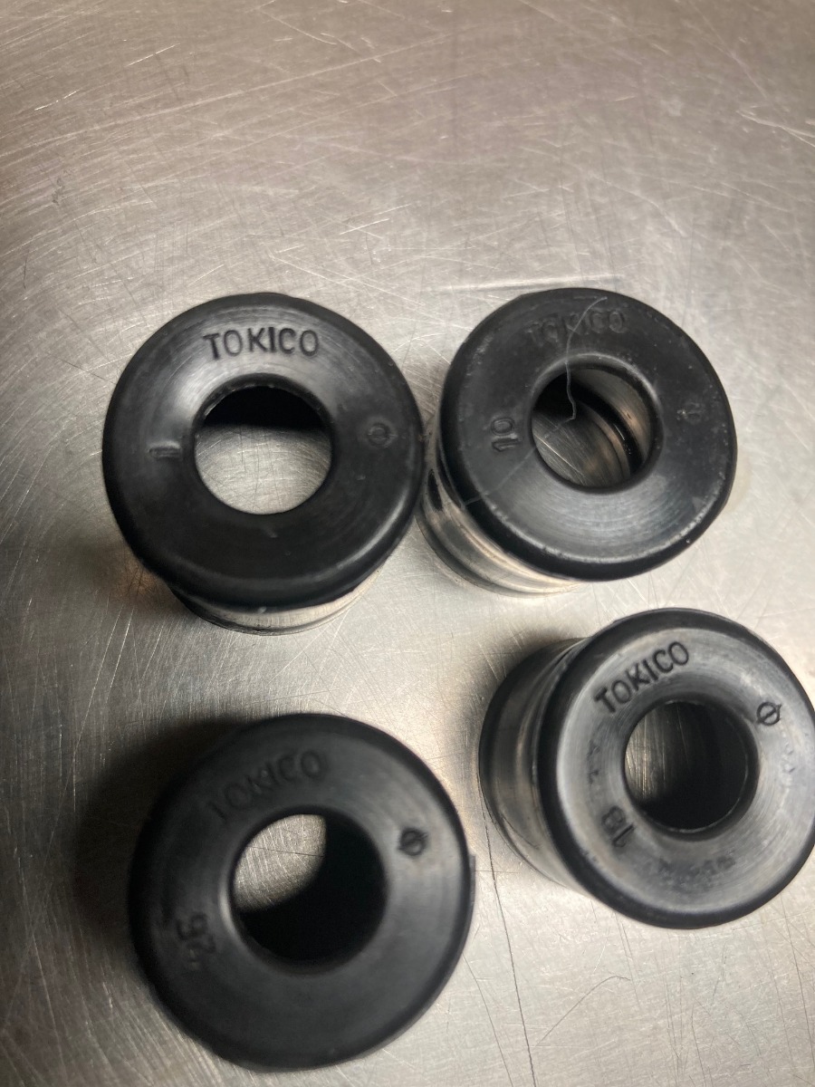

Piston is like new, the 2 bolts are clean to go, the 4 seals are original with Tokico on them, the master bore has no pits!
Cleanest old items that I have ever taken apart over the years! And I took a lot of the apart too!
Now I am just deciding on how to finish them? I might try black anodizing? The caliper too?
Has anyone ever anodized a caliper housing?
Or just good old Satin high temp Engine Paint, baked and cured?
Check out these pictures! As just taken apart!

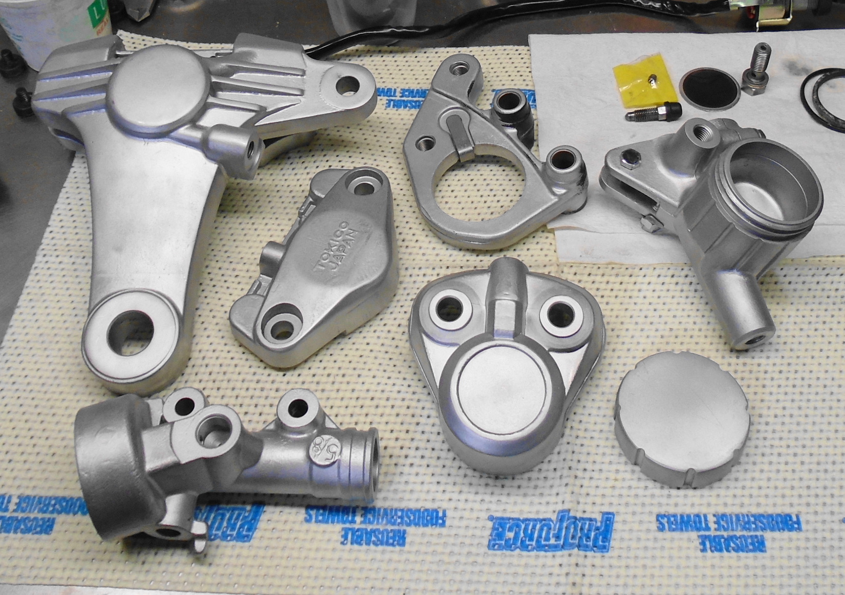

HI Wookie! You Know? I am going to try it! 4 oz. bottle ready to spray, $45 on eBay.
Just need a small .8 - 1.0 needle for my clear spray gun.
Should have done this years ago! Made a Business out of it! That's all that race Car Jet-Hot Coating stuff is are!
I am going to talk to my Son, New Business for motorcycle and small car parts!
He has become quite the painter!
The place he paints for did a car for the Street Outlaws show. Guy out on Connecicut?
Only place's around me are Gun-Smith shops that actually do it!
OK, hopefully these 4 oz's will do it?
Now? oven cure? air cure? cobra black? artic black? jet black? WTF? black?
Calling them to see what a basic satin black would be called.
Thanks Wookie for getting me thinking again!

Here are my parts in queue!
The Z1 parts & a 77-80 rear set
