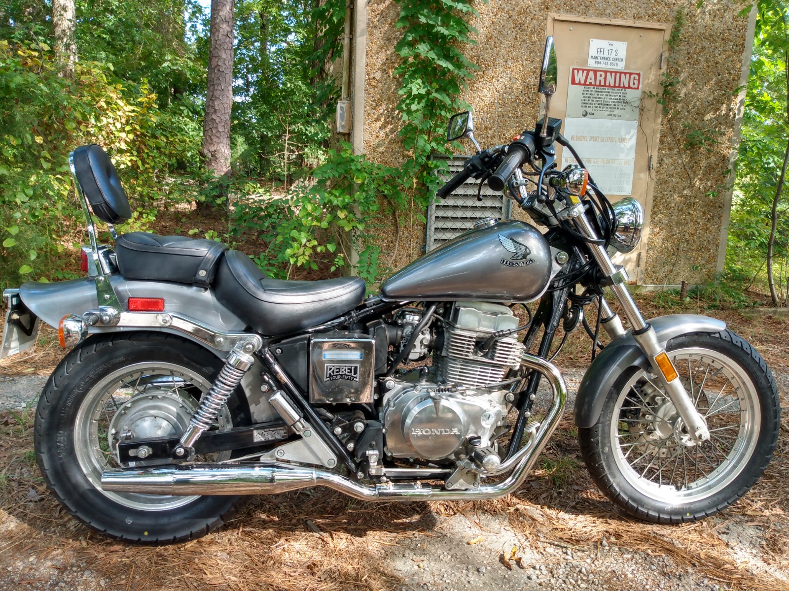

I like the looks of spoked rims, but don't want to use inner tubes. A 450 Rebel I had a few years ago had tubeless spoked rims. Do any other bikes have this?
