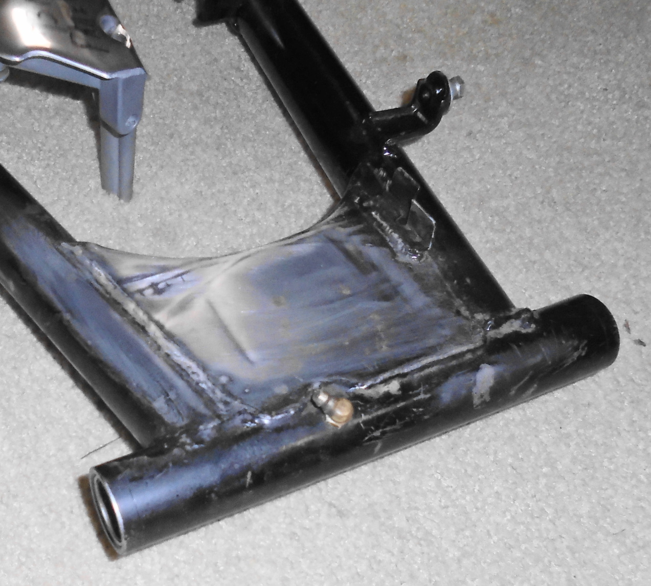

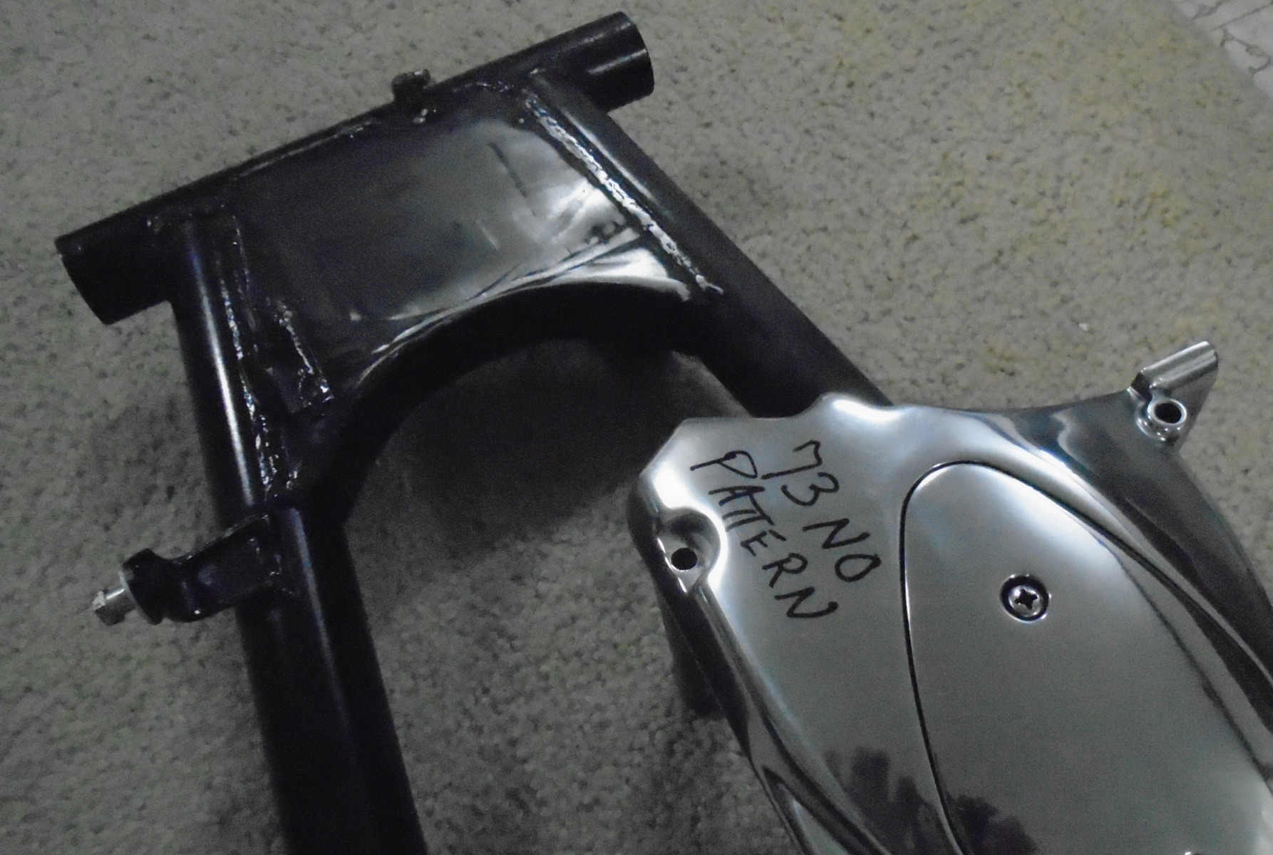

I Think I have a similar situation? This one I have is pretty crudely built! The production stamping marks on top were the date codes ugly, marks, lines from presses? I don't know?
There is no date code stamping. Also have a no shift pattern sprocket / chain cover. The inner chain oiler pump scored the inside

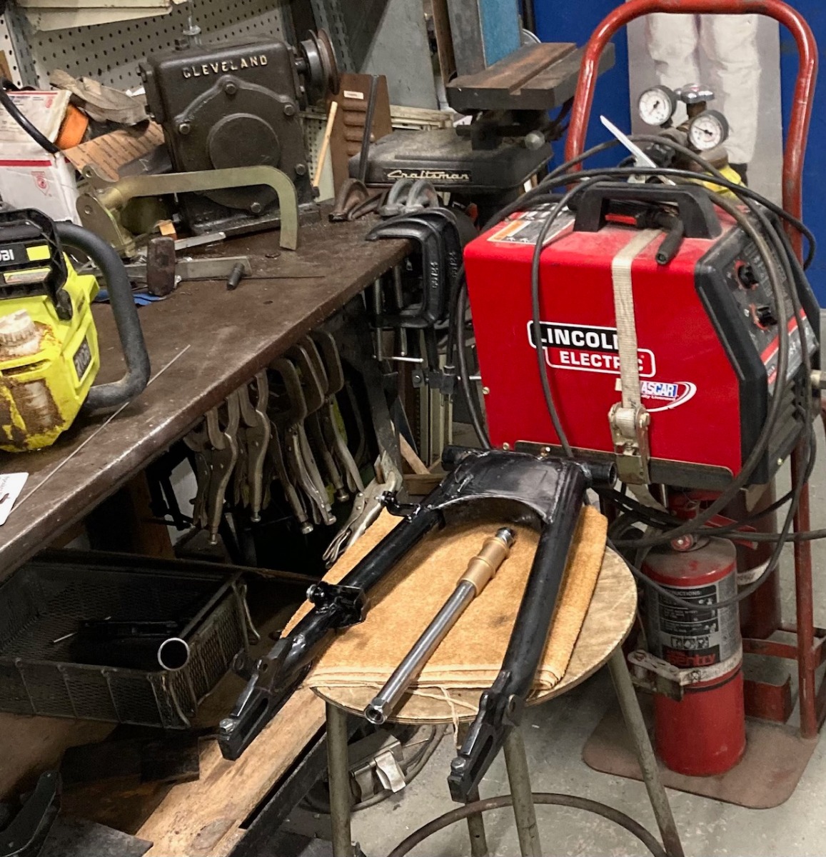

NOW! needle bearings are pressed in Bronze bushings, the stock steel sleeve bush is too long. it is the one for the 78 KZ1000 that was in with this lot?
The lip on the bronze bush is .164".
I'm wondering if I have to omit the OEM dust cap shields with the O-ring. on each end at the inner sides of frame?
I don't want to start pressing in bushings without knowing the correct geometry of this? Never did this in the past.
