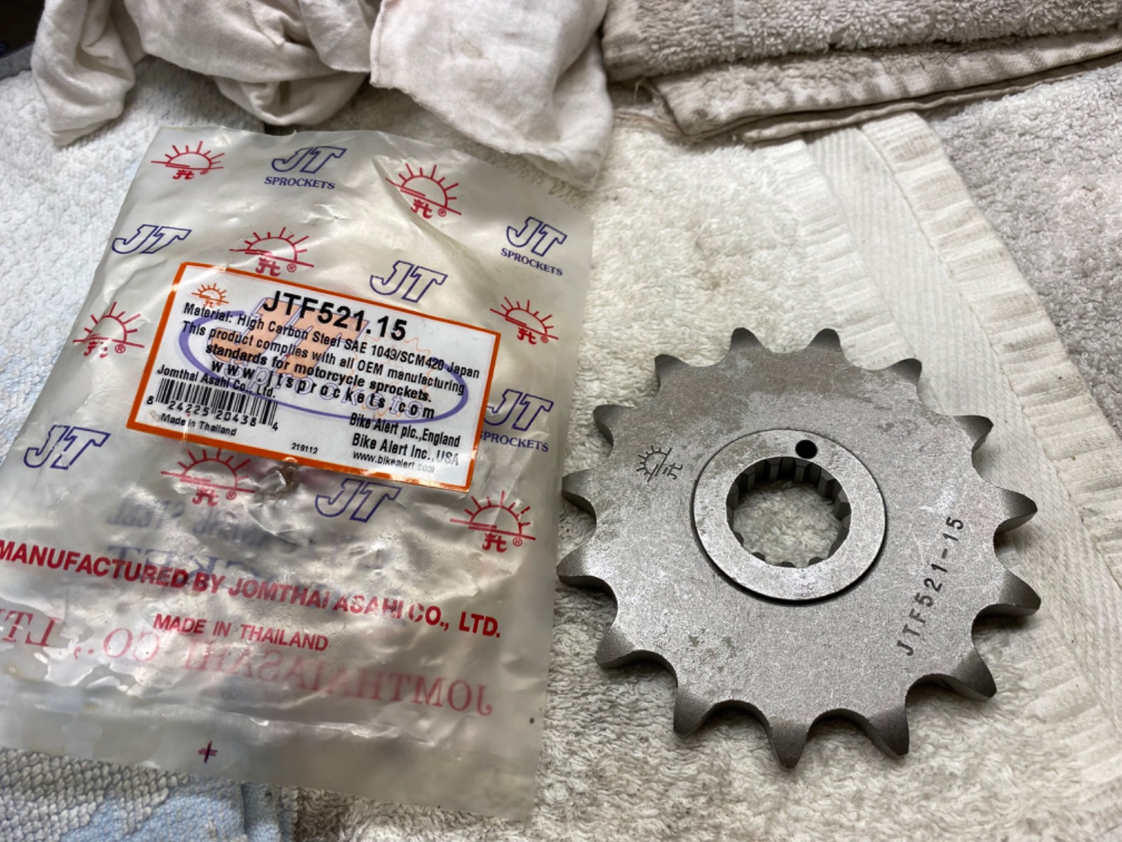

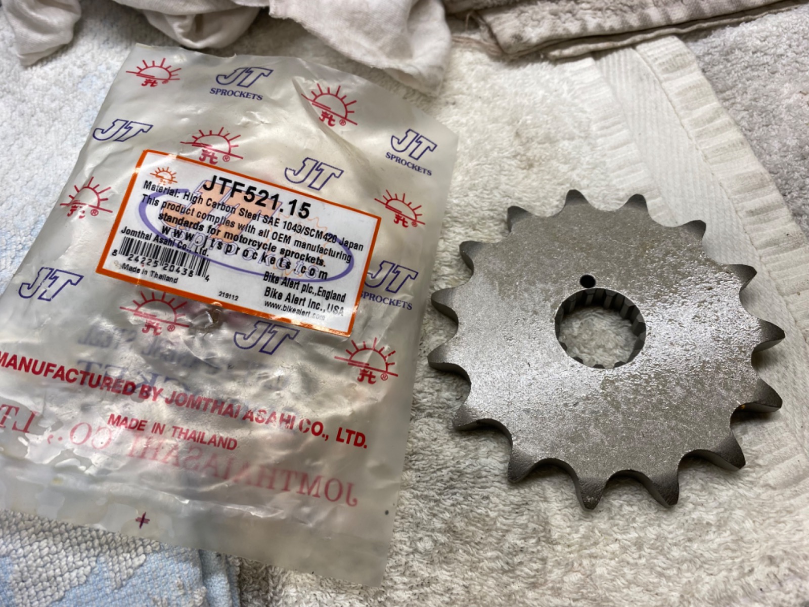

I am in the process of changing the sprocket and chain, but which way should the front sprocket be mounted with the 630 chain on the KZ900 … Should the sprocket with the raised boss be in to the engine, or the flat side … See picture:

Shoulder to the engine.  This is to prevent the chain from rubbing on the tranny cover.

Thanks! It was as I thought
Yeppers!!!
