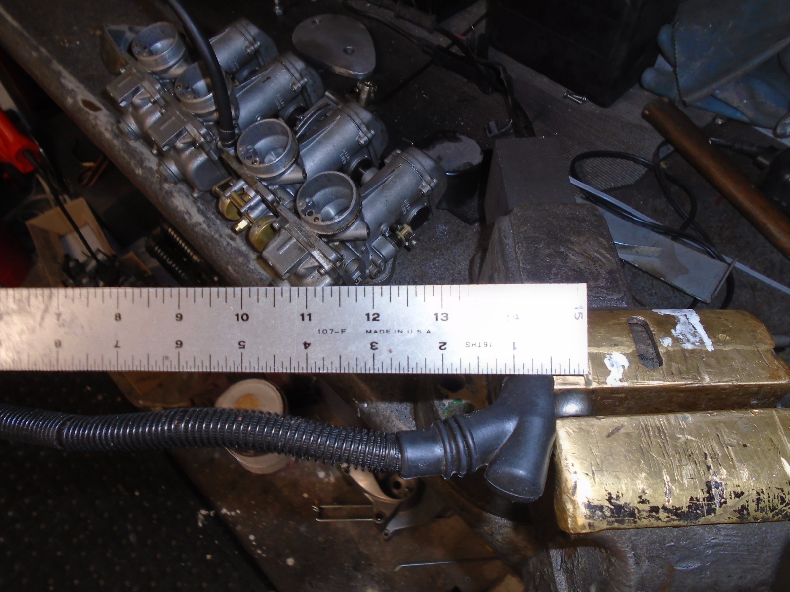

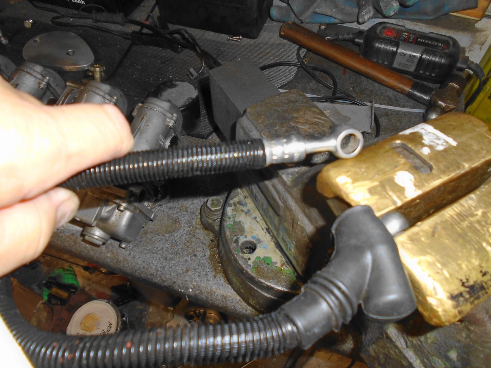

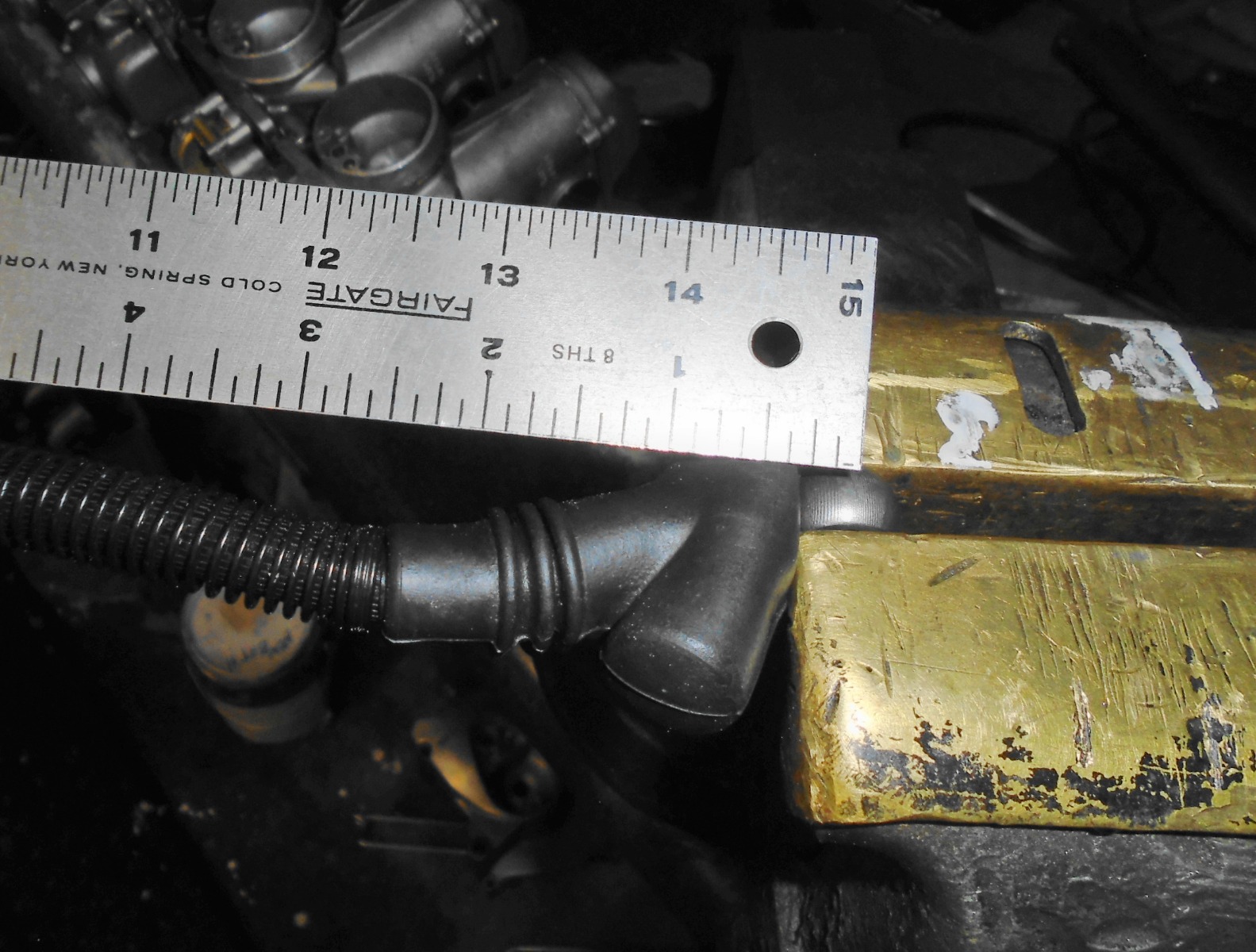

15" INCH. CENTER EYE TO EYELET / OEM Z1B. Same as 76. JUST MEASURED IT IN VISE. TOUGH TAKING ONE HANDED PICTURE!
Buy a correct length stainless line & 2 - 10mm banjo fittings with screw together fittings, from a local Harley or Aftermarket shop.
