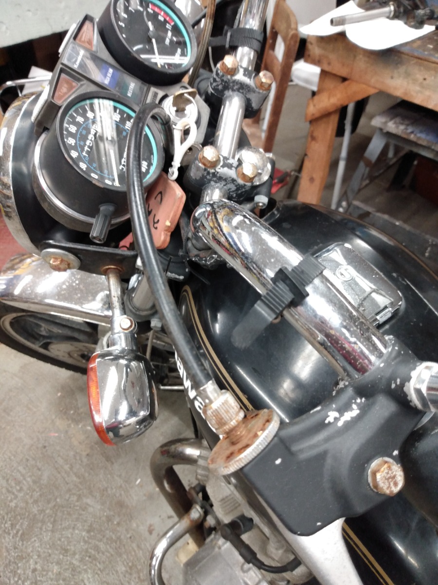

After carb rebuiding, gas tank and petcock cleaning, I was able to get the bike running and took it for a ride up and down the street. Bike ran well and shifted through the gears fine. So, I'm ready to move on to cosmedic issues. I'm not looking to put much money into this bike. But just get it to a decent looking every rider.
Most the chrome plated hardware is rusted. Looking for ideas on cleaning them up, or inexpensive replacements.

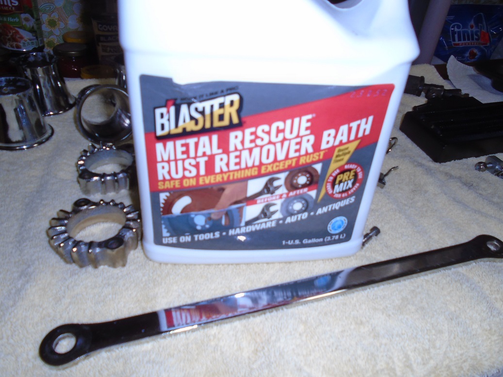

Tried a new green product / rust remover.
Made for the "PB Blaster" People. It actually works!!
I miss my 5 Gal. bucket of phosphoric acid in crystalline form from work! I retired in 2011. Lasted me 7-8 years. We used it in our boiler room.
Like the other's said. It turns black after it's used up.

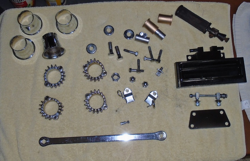

I gathered up some old chrome Z1 parts. A day soak, in basement. No fumes!
$27 for a gallon at the Orange-Commi-Depot store.

Thanks Marty. I'm about to soak some parts in Evaporust, I'm gonna get some of the Blaster stuff and try them side by side. Looks like the Blaster may be better on chrome or painted parts.

Hi Scotty, don't put painted items in rust remover.
