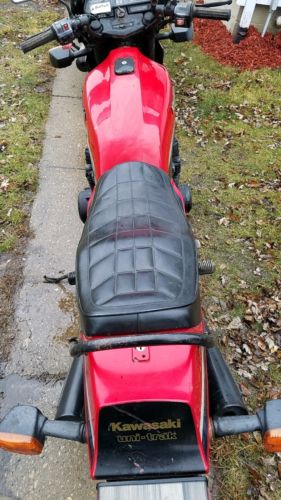

I'm sure this is the world's dumbest question, but how do you open the stock seat on this bike? This '82 is as bone stock as they come. I have both original keys. The bike has two of what look and act like helmet locks on each side under the seat, but as far as I can tell they only operate the helmet loop locks and don't release the seat (like my 1980 Yamaha XS650 does). I have looked under and around for a release and do not see one. Maybe this is a friction-fit seat, but I'm hesitant to just yank on it and risk breaking it as this bike is so original (yet needs a full resto).

I believe the latch on that model is behind the seat on the tail cowl.
You can see it in this picture under the grab rail.

Oh wow. I think you are right. Mine has a small black spot there that I did not pay much attention to. That must be a sliding cover or a rubber cover. I'll check when I get home today. I sort of looked at that and pushed it with my finger and it did nothing so I thought it was just a cover for a screw for the tail panel. Seeing that pic I'm sure you are correct. The funny thing is, years ago when I first got the bike, I had taken the carbs off to clean them and I remember having access to the air box so I had to have removed the seat at some point. Haha. Thank you!

As TexasKZ indicates. In the diagram note the seat lock cover & location of the seat latch.
www.partzilla.com/catalog/kawasaki/motor...0-h1/seat-seat-cover
note the orientation of seat lock. 27016A in the diagram drawing.
www.partzilla.com/catalog/kawasaki/motor...tch-locks-reflectors

I found pictures of an '81 and you are correct that is where the release is, but for the '82 they changed it I guess. I always thought the '81 and '82 were very similar(despite the unitrak), but the more I look the more siginificant the detail changes there are between the two years.

1982=1983 Both have it in the top of tail behind the grab bar.
