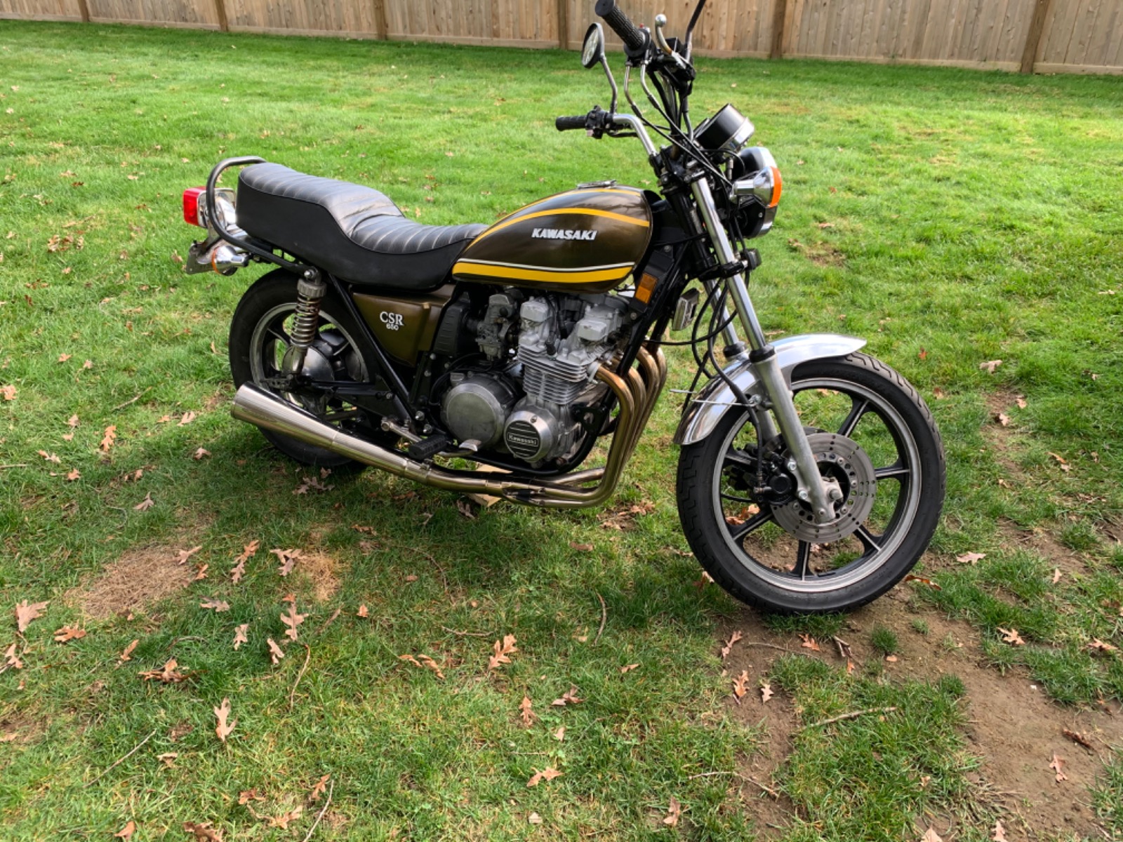

Hi I’m looking to get a set of mags for my 1981 kz650 csr. It has all factory rims on it and I was wondering if anybody had information on what mags would fit onto the bike if any without modifications. Also if I buy the rims do I need to get the front rotor with it and the rear brake hubs or just the rims. Thanks for the help

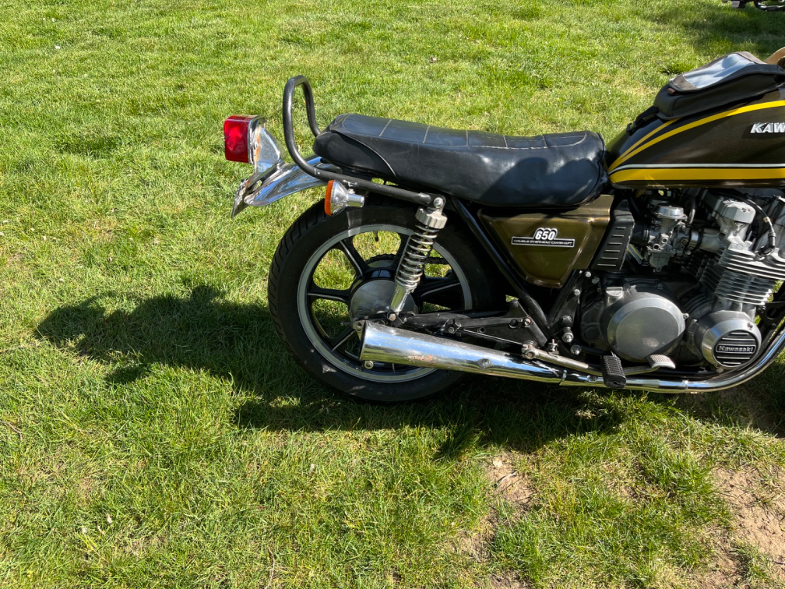

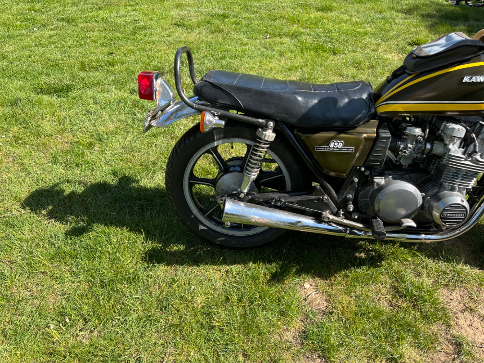

I have the same motorcycle and installed KZ550-Ltd chain drive wheels, direct swap.
All you need are the wheels & front brake rotor. everything else swaps. axles, speedo drive, sprocket carrier, brake panel, etc etc.
I would install new brake shoes as an old lining can separate & lock the rear wheel. It happened to me, so it does happen.
1981 KZ650-CSR w KZ550 Ltd wheels. older pic. I have since installed Emgo Euro bars.

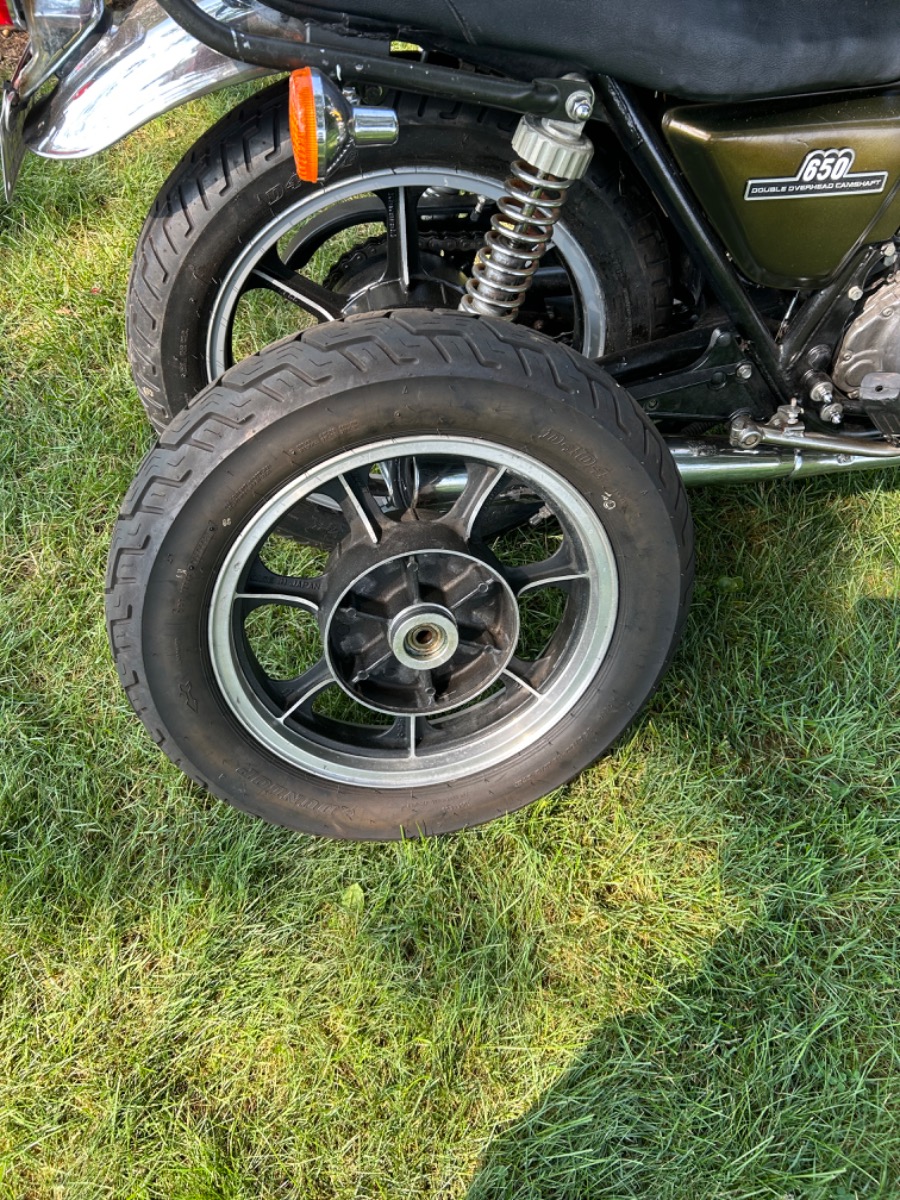

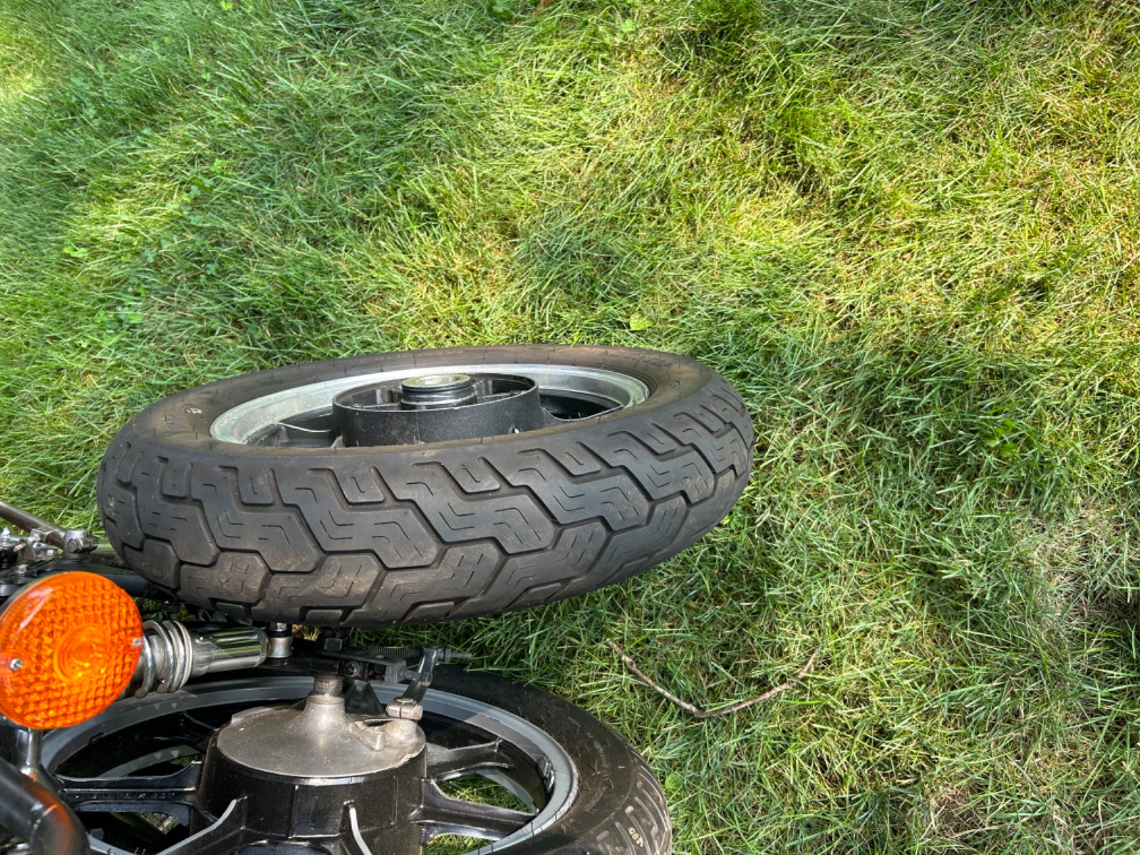

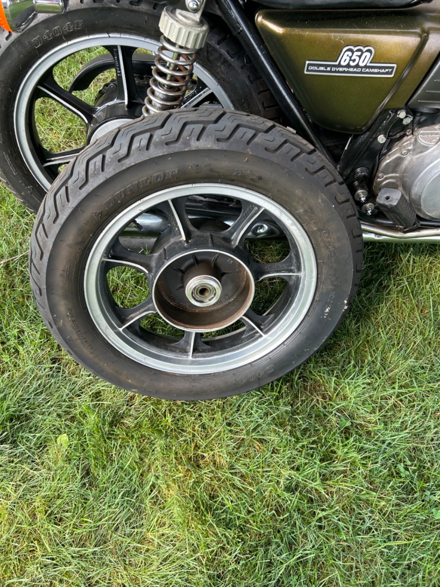

Hi and welcome, did same with info from martin’s post, but front is from 82 750ltd, as is front end has duel brakes, have since changed rear to 18” I’m taller, and cut seat down, have 16” wheel and tire with few hundred miles, if interested, for just shipping,

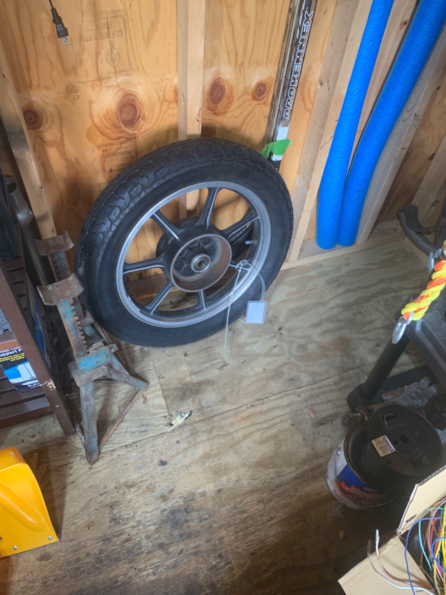

Sure, hop on I-80 east, on south shore of Long Island, but in the meantime, will dig out, and put up a pic, pic earlier is 18” wheel, if you like, will, ,send you my email, and a small favor, if you go for the wheel, besides shipping make a donation of your choice to the forum, plenty of good and free advice here, thx. Jf
