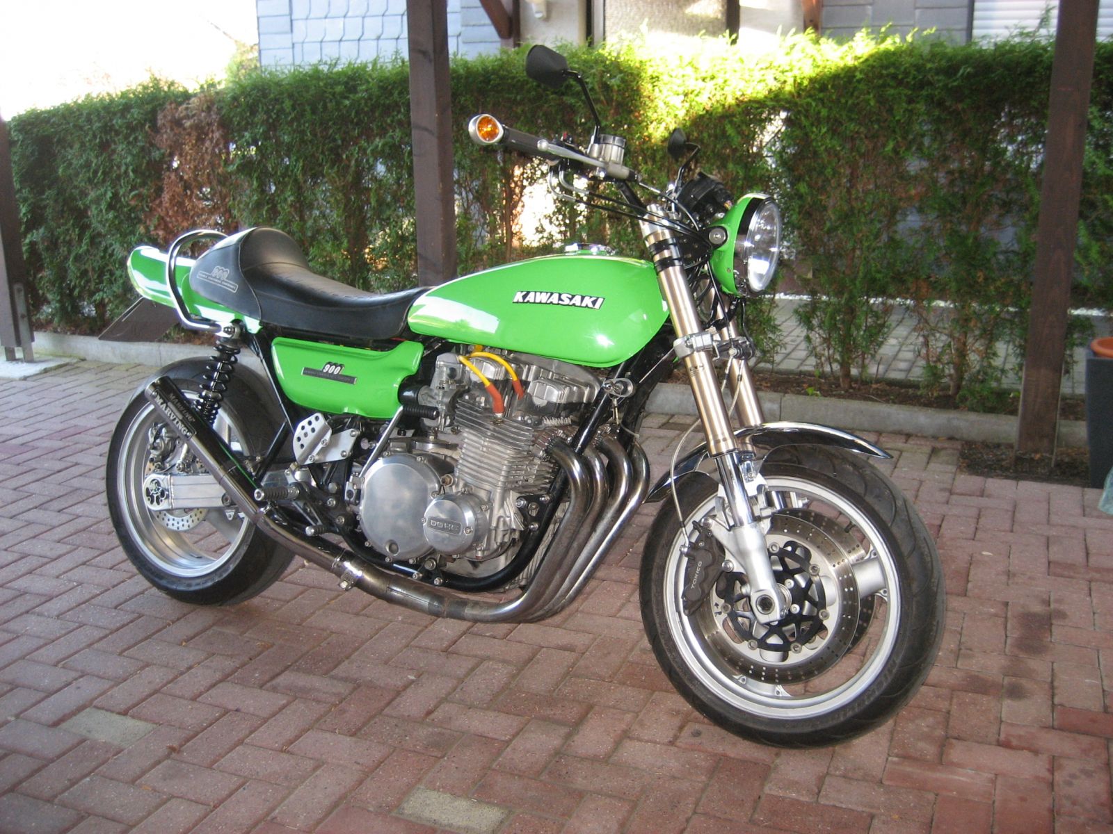

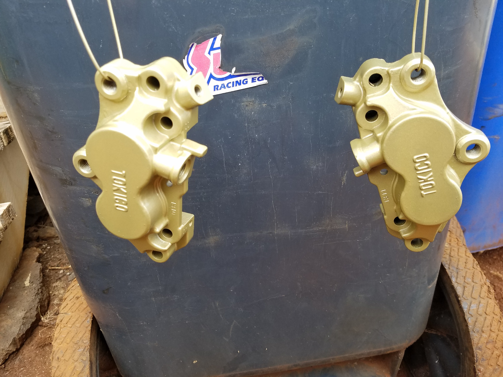

26 Jul 2023 10:18Let's see some pictures JasonGood Morning! I recently got my 1980 KZ1000 resto-mod on the road. The front forks, brakes, and wheel are from a 1990 ZX750H1. The master cylinder appears to be a generic cruiser-type. The brakes work and stop the bike, but they just don't have the bite or or power that I feel like sport bike brakes should offer.
I'd like to update the master cylinder with something more functional and also more fitting to the bike's appearance. Any recommendations on a master cylinder that can push the ZX7 4-pistion calipers? I'm open to MC's with either integrated or remote reservoirs.

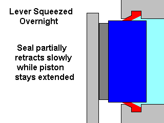

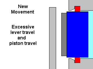

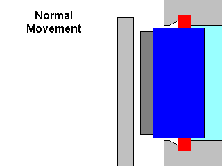

A stock Z1B MC works fine on my ZX9R 6-pistion calipers set up.
Your MC/caliper piston setup need some teaching.

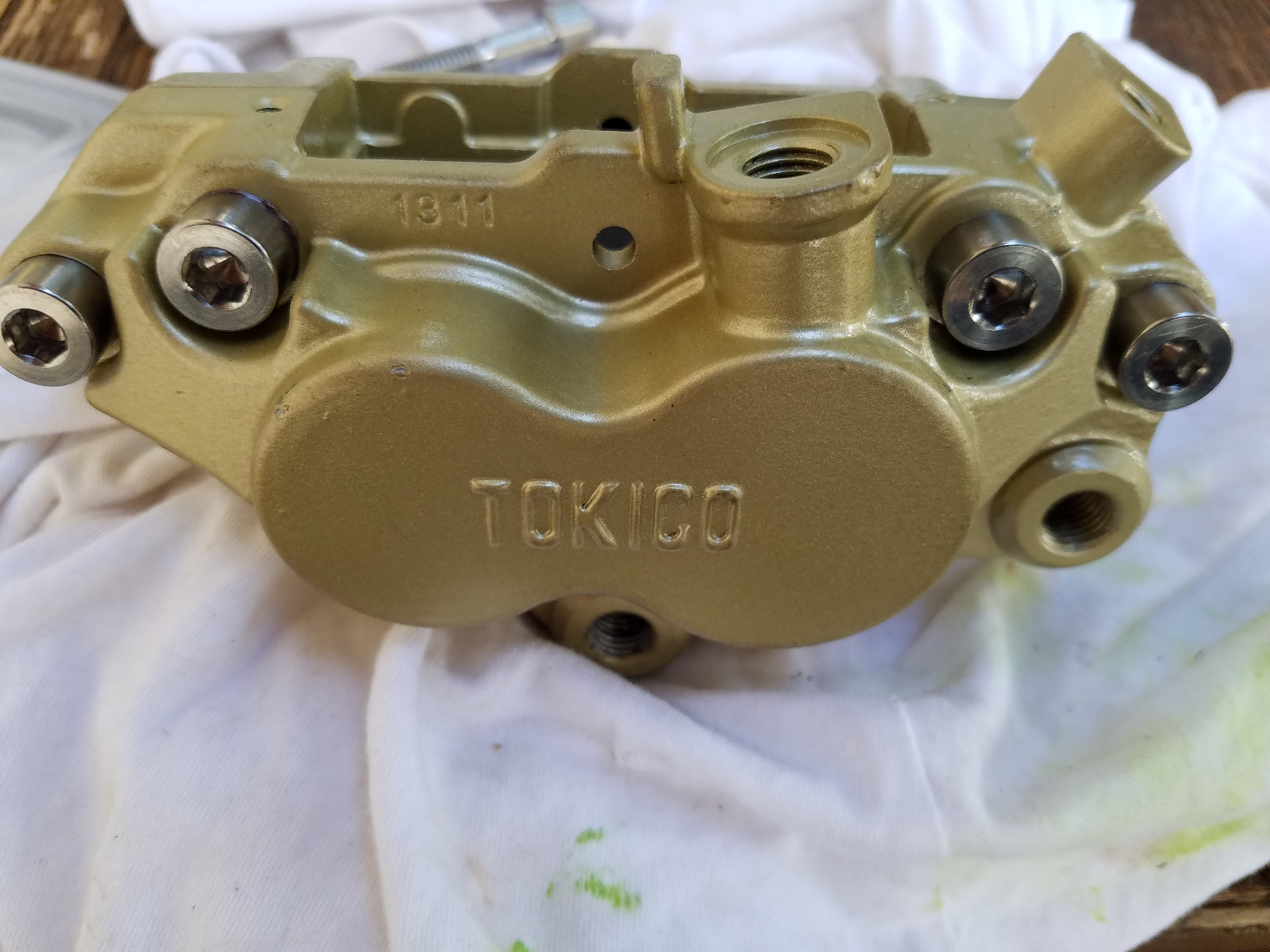

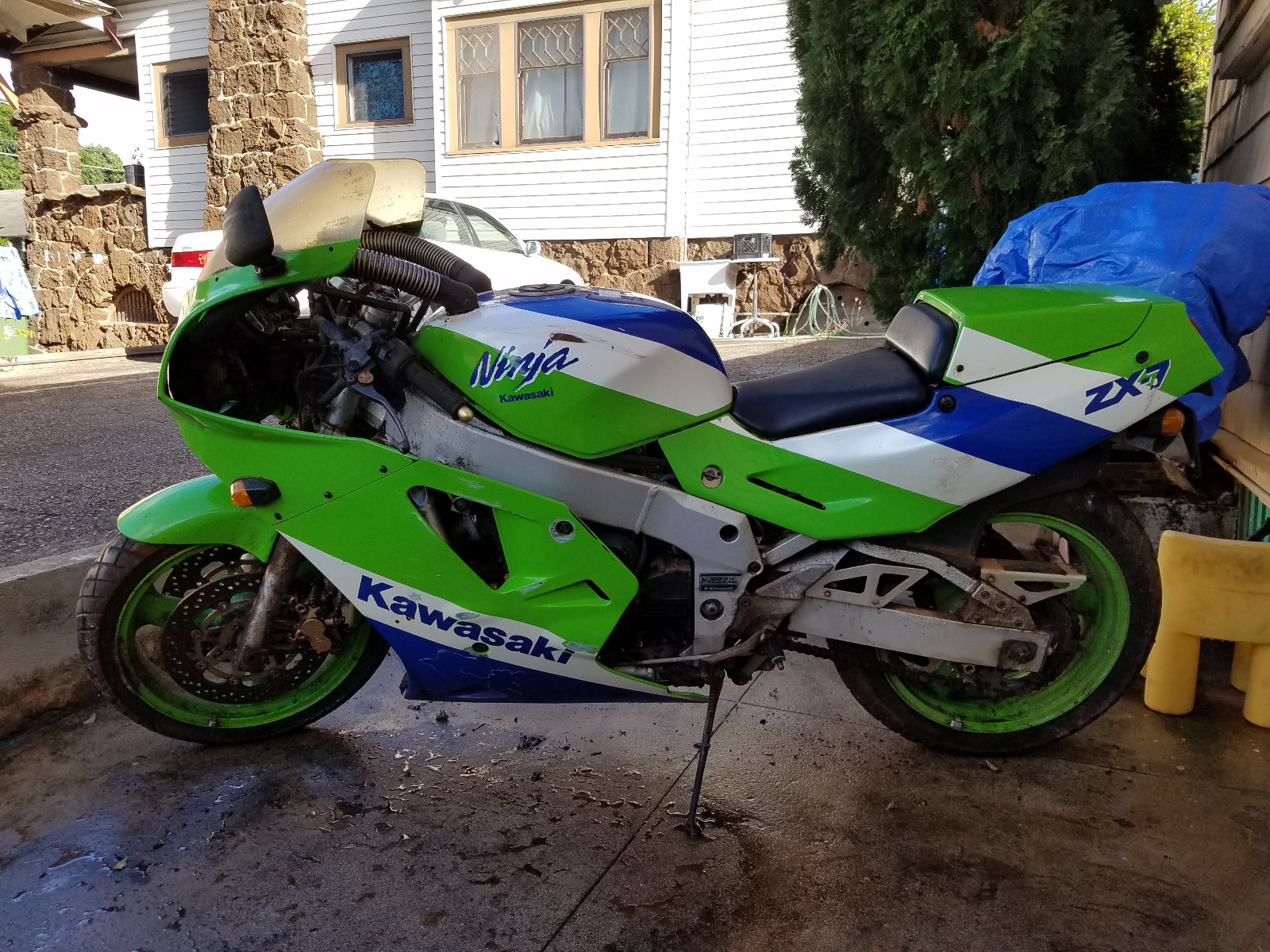

I still have my original ZX-7/ZXR750 H1 model. I bought it new back in 89, and it's in resto mode right now. Parts are hard to come by.
Anyway, brake master for that bike is 5/8. You sure you have the right diameter bore? If you do, you may need to rebuild the calipers you have. Remember, if you have brake from H1, that brake is from 89 and and may never received any refreshing. My ZX-7 have less than 4000 original miles, but due to it's age, caliper was near frozen. It since has been opened up and received a rebuild. Rebuild kit is not that expensive.

Thanks for the advice. That 89 is an awesome bike. I still think those ram air tubes are super cool even though they didn't add much HP at normal-man speeds.

This graphic is great and makes a lot of sense. Thanks!
