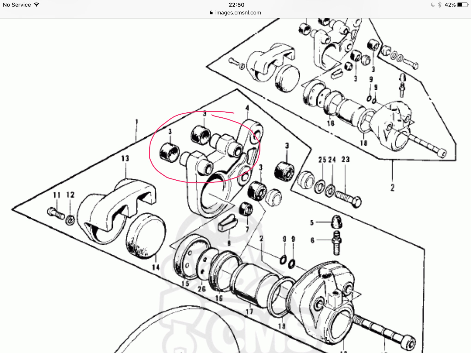

It sounds like the piston in the calliper is applying the outer pad put the calliper isn't sliding at the point indicated below to apply the inner pad. If you unbolt the calliper from the fork leg and rotate it away from the fork (still engaged with the disc) does the lever now feel as expected ?
The following user(s) said Thank You: Tpwood
