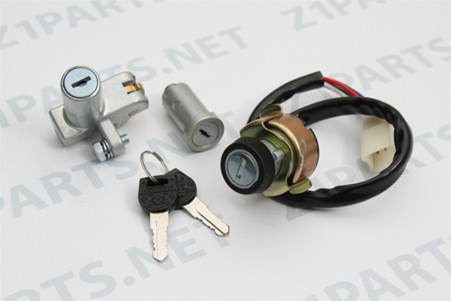

I have a 1978 KZ1000. I found a nice replacement set of locks for the ignition, seat and steering column. I have attached a photo of the set.
My question is, how do I remove the old steering column lock cylinder? It looks like the only way is to hammer it out with a socket extension.
The old one still has the locking pin in the cylinder but if you try to turn it with the key, it gets stuck in the extended position.
Any ideals?

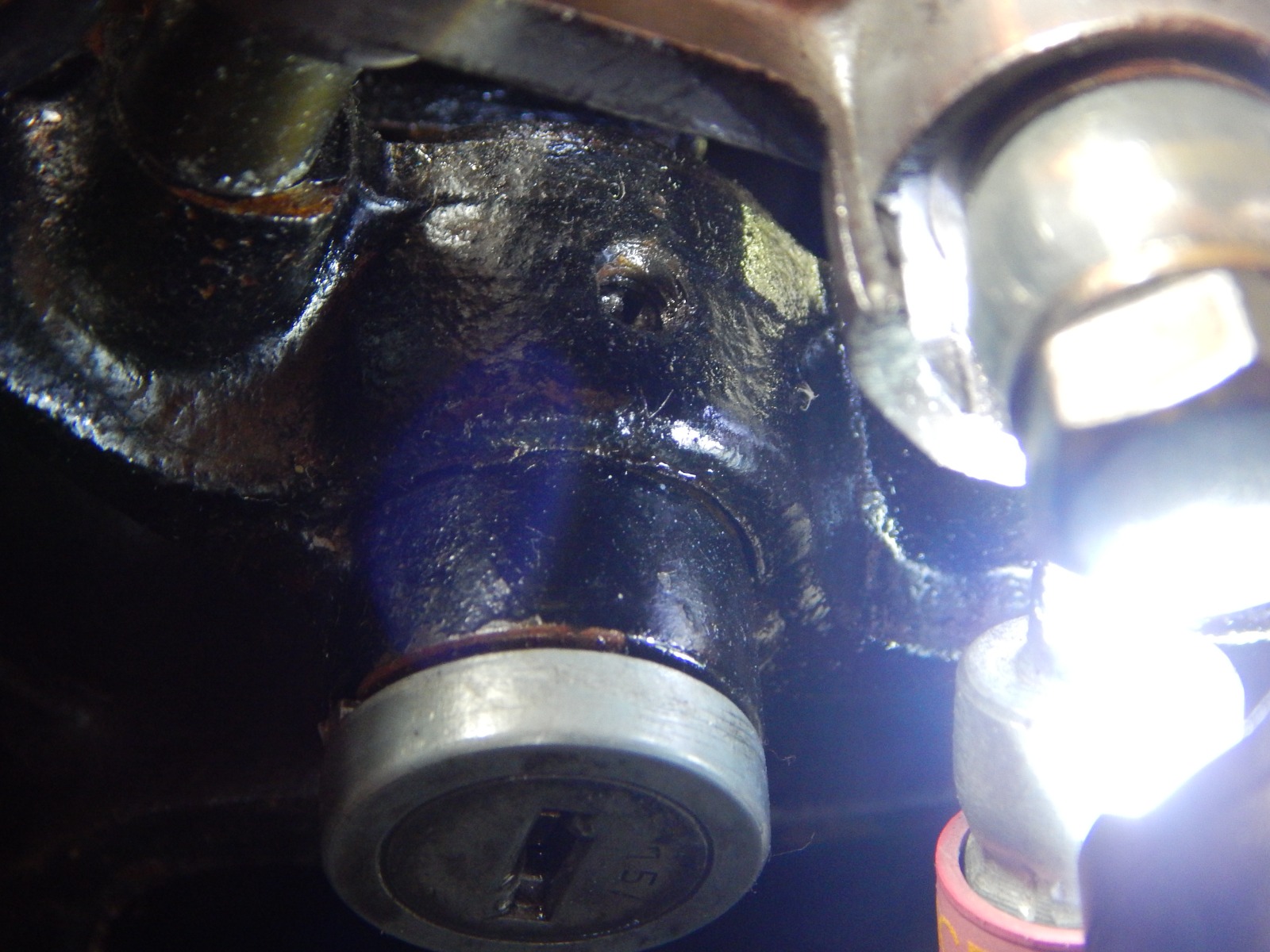

29 Jun 2023 10:40There's a tiny set screw in the lock housing behind the front brake line junction.
You don't want to do that!!!

Moose is correct. The ignition switch you posted will not work for a 1000. Shown is a 4 pin for the Z1/Kz900. Your 1978 will require a 6 pin ignition.

Mikaw,
FYI, the switch I received is a six pin. It's already installed and working as expected.
Thanks!

urankjj,
That is a great photo! It actually shows the head of the set screw. Now I'm thinking that I have to remove the brake fluid junction to get access.
I should be able to do that without disconnecting the brake line, correct?
Mark
Mark
