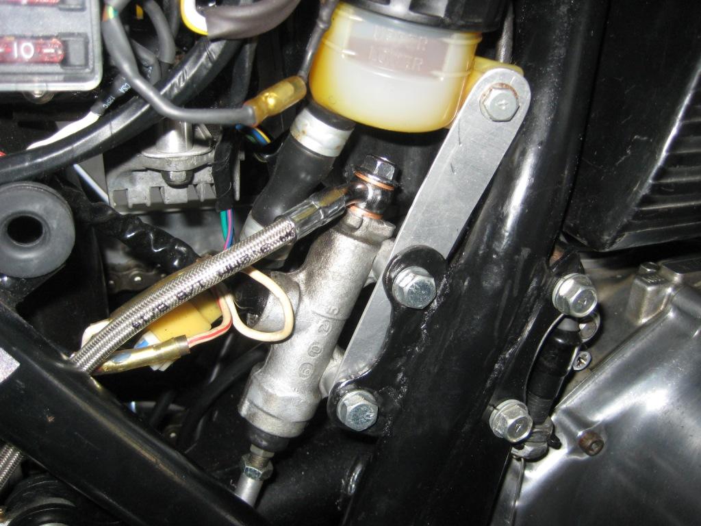

The rear master on a SR would be 14mm, that one you pointed out is too small. It also has that weird pivot attachment, you would not need that. A used modern master would be a better choice and fit easier.
I tried a rear master from a 2007 ZX6 but at 1/2" (12.7mm) it was too small for the caliper.
I ended up using a 2005-2008 Vulcan 1600 rear master which is 14mm. Both fit the stock mount bracket.
You may have to fiddle with a mount for the fluid cup and the brake actuator rod, but the master works like stock.
If you stick with Kawasaki you can get replacement parts.

Corrosion in the master bore renders the core junk, regardless if you can find a good rebuild kit. I've seen more junk masters than good ones when purchasing 40 year old brake system parts. I'd go straight to something newer, and then work through the conversion, unless you come across a cream puff core, and those are getting RARE these days.
