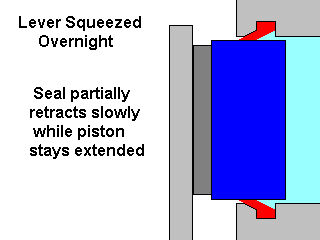

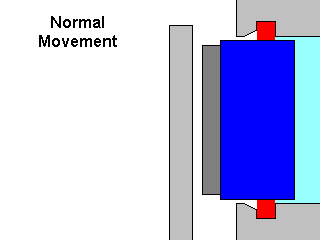

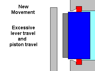

Did you mess with the calipers? This sort of problem occurs when the caliper pistons are pushed back away from the disc. The fix is to first make sure the caliper is clean and free of gunk. Next, pump up the lever and tie it back to the handlebar for several hours. This allows the pistons to creep out of their bores and move closer to the disc. In extreme cases, you may have to do this a couple of different times.

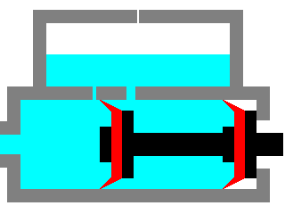

Worst case (especially if fluid changes have been neglected) is that there is a rust band in the master cylinder. When bleeding the piston is travelling further than normal so the seal could be damaged by corrosion build up. If the actions already suggested don't sort the problem you may have to look deeper into the master cylinder

To let the bleeder screws sit open did nothing! You need the break fluid pressure to reset the gasket ring travel!!!

Also as previously mentioned, on old vehicles it is best not to use the full travel of the piston (maybe a little over half) to reduce the risk of tearing seals on corrosion in the cylinder
