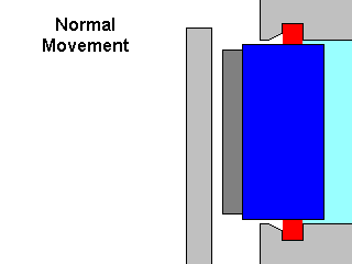

Did you mess with the calipers? This sort of problem occurs when the caliper pistons are pushed back away from the disc. The fix is to first make sure the caliper is clean and free of gunk. Next, pump up the lever and tie it back to the handlebar for several hours. This allows the pistons to creep out of their bores and move closer to the disc. In extreme cases, you may have to do this a couple of different times.

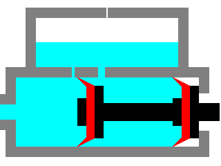

Worst case (especially if fluid changes have been neglected) is that there is a rust band in the master cylinder. When bleeding the piston is travelling further than normal so the seal could be damaged by corrosion build up. If the actions already suggested don't sort the problem you may have to look deeper into the master cylinder

To let the bleeder screws sit open did nothing! You need the break fluid pressure to reset the gasket ring travel!!!

Something else you can try if you are struggling is after each pump of the lever close the bleed nipple before releasing the lever. Then pull the lever before opening the nipple again - keep repeating this process as it helps stop stubborn bubbles being drawn back towards the MC when you replease the lever
- howardhb
- God, I trust
- Posts: 479
- Thanks: 518
Re: Problem with brakes after lines & fluid change
25 May 2023 04:07Wookie, that is similar to what my Dad taught:Something else you can try if you are struggling is after each pump of the lever close the bleed nipple before releasing the lever. Then pull the lever before opening the nipple again - keep repeating this process as it helps stop stubborn bubbles being drawn back towards the MC when you replease the lever
Squeeze the lever, then slightly open the bleed valve... then, close the bleed valve just BEFORE the lever touches the handlebar.
This way, positive pressure is always maintained. (Hydraulic "cup" seals don't seal well under vacuum)
Repeat until no more bubbles exit the bleed nipple.
I've always done it like that and never had a problem.

Also as previously mentioned, on old vehicles it is best not to use the full travel of the piston (maybe a little over half) to reduce the risk of tearing seals on corrosion in the cylinder
