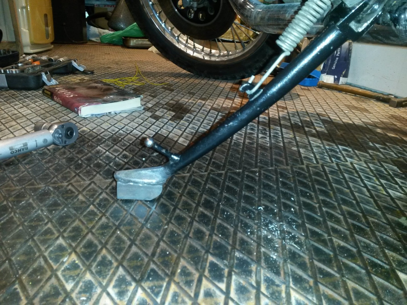

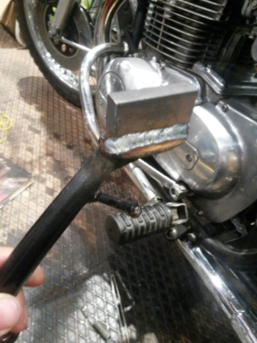

08 May 2023 02:08 - 08 May 2023 02:11Thanks mate, that's a great idea, a bit of polishing and painting and it will look like the stock kickstand. For the moment I made a fix that will work, although it invalidates the solution you propose:I had the same issue with my kz650 when I installed longer shocks.
I was using a piece of 2x4 under my sidestand.
Someone suggested why not have a welder lengthen the side stand.
Just so happens I bought a second side stand as mine was missing the little leg to assist deploying it:
Had just over 2" cut off one and added to the other:
"Stalin" was useful only to extend the kickstand hehe. Maybe it's really only good for that.
(1976) Kawasaki KZ400-D3. All original, but: electronic reg/rec (Oregon Motorcycle Parts), new handlebar controls (w/ PASS/HORN/lights switch, LED dash lights (superbrightleds.com), Dynatek coil (3ohm), MAC mufflers, HEL brake hoses, rubber fork boots, 4.00 rear tyre (Dunlop K70), chromed chainguard
