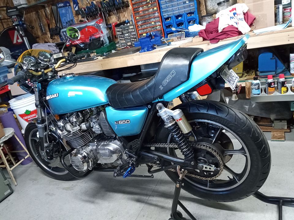

I had the same issue with my kz650 when I installed longer shocks.
I was using a piece of 2x4 under my sidestand.
Someone suggested why not have a welder lengthen the side stand.
Just so happens I bought a second side stand as mine was missing the little leg to assist deploying it:
Had just over 2" cut off one and added to the other:
Rob

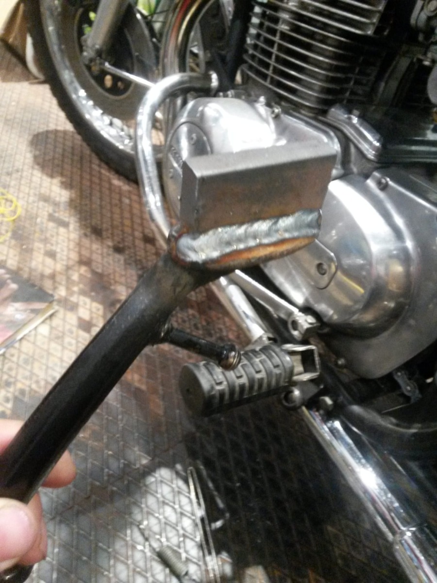

08 May 2023 02:08 - 08 May 2023 02:11Thanks mate, that's a great idea, a bit of polishing and painting and it will look like the stock kickstand. For the moment I made a fix that will work, although it invalidates the solution you propose:I had the same issue with my kz650 when I installed longer shocks.
"Stalin" was useful only to extend the kickstand hehe. Maybe it's really only good for that.
