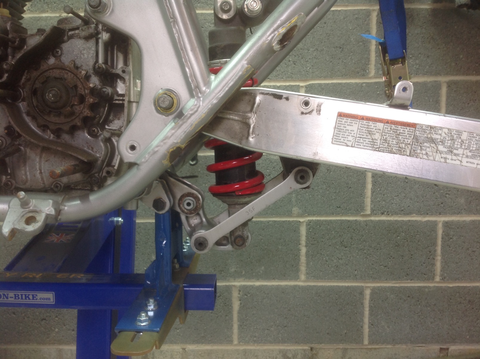

23 Apr 2023 23:51Do you have an overall vision of what you want this bike to be ? You seem to be jumping about with several modification questions which are all significant changes requiring involved work. A monoshock conversion doesn't stop at a couple of shock mounts welded to the frame, you need to ensure the correct location and check the "rising rate" is working correctly. You then need to re-engineer everything else around it, the battery etc will need to find a new home as the shock takes the space were the battery normally locatesWould a monoshock be more wobbly or more solid than some good external reservoir dual shocks?

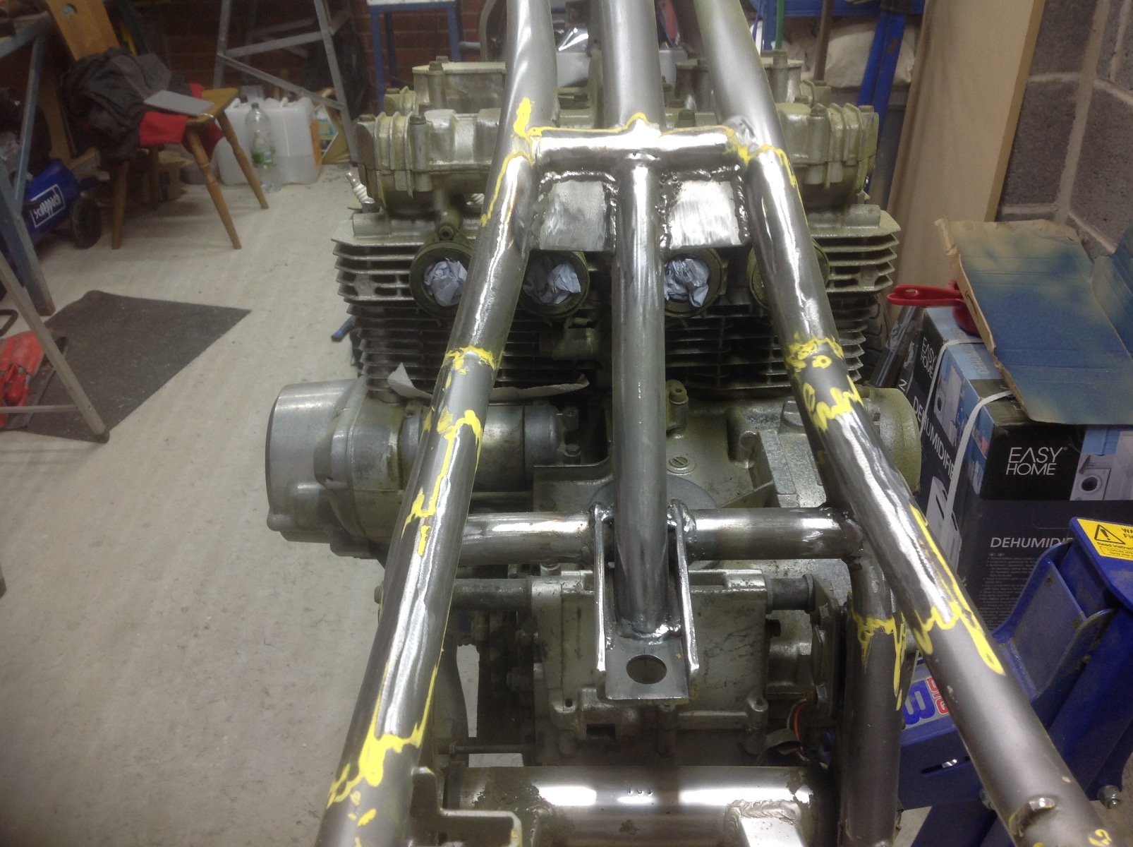

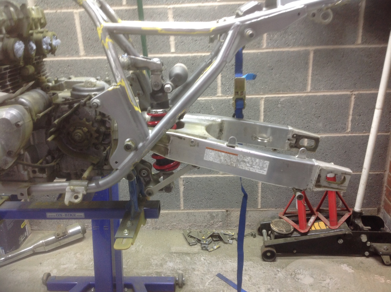

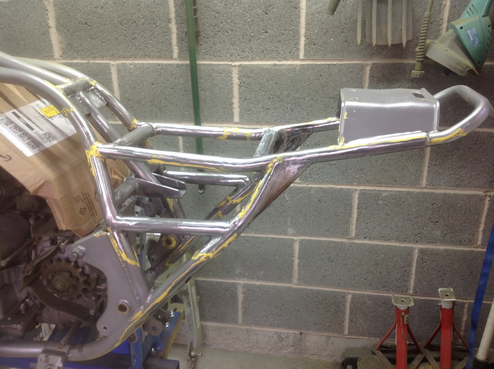

If you chose to go this route the below pics from my "K" will give an idea of what's involved (no wobbly here)
