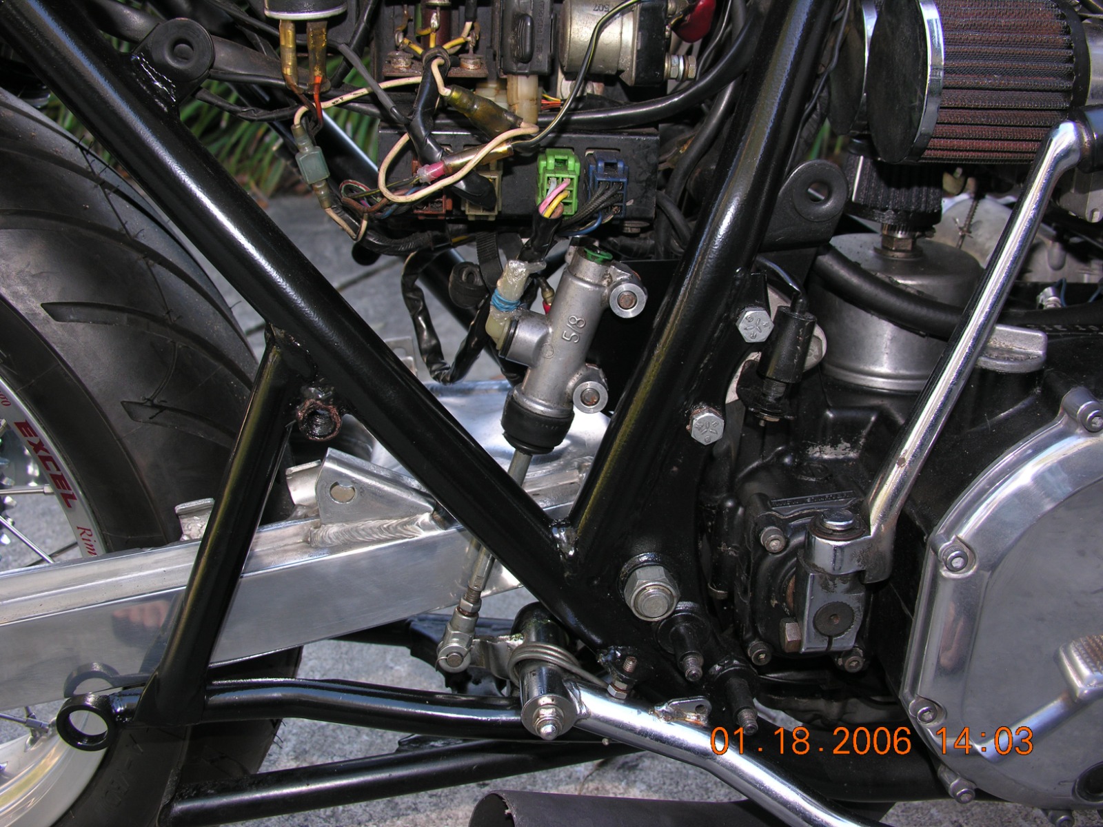

I installed a Suzuki GS1100 swingarm, '77-'78 rear brake rotor and caliper, and a KZ rear brake master cylinder on my 1973 Z1-900. I made a mount for the rear brake master cylinder that bolted on the thick aftermarket right engine mount.

looks good Bob! How about some more pics?
