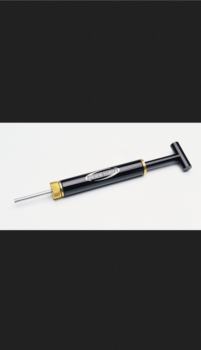

I measure the level with a stiff rubber hose attached to a syringe. I would put a ziptie on the hose... 375mm from the bottom of the hose. I rest the bottom of the ziptie on the top of the fork with the rubber hose inside the fork. Then draw fluid out until i couldn't pull anymore out. Then i know the level of the oil inside the fork is 375mm from the top.
Racetech sells a tool that does this for $144.
I think you could make mine for less than $10 .
photo: racetech.com/page/id/70
If you just add what is in the service manual you may have a bit too much.

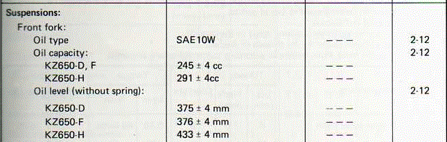

Did you rebuild the forks? or just changing the oil? or only adding oil?
In the 1981 KZ650 FSM pdf:
Service Data page 1-13 (pdf pg 17).
Fork oil Table 2-12 on page 2-21 (pdf pg 51).
Fork Spring free length: Table 4-16 on page 4-15 (pdf pg 105).
