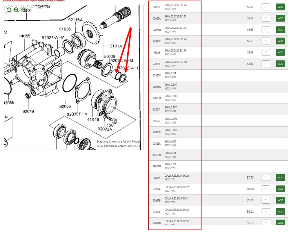

That doesn't seem excessive to me, what does the manual say ref measurements for backlash in the driveline ? If the "backlash" is not in spec it can be adjusted with shims to allow the gears to sit closer together (tapered gears) the below diagram is for the front but I believe the rear can also be shimmed (have the oil in the final drive ever been changed ?)
Just changed the final gear case oil, Great idea to look in the manual I don't know why I didn't think of that. Unfortunately, I wasn't able to find the specs relating to the final driveline in the service manual (it seems to only address the chain drive). If it gets worse I can start tearing into it. Thank you for your help! I didn't realize it could be shimmed up, that is simpler than I expected (compared to replacing the whole bevel gear assembly.
