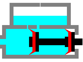

I would investigate the blocked port as detailed by Scirocco. This is a classic issue when the master had crud it in. Those ports shown are TINY.

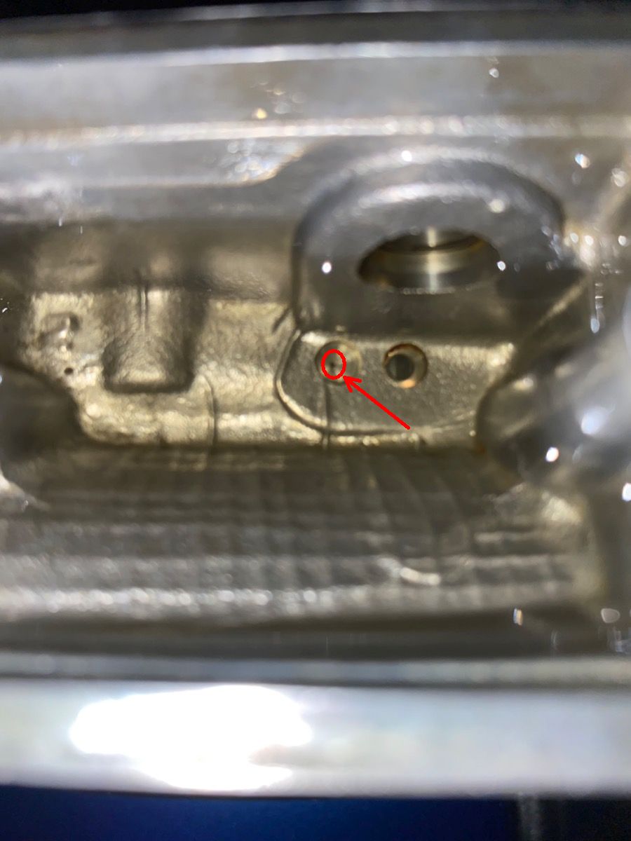

Thank you all, it seems everyone is in agreement that is the issue at hand. I recently rebuilt the master cylinder, cleaned it out good, took a bore brush down it and scrubbed it good and then sprayed it out with brake cleaner. I guess I didn’t get everything out. I’ll post a picture later to ask you all which hole I need to be concerned with, would it damage anything to poke the holes with a pick?

Here is the photo, one big hole and one small one.

The possible tiny clogged hole in question is the tiny black spot. A single string of a wire or tooth brush should fit through the hole.
