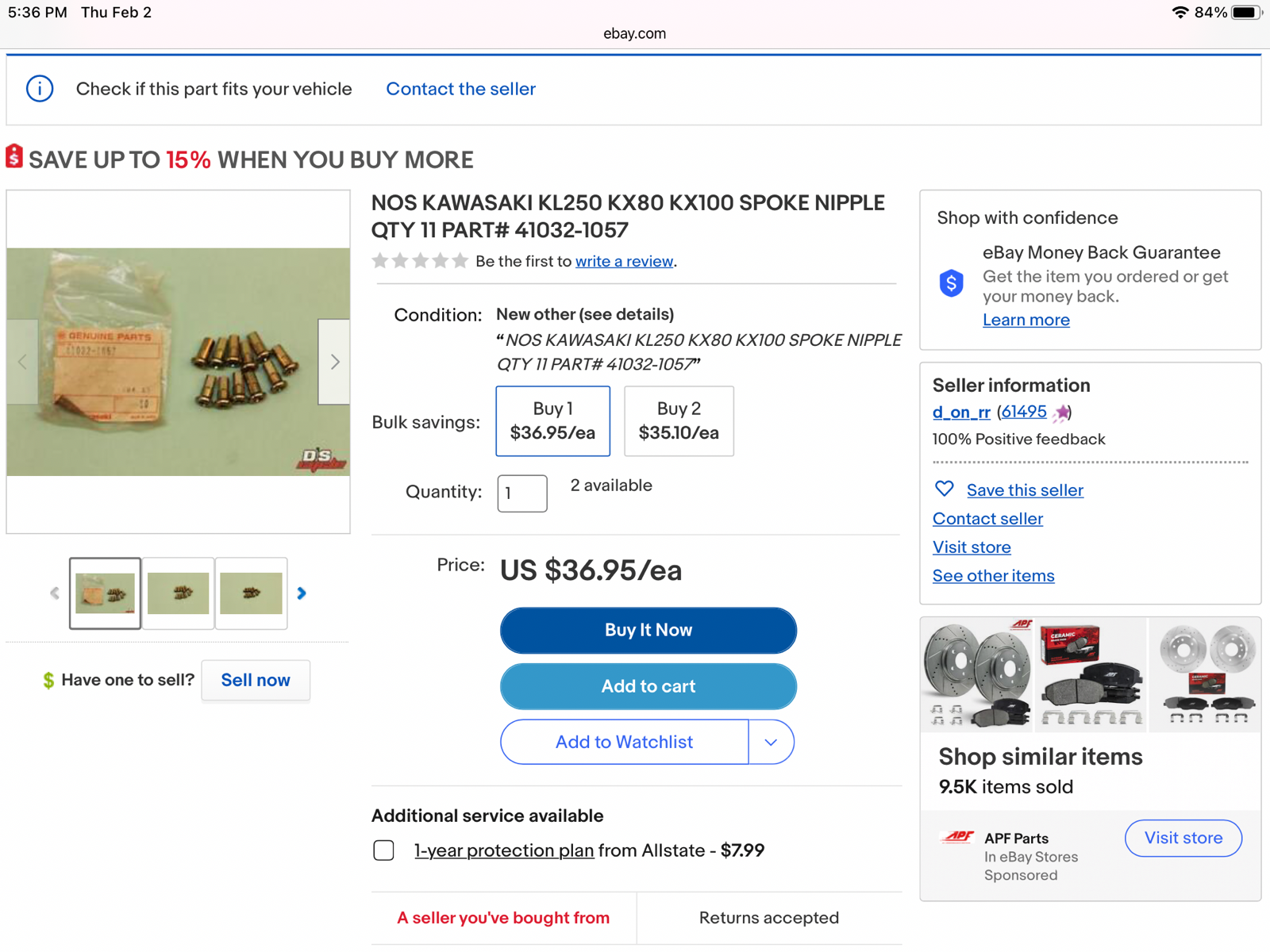

KZ1K = KZ1000A? Correct? ... short version: maybe the KZ305 P/N 41032-022
The wheel diagram for the KZ1000A at Partzilla lists the 87-88 KZ305 in the x-ref for the front spoke assys (spokes w nipples). But the KZ305 diagram lists the nipples separately: the spokes have the same part number as the 1000 & the nipples are P/N 41032-022 listed as NLA.
That 3-digit -022 suffix seems like it might be an early part number. The nipples for my 81 KZ650-CSR are -1005. There's a lot/qty of 19 of KZ305 nipples on EB & they're gold in color, not silver. item #321436220273

Will agree that most of the parts lists I have access to do show the spoke and nipple as a single part #. This is true for models other than the 900 and 1000 machines.
From the kawasaki site I did find a listing for the wheels on the 1981 CSR 650, which lists spokes and nipples as different part #s It shows 2 different part #s for the nipples 41232-022 and 41232-1055 this is also true for the 1980 KZ250. There may well be others but have not researched it further.

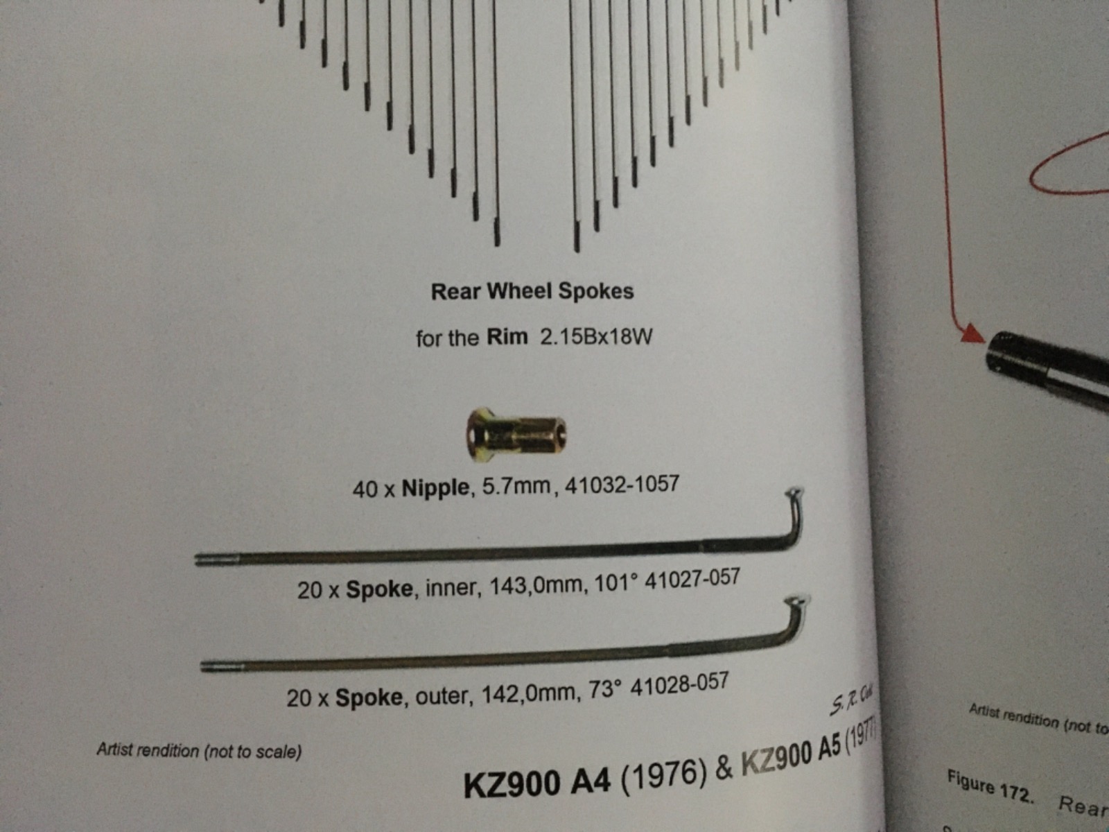

Would the book Original Kawasaki by David Marsden have anything about the spokes?
gd4now: there might be some errors in your part numbers.

- Thanks: 1851
Re: Did Mama Kaw ever publish part #'s for Z1 / KZ900 / KZ1K spoke nipples?
02 Feb 2023 14:34
The following user(s) said Thank You: slmjim+Z1BEBE, martin_csr
- Thanks: 1851
02 Feb 2023 14:37
