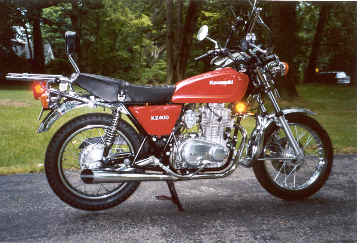

Looking at pictures these bikes seem to have a reasonable amount of clearance normally. Is the "stop" excessively worn allowing the stand to come too far forward (the extra width on the rim shouldn't make that much difference) alternatively you could get a welder to "add some material" to the feet of the stand so it lifts a little higher

20 Jan 2023 05:19The legs of the center stand are the same as in the photo you posted. I think the problem is the extra width on the rim plus the longer shocks.Looking at pictures these bikes seem to have a reasonable amount of clearance normally. Is the "stop" excessively worn allowing the stand to come too far forward (the extra width on the rim shouldn't make that much difference) alternatively you could get a welder to "add some material" to the feet of the stand so it lifts a little higher
I'm going to consider lengthening the center stand a bit. Maybe screwing into the base some very hard thick rubber (I don't have access to an electric welder)
If anyone here has a KZ400-D3, maybe you can confirm for me if the rear shocks are 315mm or if I'm the one with a problem.
Thanks mate.
