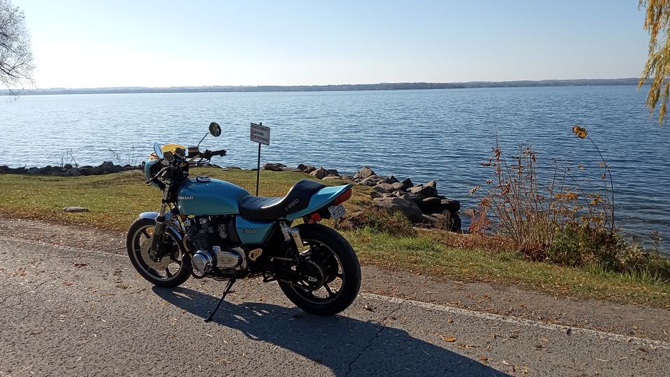

My Magna leans 12 degrees when on its kickstand. To my eye, not enough lean.
The Valkyrie leans 20 degrees. Seems to much to me. Its a bear to get upright.
The KZ305 leans 17 degrees. Seams a little too much, but close.
So is there any concensus on what is the right lean angle when parked on the kickstand?
