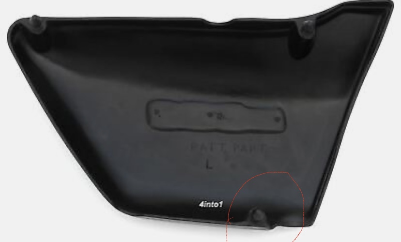

Do someone know about alternative fixing broken «brackets» for the side covers?
Picture below is just from a example of the brackets I’m talking about, can take photos of mine covers when I’m coming back home.

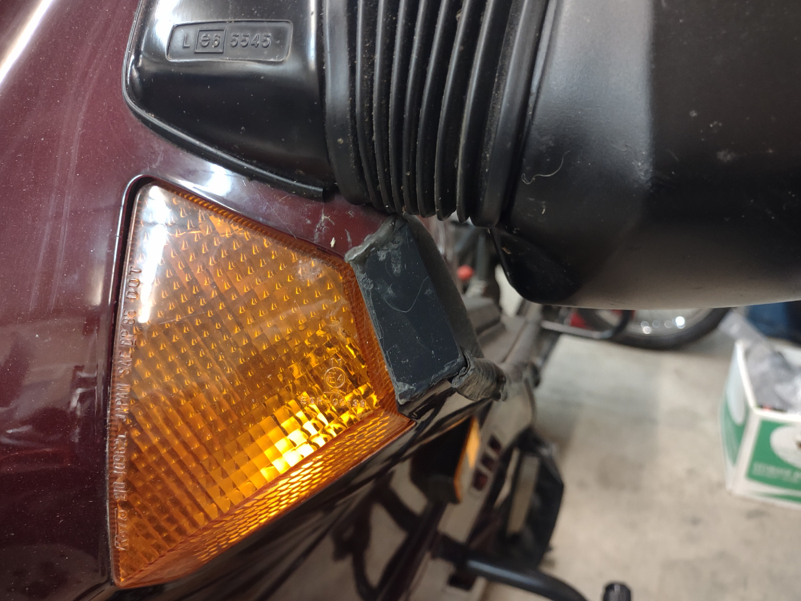

Here's my 94' Concours that had a piece missing from the fairing above the left turn signal when I got it. Once glued in you can fill voids with the powder/glue mixture. Now the repair is solid and has lived through several long distance rides and a drop, maybe someday I'll paint it.
