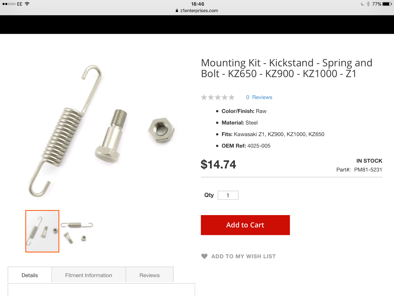

Remove the nut, remove the bolt, and it will come off easily. You will probably want to remove the spring first. Be careful, it is pretty stout.
No drilling needed.
No drilling needed.

20 Nov 2022 14:38PS: Don't forget the inner hole is threaded, once the nut is off you need to unscrew the bolt (you can't take the nut off and knock the bolt through)Remove the nut, remove the bolt, and it will come off easily. You will probably want to remove the spring first. Be careful, it is pretty stout.
No drilling needed.

I don't know what pin there would be. The diagrams don't show a side stand pin & the main stand should have a cotter pin.
To remove the spring deploy the stand, place pennies between the coils, then retract the stand & remove the spring. or something like that. Wear eye protection.

If the thread is stripped and the nut has been cut off you should be able to just tap out the bolt from behind using a suitable drift.

Just out of interest, is there enough of a gap between the stand and the bracket to get a hacksaw blade in (you should be able to apply enough sideways pressure on the stand to stop the bolt spinning while you cut it) whichever way you go will be a PITA at this stage.!
Space permitting you may also be able to push it out from behind with a two legged puller (they aren't expensive)
got to love the PO (why would you cut the head off a bolt that turns !!!!!!!!)
