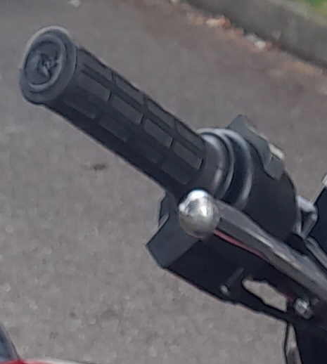

Z1 handgribs
www.fastriders.de/Handgriffe-Gummi-Schwarz_1
KZ650/900/1000 handgribs
www.fastriders.de/Handgriffe-Gummi-Schwarz_2
Edit: Warren is right! Sorry, It was my foult, have switch the links to the corret handgrips now.

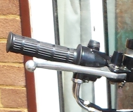

Disagree re 650 hand grips Scirocco, the picture I posted is from the 650 I bought new in 77 and still own.

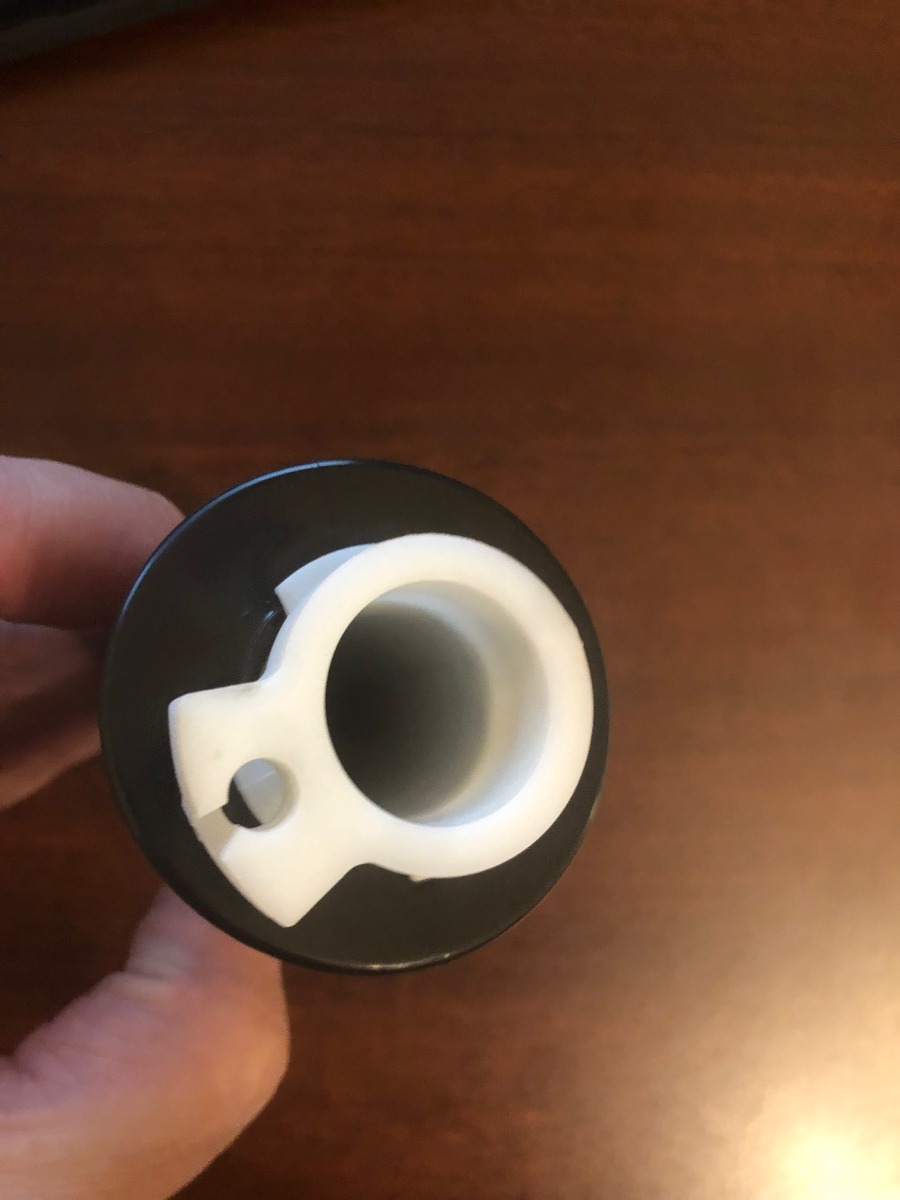

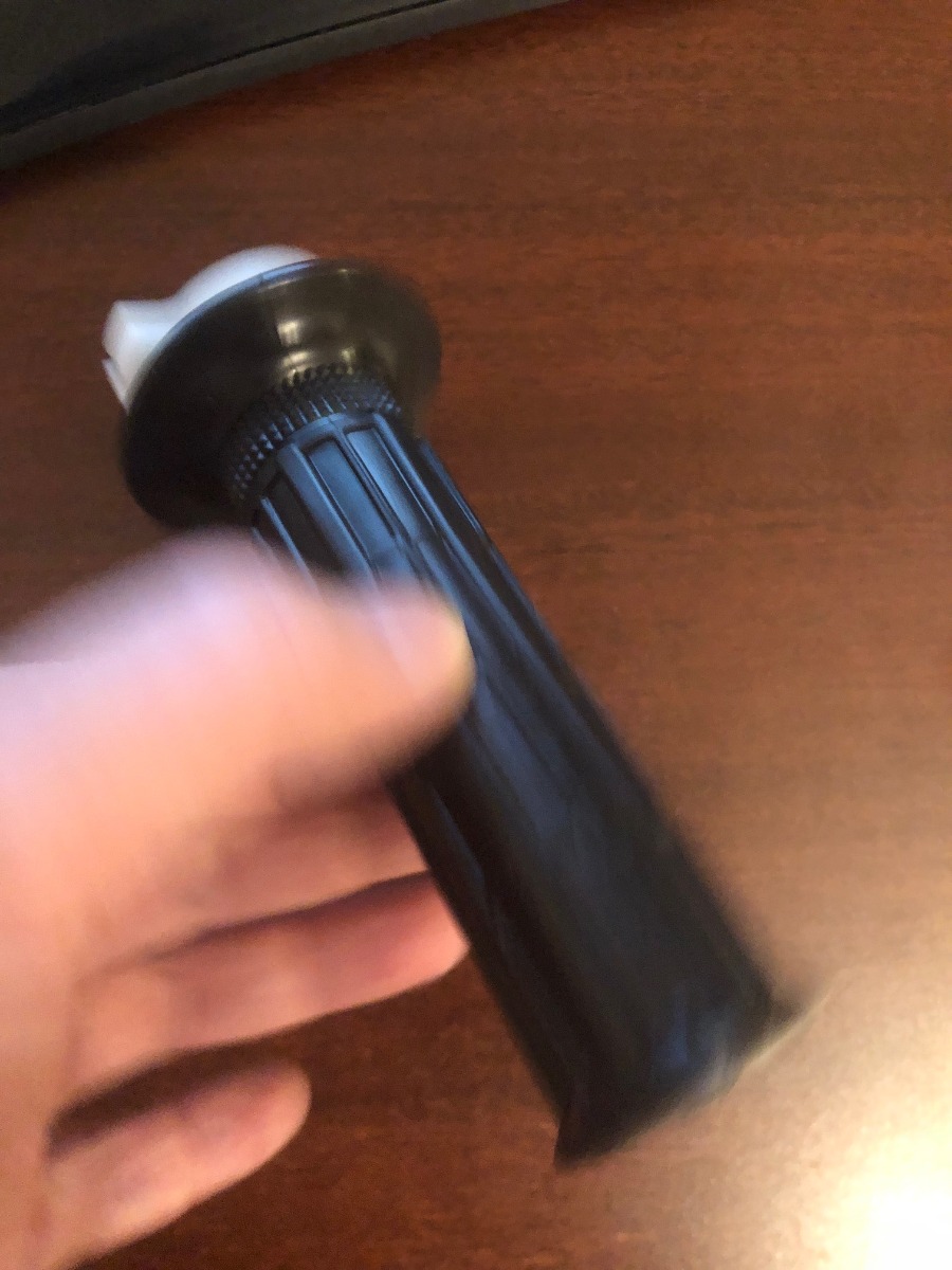

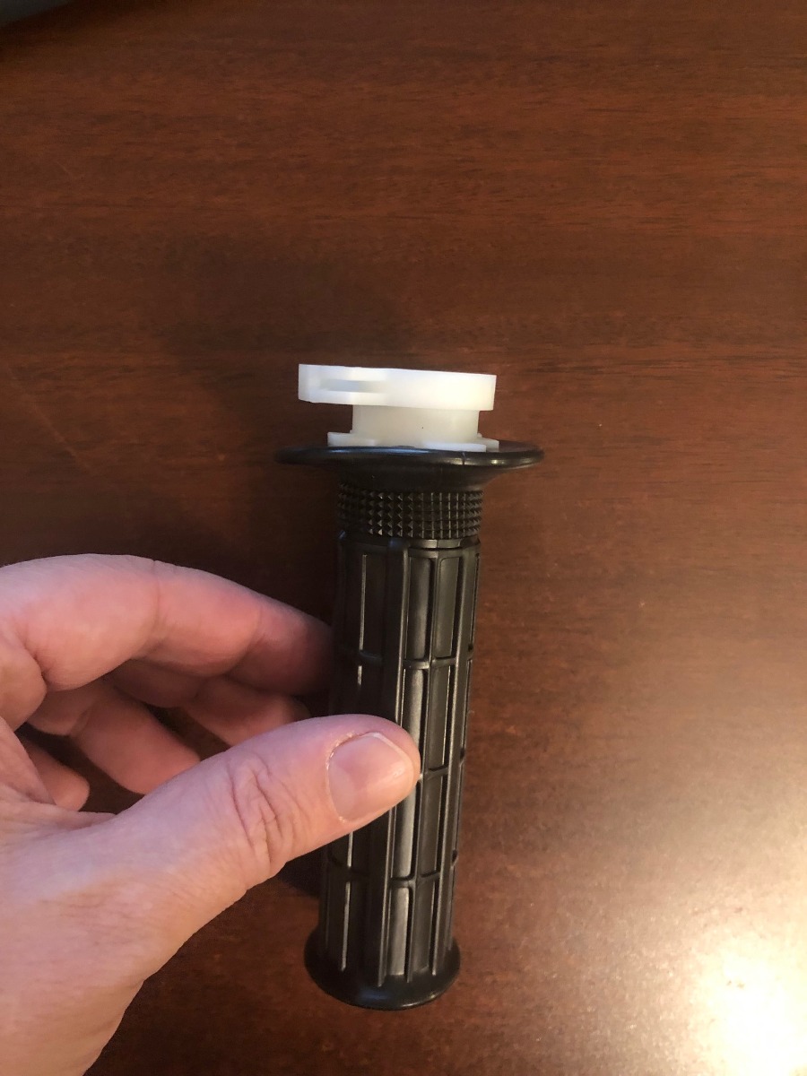

Ordered set from Japan on ebay. Quality look superb. Listed as KZ650. But I think it's wrong throttle one?? There was no detailed pic and I didn't see it's 1-cable.
I will check I may just use my old tube (metal). But who is wrong?

Seller claims difference in 2 cable vs 1 cable is due to "year". Was there "KZ650" which used one cable throttle?

Seller is wrong. Both single cable and grip pattern are wrong for z650b.
That looks like a 80"s throttle tube and grip pattern.
82 Z1000j. Single cable.
77 z650b Twin cable.

Partzilla shows the same two-cable part number for the 650B, C, D, &E1, and a plethora of other models.

That appears to be part # 46019-1015 & it was used on a number of 81-on KZ models, especially 82-on.
82-83 KZ650-CSRs came w BS32 carburetors & use the -1015 throttle grip shown >> my neighbor had an 82 w the -1015 grip.
My 81 KZ650-CSR has VM24 carburetors w the earlier -038 throttle grip assy.
Models w CV carburetors sometimes only use one throttle cable.
From the 1982 KZ650-H2 CSR diagrams: 46019-1015
