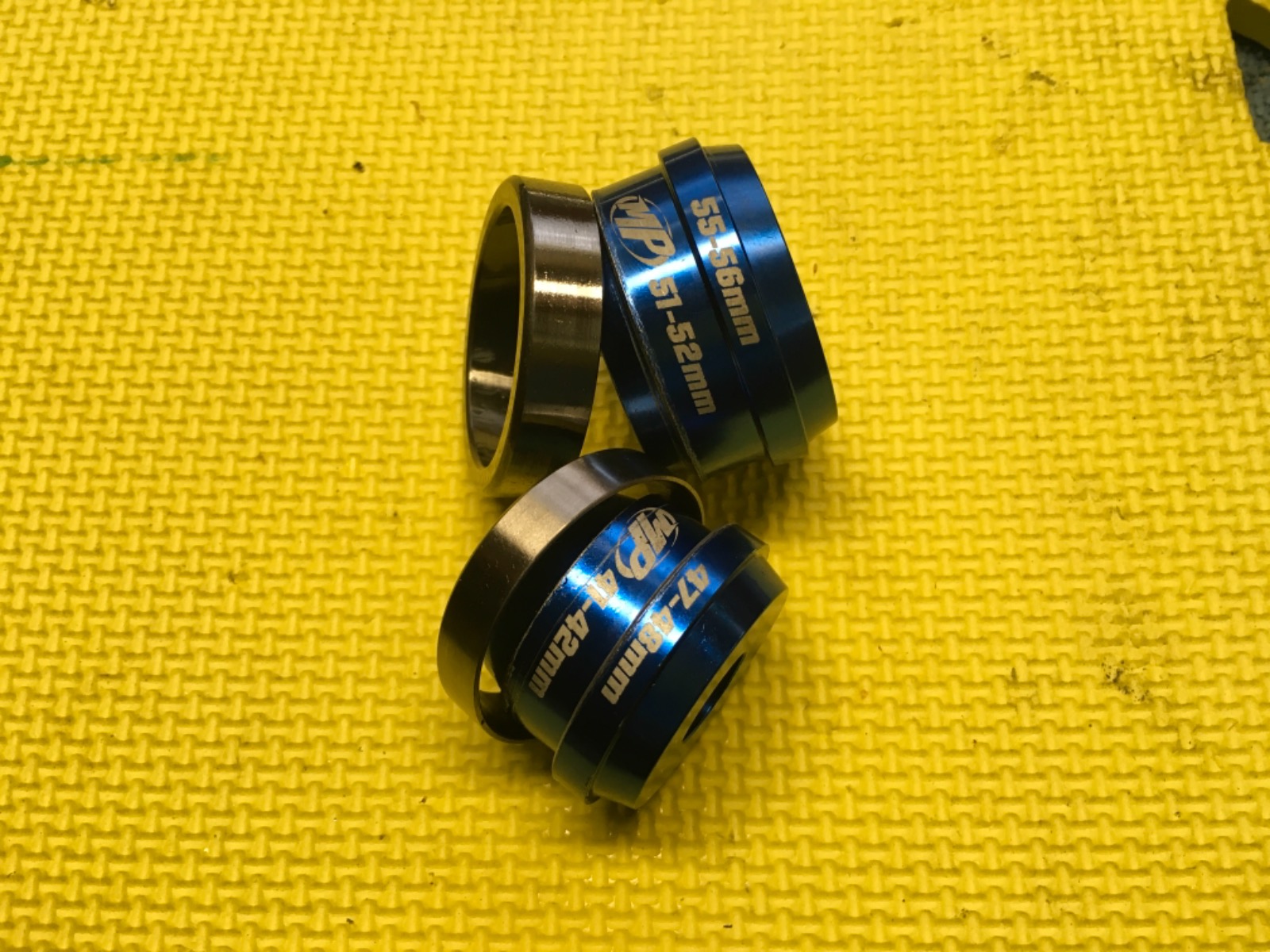

Does anyone know if the Motion Pro steering head race driver fits the KZ1000J models?
www.motionpro.com/product/08-0550
The outer diameter of the races is 47mm and 52mm, Im not sure what the measurements refer to on the tool though?

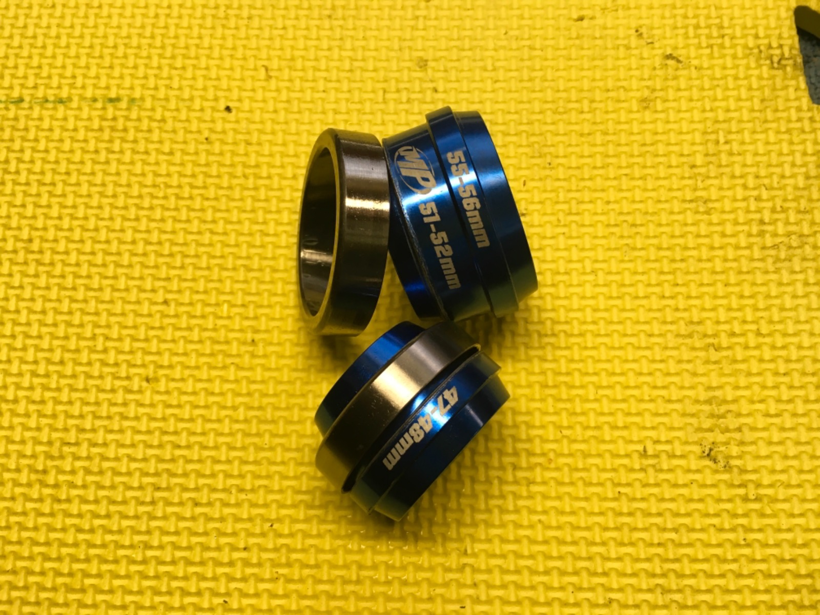

I have that tool. Installed 3-4 sets. It’s not quite a perfect fit to the race. The 51-52 fits ok for the bottom race. The smaller upper race drive isn’t really the correct size. I make it work by driving the race in with the back flange of the 47-48 driver. Kit number 22-2014. Now this is for the ‘73 to 80 Z1-Kz frames. Your J might be different.
