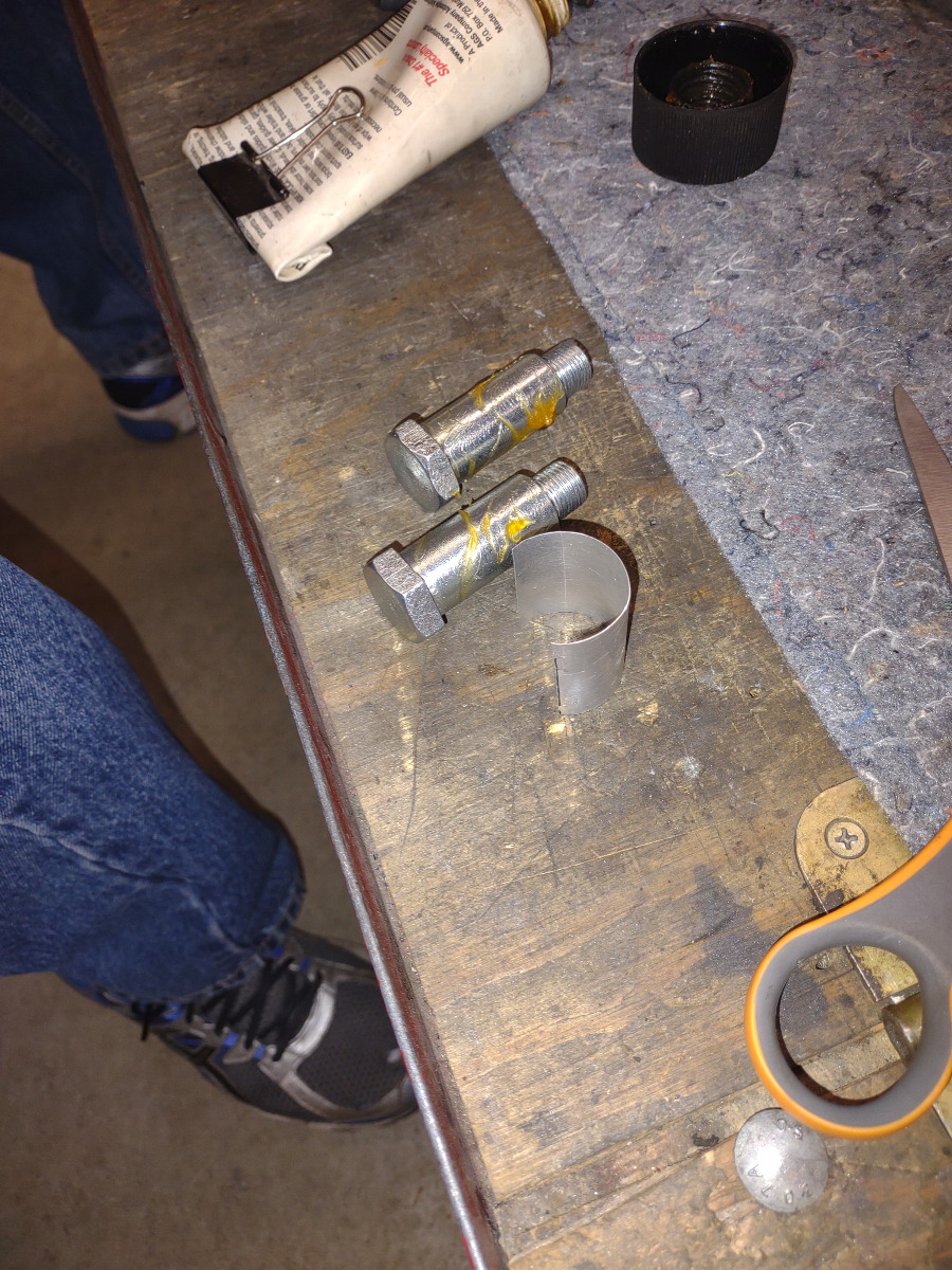

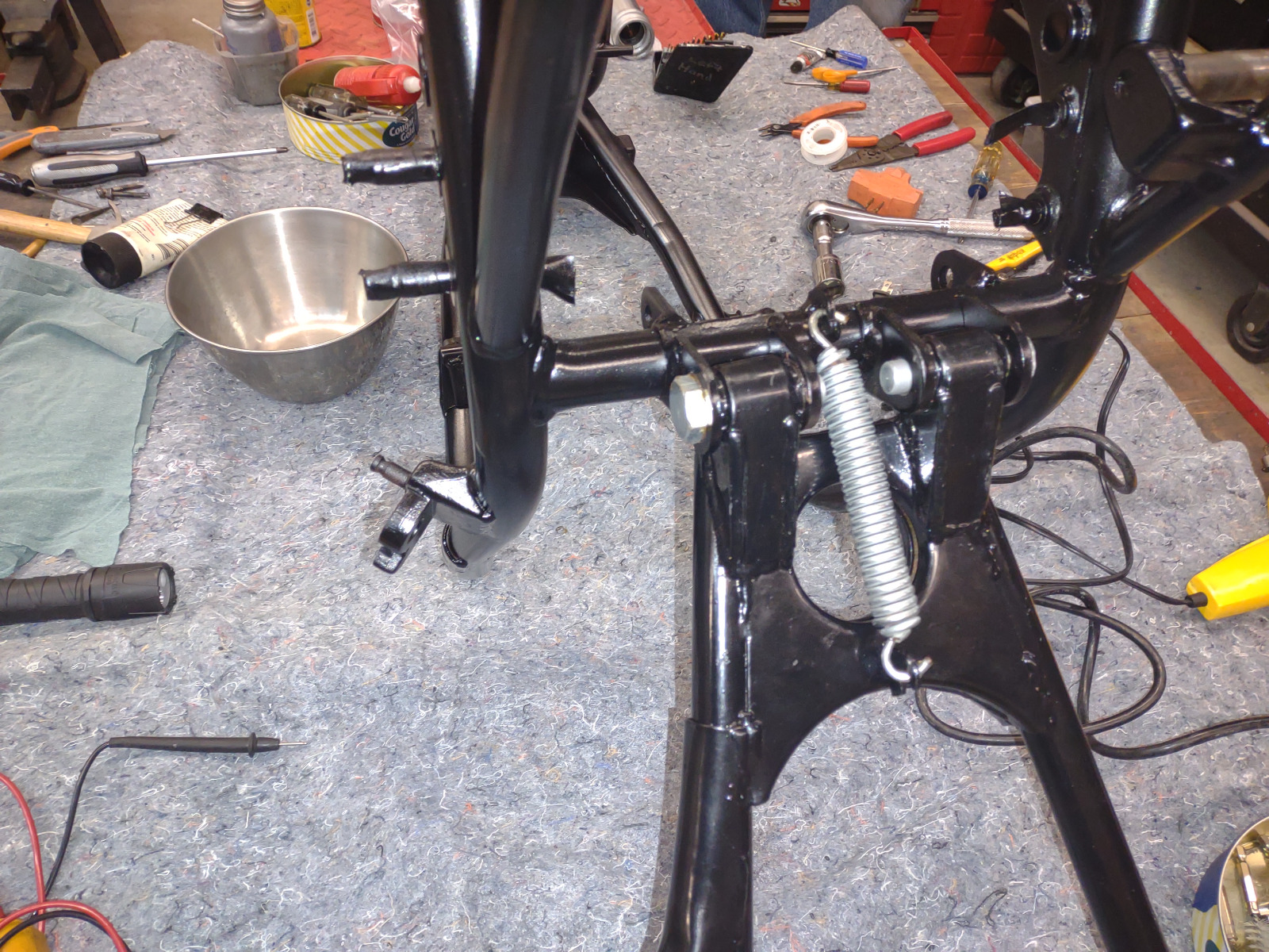

I found a new centerstand at Z1 Parts for $162 including the mounting bolts and spring. The mounting eyes on the stand are too big for the bolts so we made shims with some thin aluminum sheet to line bores. It took up the slop so hopefully it doesn't rattle while riding.
