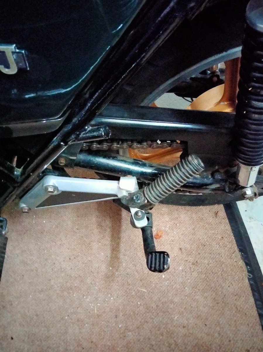

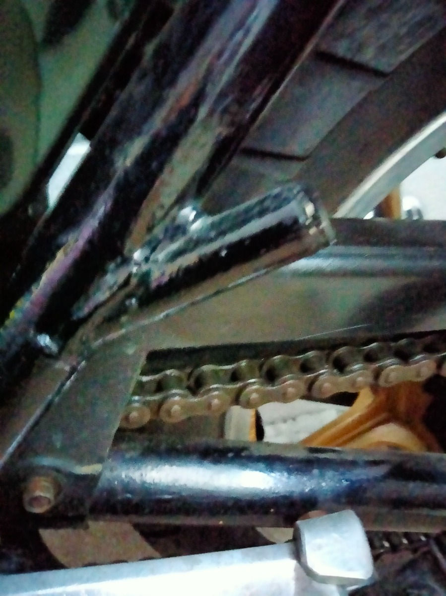

I'm sure it's been asked before here but can anyone tell me what this is for welded to the frame/chassis?

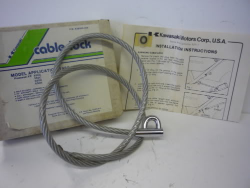

That post is for a factory option cable lock. I have seen them on several different models but it seems to be a European option.

Have you got rear foot rests? On 900's there is a "hoop/bracket" that the rear pegs are mounted on.
Seen many a bike with them cut off. Webike even do replacements for 900's it's that common.
Or maybe as injected mentioned below for cable/chain. Obviously kawasaki thought us in Europe are not trustworthy and spend all day going around nicking bikes that aren't chained up.

It's for the optional cable lock and common cause of the lower frame rail rotting out due to water ingress if left with the sealing cap off.
