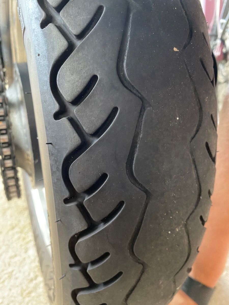

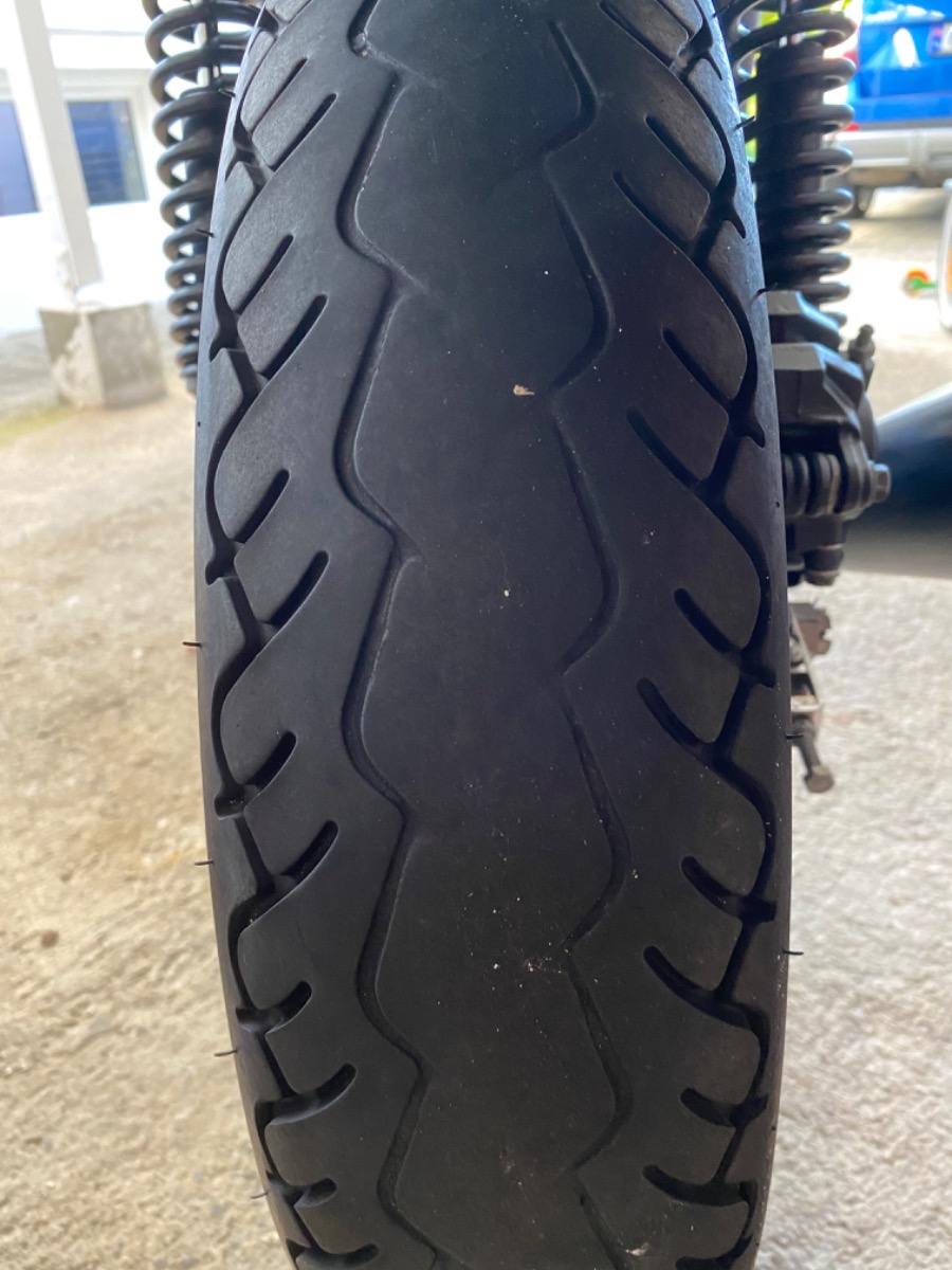

I was thinking replacing the tires in winter time.
how many miles do you think these tire will last and be safe in all condition?
I’m planing a 2,5 days trip… lets say 930 miles….

They have pretty much had it.
I'd fit new ones now.

11 Aug 2022 14:41Whats the date code ? although it doesn't look like it matters from the looks of the tire.They have pretty much had it.

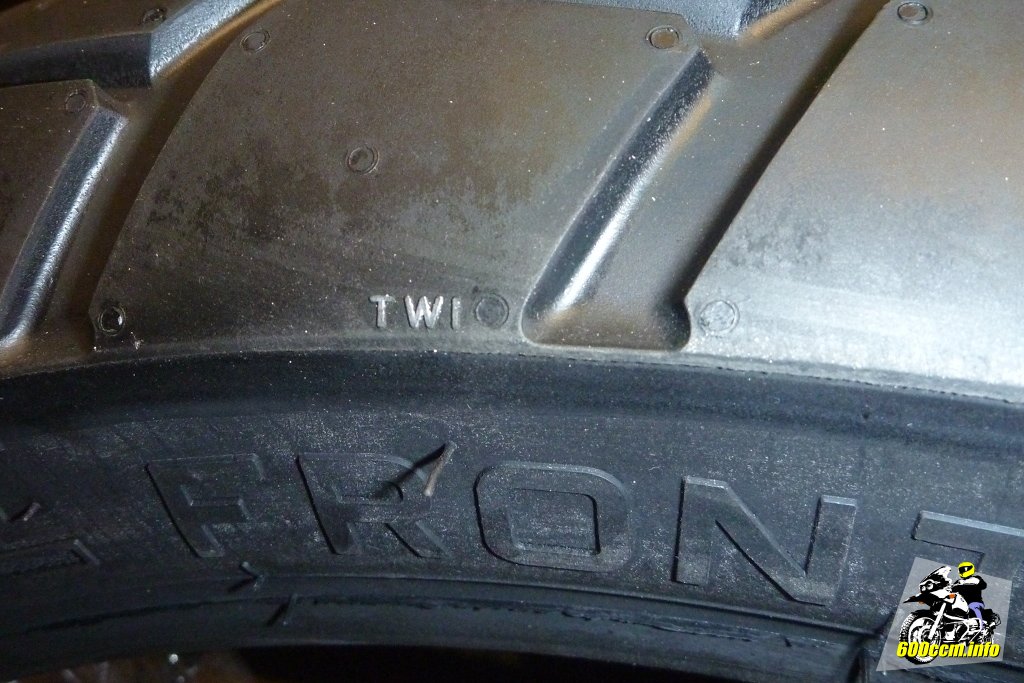

Your rear tire is end of life and needs to be replaced, see the TWI mark (Tire Wear Indicator) . The most wear is in the middle and indicates a lot of highway use.

Centre wear could also be down to over inflation

I agree with the others, this tyre needs replacing.
When you're looking for a replacement, consider going for a dual-compound if you're not already. It looks like you have plenty of highway use with the middle worn but the edges fine, a dual compound will have a firmer compound in the middle for extended life, and a softer compound at the sides to keep cornering grip.
