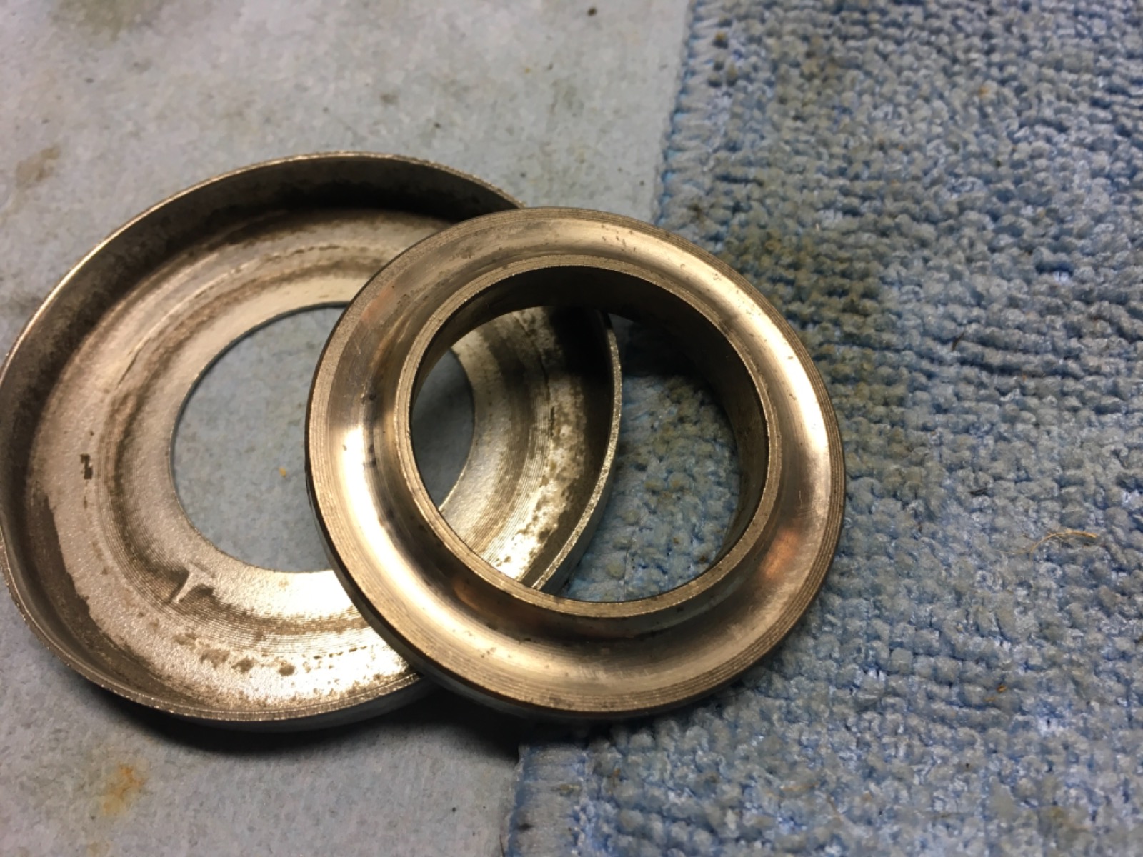

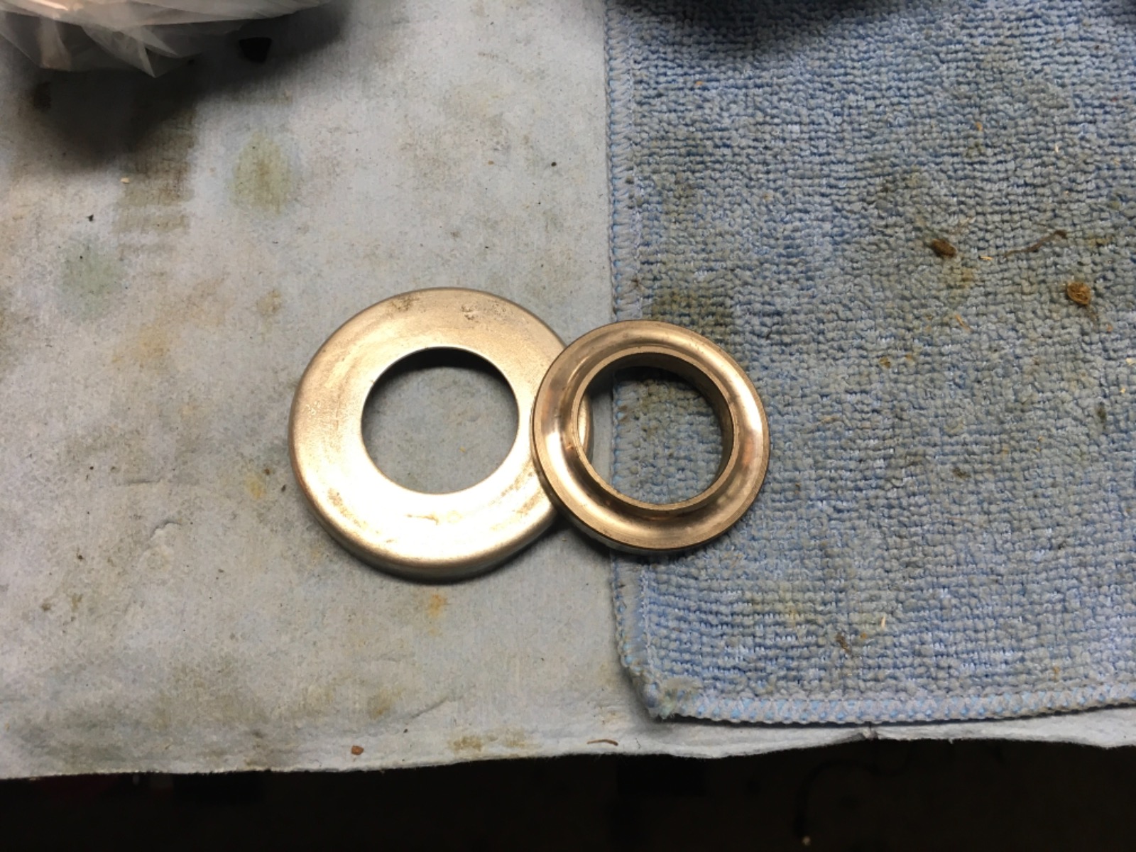

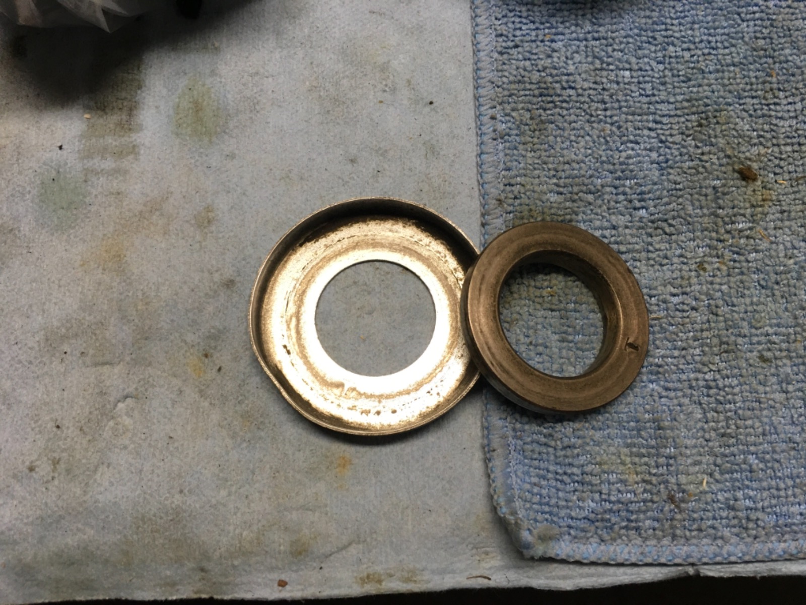

Hi Matt. Might be this oil seal that sits on base of tripie stem before the bottom race gets put on?

Hi Matt, yes I believe those are correct.

@Z1kzonly
I have that seal on the headstock. I also have the ball bearings that are needed.

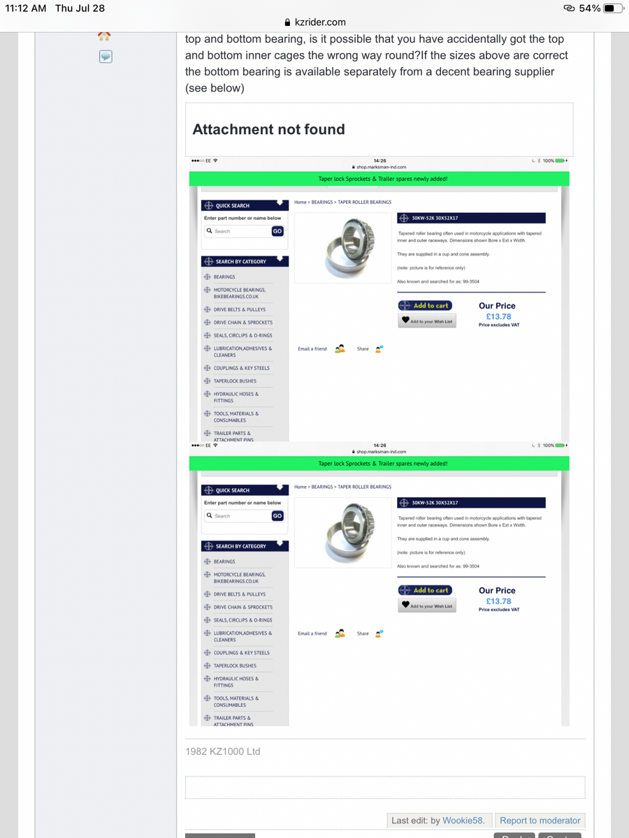

I do not know which year and model you have, but AllBalls Racing have bearings for a 1978 Kz1000B in stock. These are tapered roller bearings which most folks prefer to the old ball bearing setup.
www.allballsracing.com/22-1014.html
It would be easier for folks to offer help if we knew for sure exactly which year and model you have.

Here’s an alternate. You can by your choice of brand. Will have to contact allballs to see if they sell the seals À la cart.
Credit Wookie for finding the following
