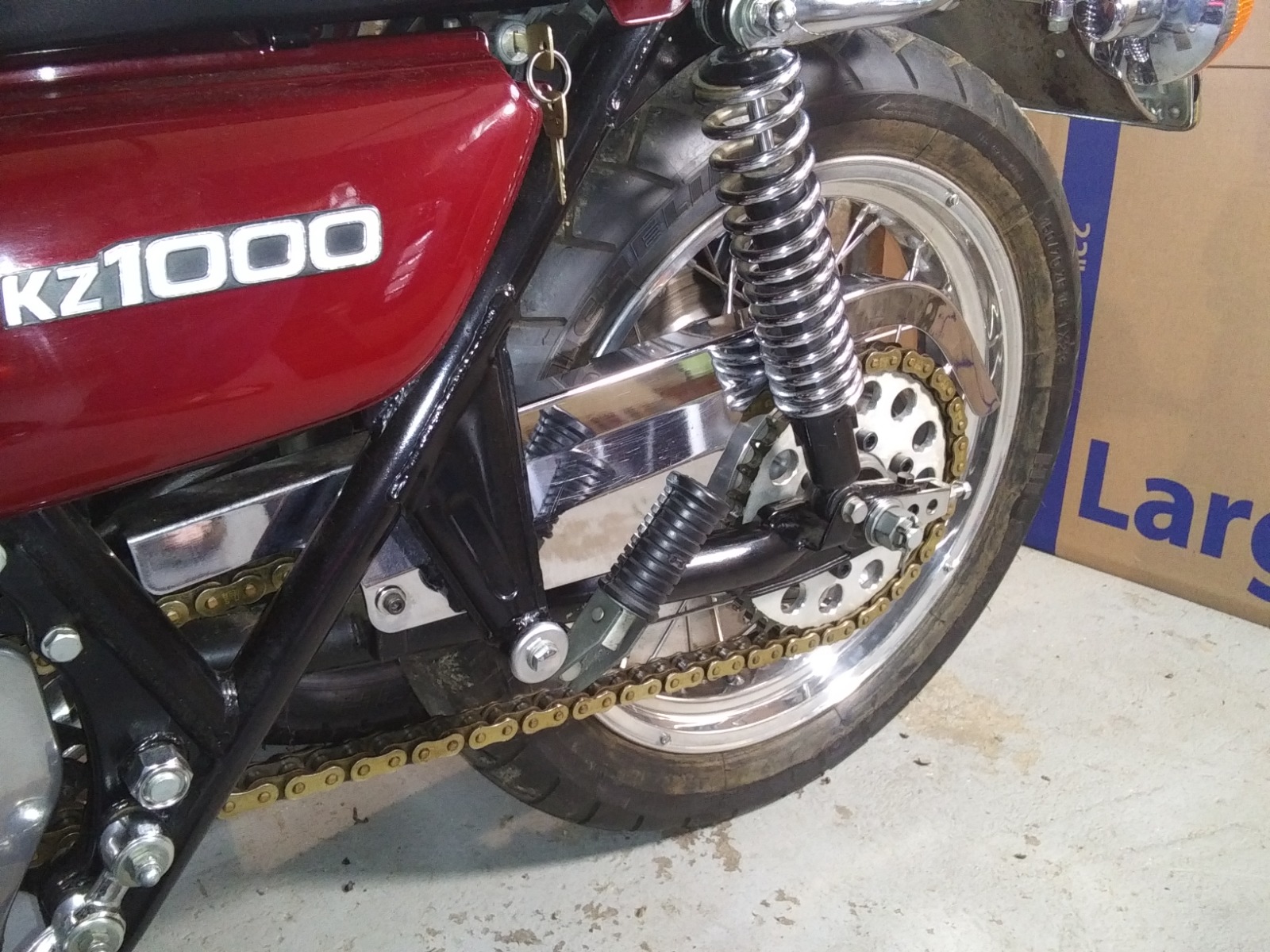

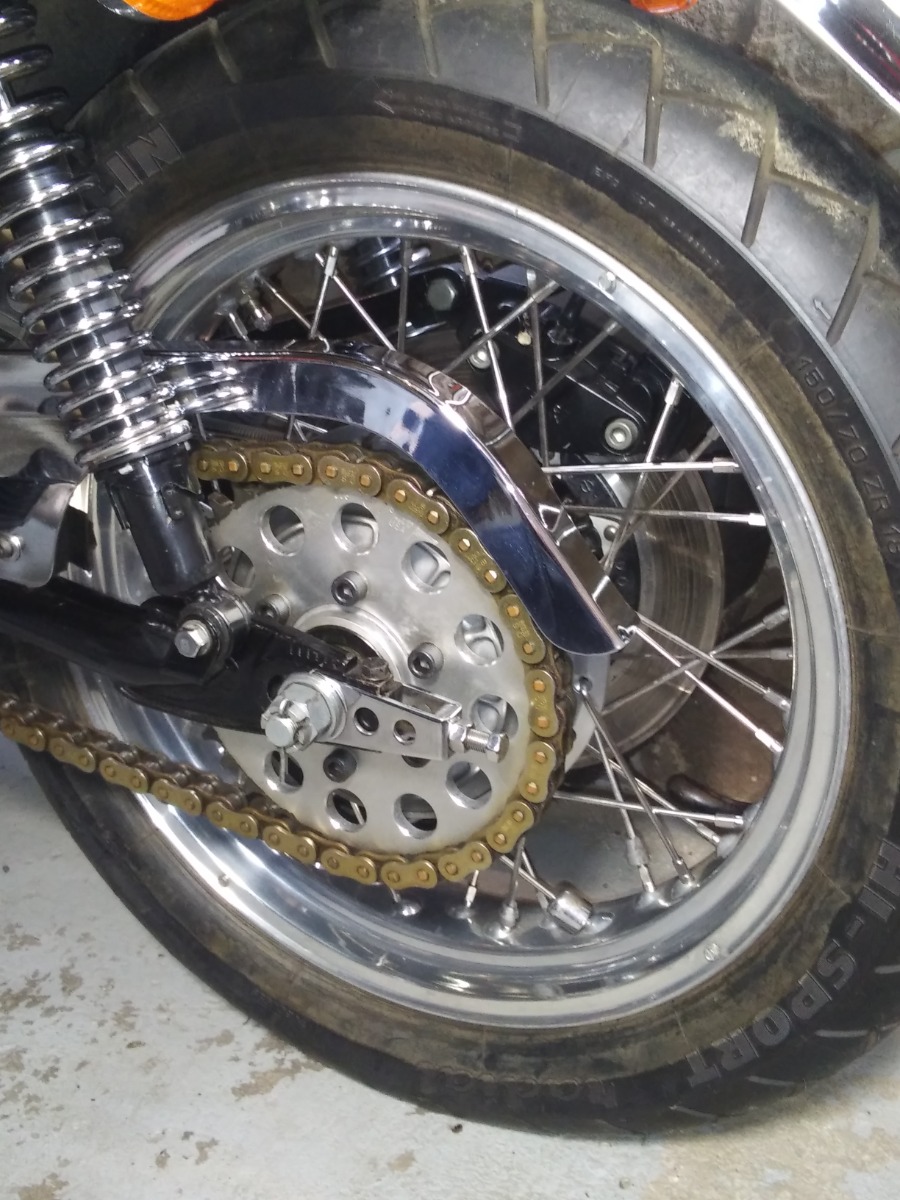

I have a 140 on a 3.5" rim laced to a stock hub, stock swingarm on my Z1b.
