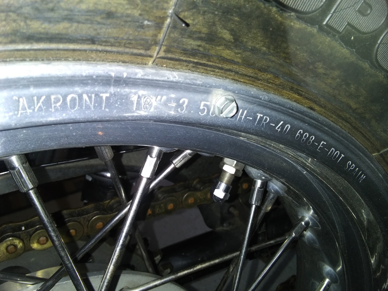

My 77-kz has a 3.5 inch rim laced to the stock hub with a 150/70-ZR 18 tubed tire. The swing arm is stock. I did have to notch the chain guard for fitment.

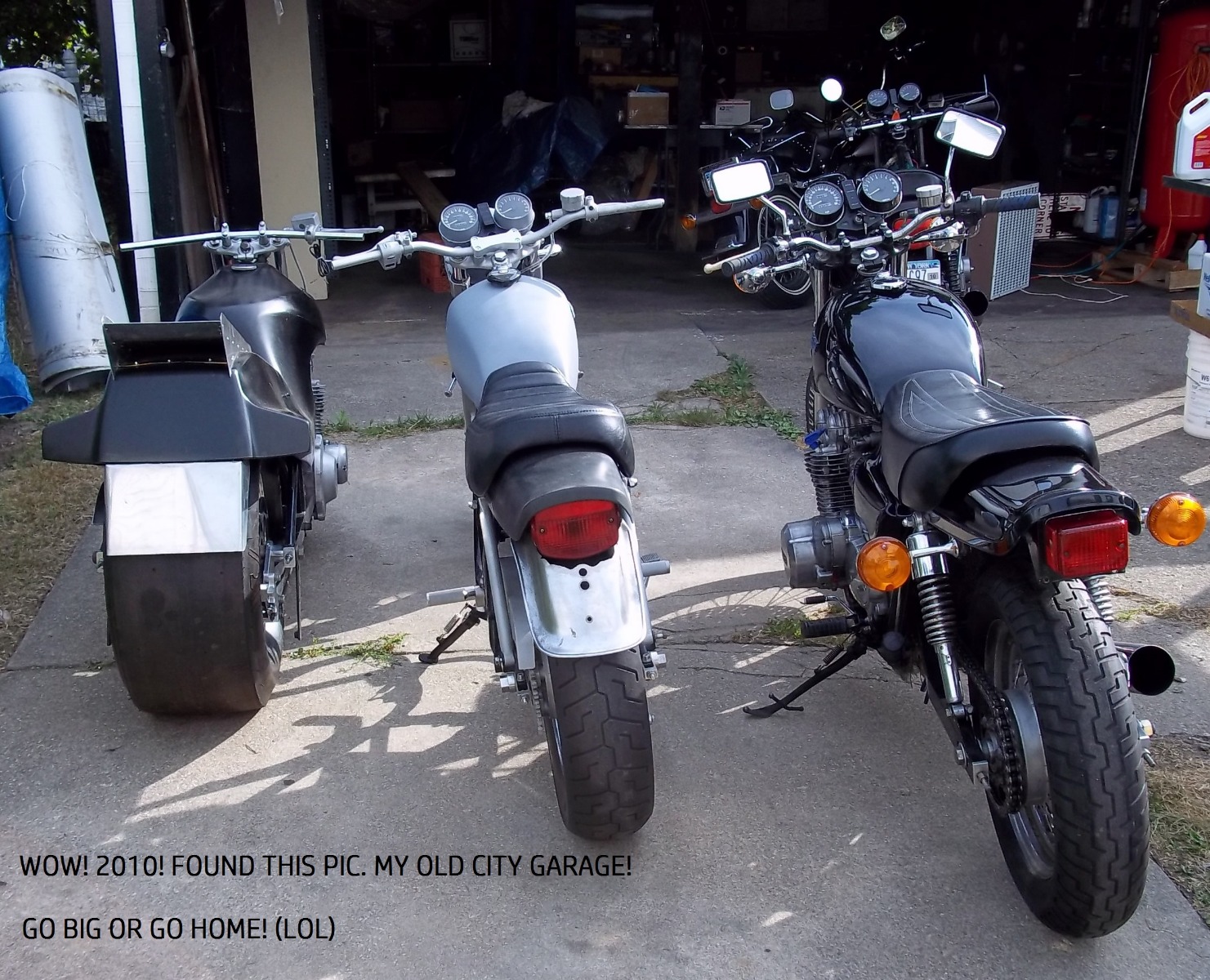

Seeing your extending swingarm. Don't go too long! (It's not a BUSA on cycledrag!) You need a wider rim, just for looks? Make it easy and go with a Suzuki GS 1100 and a 3.5 rim. They show up on ebay from Oink or JJ Copper would have one.Unless you can spoke and true it yourself. Try and find a person to lace and true a spoke rim nowadays!I added 4" to a stock swingarm with a 4" x 16" hog rim with a 150 tire. using 3/8" offset with a 630 chain.Then this bike just sold, GS Szuk had a 3.5 with a 5.5 slick. I shimmed it for a stock front sprocket. Tear it apart! Start building stuff! Then it will sit for 12 years like me!

Plus I put a Harley hubbed parts with 530 chain with a 5.5" x 18" with a 180 tire. couldn't find finished pic, that had a 5/8" plate and offset. And a fiberglass Beasly fender. Sold it to a guy who wanted the shocks kept. I wanted struts. But it was his money.

Back then, (the 80s), I got the Akront rim and spoke kit from Kosman Specialties and had them lace it up also. Never had any problems with clearance or handling. R.I.P to Sandy Kosman who passed away this year. Interesting piece on him here. Good luck on your build.
