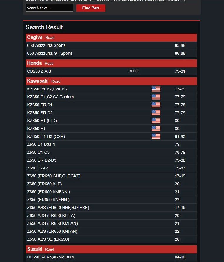

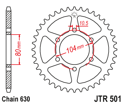

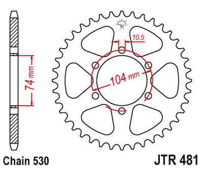

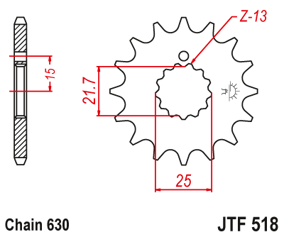

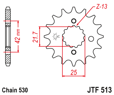

JT Sprockes web side shows the dimensions to every front and rear sproket they made.
www.jtsprockets.com/catalogue/?searchtype=buyers
Pics for the (K)Z650 530/630 chain typ sprockets.
