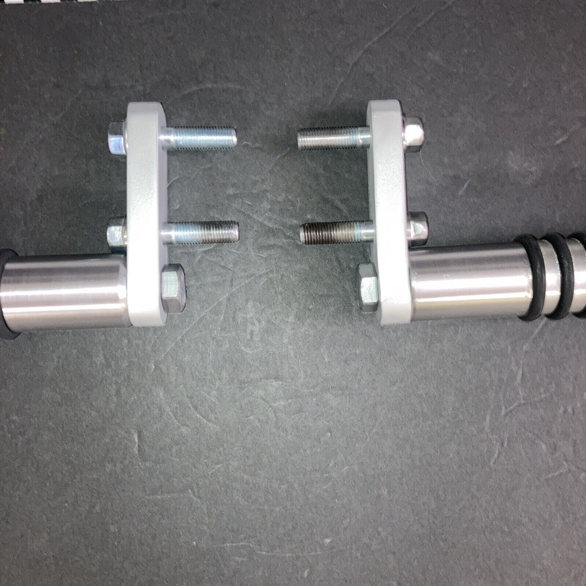

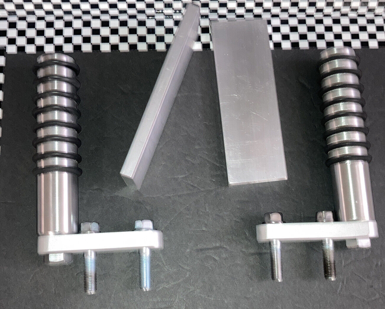

The ebay item id given is invalid, no result has been sentNo eBay APP ID and/or Cert ID defined in Kunena configurationYes a thin jam nut behind. Threads are a 10mm 1.0 fine thread.
A bolt will bolt right in. These are for a Z1/ KZ900 frame.
I have these quick homemade pegs on ebay right now.
