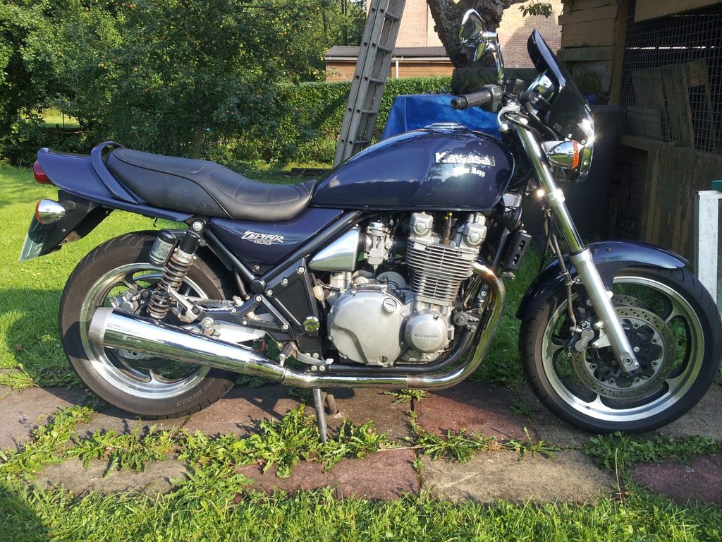

You mentioned euro a few times so i figure you are somewhere in mainland Europe? why not look for a Zr1100 Zephyr? a good looking bike in fact closer to the looks of the Rs than any other bike you have mentioned so far and there are a fair few project bikes in or around germany.
Edit. ah holland, sure you are only a few hours drive away from some of the Zr1100 i was looking at.

Iv always wanted one of these they are getting more and more rare and there are only a handful in Ireland.
