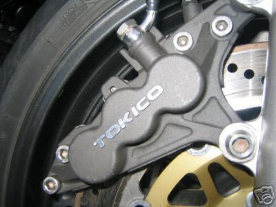

Anybody tried putting a bigger caliper on a 440? These 6 pot Tokico's were used on a lot of different mid-90's bikes...ZRX, Hyabusa, ZX7, etc

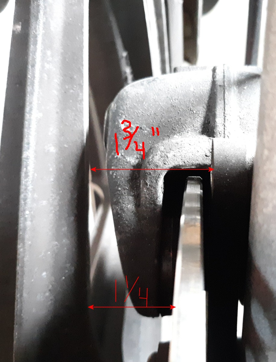

Yeah, the adaptor is expected but I've done that on several bikes.  Technically speaking, the stock caliper isn't sliding pin but it's similarly designed & trying to stuff a traditional opposed piston caliper in where sliding pin calipers live likely nets clearance issues.  I could always use another sliding pin caliper with twin pistons to get more surface area of the pads to increase braking power.  But I prefer to get the most out these things so if I can fit that 6 pot caliper, I will.  There is about 1 3/4" between the back of the mounting boss & the wheel spoke, 1 1/4" from backside of the rotor & spoke.  Ebay is full of 6 pot calipers for dirt cheap...might just pick one up & if the measurements don't work out it's not that much of a loss.
I don't have a measurement for you, but I tried to test fit a ZRX 6-pot on a '78 kz1000 with a cast wheel. The caliper body hit the spokes.
I suspect that you would need to make a spacer to move the disk away from the wheel. There are many examples of these spacers used by other folks on this site when swapping calipers.

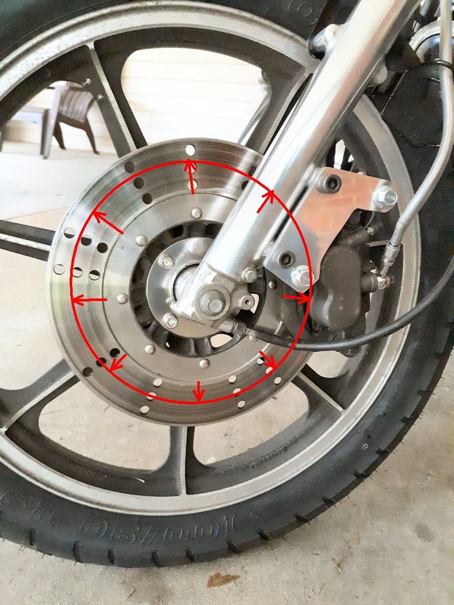

well shoot...not surprised though.  There isn't much space to move the rotor either...rivets only leave maybe 5mm or so before they'd contact the caliper.  No worries though.  Think I read elsewhere that some of the early KZ1000's use the 4 bolt rotor that fit on the 440 wheel.  If I can't get more braking from a caliper, a bigger rotor will work too.

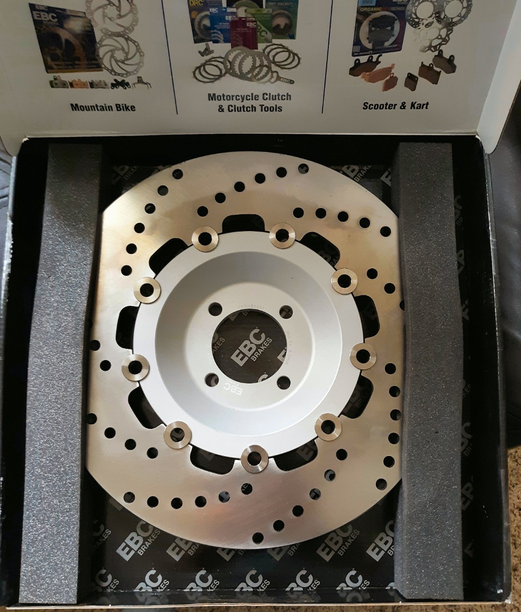

Read somewhere the 4 bolt brake rotor for 79-81 KZ1000 would fit the 440...it doesn't.  Center hole is too small & the bolt spacing is just a couple of mm off.  It's the 295mm front rotor though & I'm wondering if they weren't talking about the rear rotor.  I think the rear rotor is 290mm & I'm not sure I want to go that route.  It's not that much bigger than the 275mm that's on the bike & the braking isn't terrible with the 1/2 inch master & braided brake line.  I've got another caliper I'm going to try out.  Maybe the wider sweep on the pads & the master cylinder/brake line, I'll be content with it.  It's too bad...she was a pretty rotor

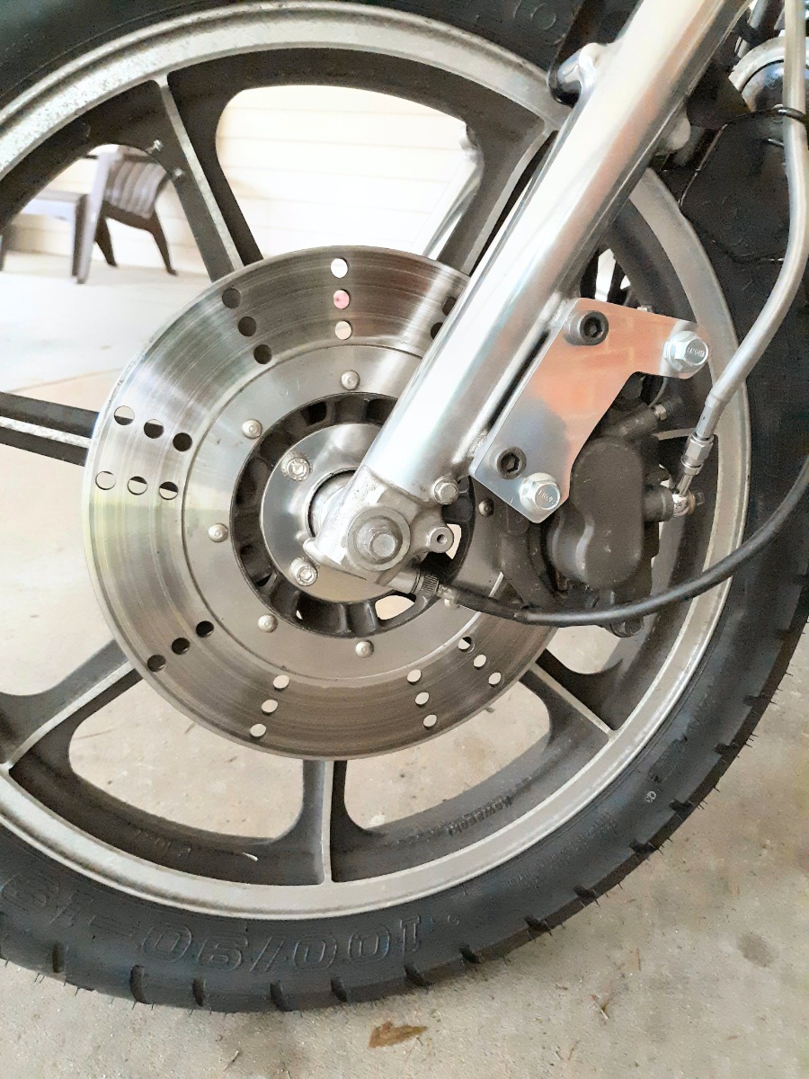

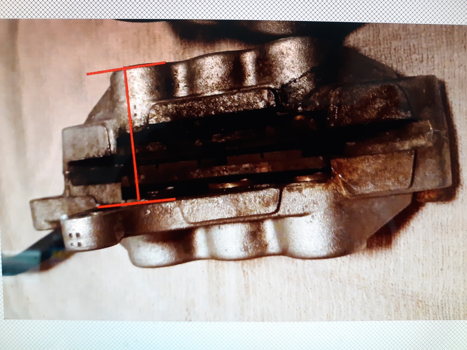

The bigger brake rotor turned out to be a lost cause but a 2 piston caliper has wider pads/more surface area & gives a noticeable effect on braking.  Picked up a caliper for a 2016 Yamaha Bolt, fabricated an adaptor from 3/8" 6061 aluminum plate.  Wish the master cylinder was a 12mm instead of 1/2" but it's better than the stock ratio so I can live with it.

Don´t play stupid games with brakes. Your brake pad to disk surface ratio is a no go !!!
