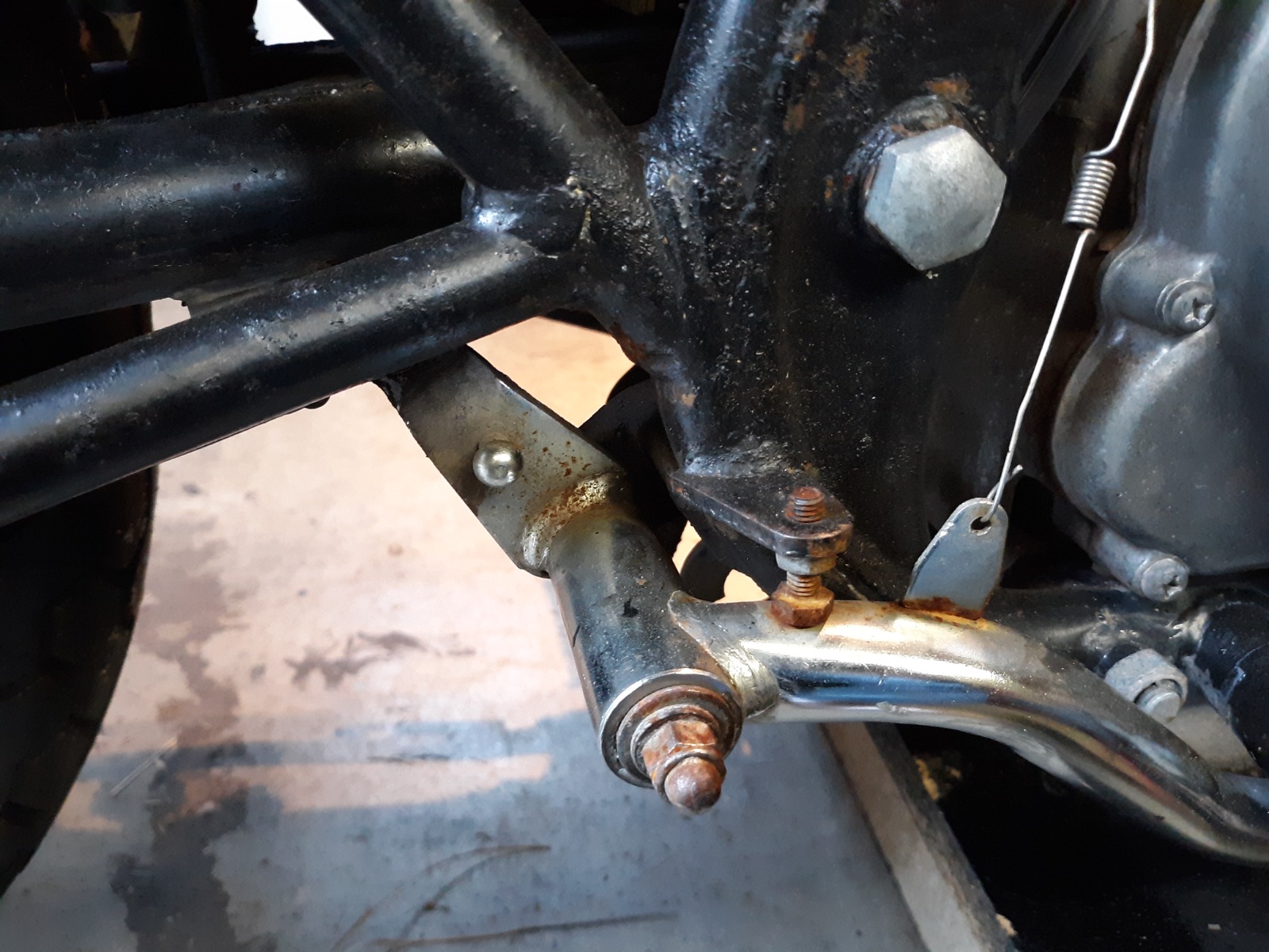

I'm missing the return spring, which doesn't pose as much of a problem as where the spring goes...I see the pin where I'm pretty sure the spring goes on the brake pedal but I cannot figure out where the other attachment point is. Service manual does not show this either. Found an old post here but pics don't show anymore.
EDIT: disregard...think I found it from a blown up shot of the service manual

In the diagrams at Partzilla for the 440 Ltd I'm seeing a pin on the RH muffler. The spring appears to be kind of long & the orientation in the drawing seems to indicate that the spring could attache there. kind of a weird place to attach a spring.

It does hook to the pin on the muffler mounting bracket.
