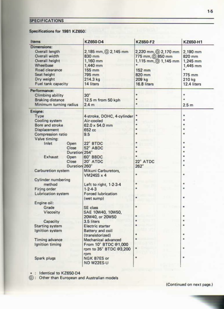

F2 has 16,8l / 4,4 gallon, will it fit the frame and brackets, anybody know?
right now I have 14l / 3.7 gallon.

Thank you, I think can gain 2,8l?

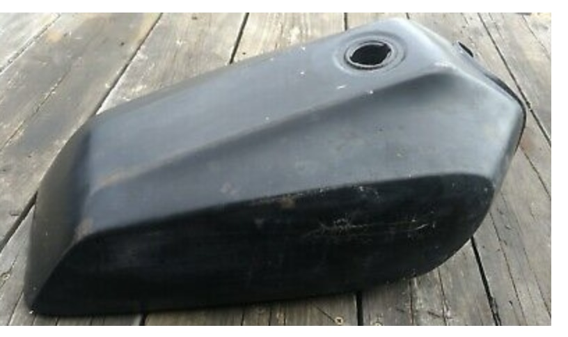

16 Apr 2022 00:39 - 16 Apr 2022 00:40
Project:
Project:
Last edit: 16 Apr 2022 00:40 by gordone.
- gordone
- Posts: 1532
- Thanks: 93
Re: 1981 KZ650-D4 - gas tank?
16 Apr 2022 00:41 - 16 Apr 2022 00:41
Project:
Project:
Last edit: 16 Apr 2022 00:41 by gordone.

16 Apr 2022 12:29You can use a B, C or F model tank, they are the same size.it’s a F tank I must consider then to gain 2,8l?

Do you witch of them is largest when it comes to gas capacity?
Maybe I should stick to what I have…
